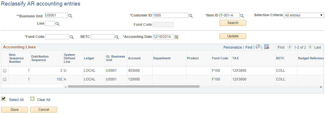

Reclassify AR Accounting Entries Page
Use the Reclassify AR accounting entries page (PAR224_ARENTRIES) to change the fund associated with posted accounting entries.
You can reclassify the entire stream of the transaction. The reclassification entries are recorded in the PS_ITEM_DST table with a sequence number starting from 600. You can also change the BETC and accounting date.
Navigation:
Accounts Receivable, and then Receivables Maintenance, and then Reclassify AR Entries
This example illustrates the fields and controls on the Reclassify AR accounting entries page. You can find definitions for the fields and controls later on this page.
Field or Control Description
Item Search
Click to display the accounting lines that match the entered business unit, item ID, customer ID, fund code, and accounting date.
Selection Criteria
Select the types of entries to display in the Accounting Lines area. the values are All Entries and Reclassification Entries.
Update
Click this button to generate new accounting entries for the selected accounting lines after you have entered the appropriate fund code, BETC, and accounting date.
The system generates reversal entries for the selected accounting lines and creates new accounting entries with the following attributes:
  • The fund code, BETC, and accounting date are changed to the specified values. The system retrieves the TAS based on the fund code. The TAS value defaults in from the TAS_FUND_CD_TBL/TAS_DEFN_TBL.
    The TAS and BETC are required for reclassification transactions. The system verifies the Fund Code and TAS/BETC have been set up before you can update the Fund Code value.
    If you want to change only the BETC on the entries, you must also enter a Fund Code value in the Fund Code update field. This is necessary for the BETC prompt to display the correct values based on the fund code.
  • The distribution sequence number begins at 600.
  • The value in the Distribution Status field changes to N if the value in the selected rows is N or D.
    For distribution status I in the selected rows, the value remains the same.
  • The entry event process status is updated to N.

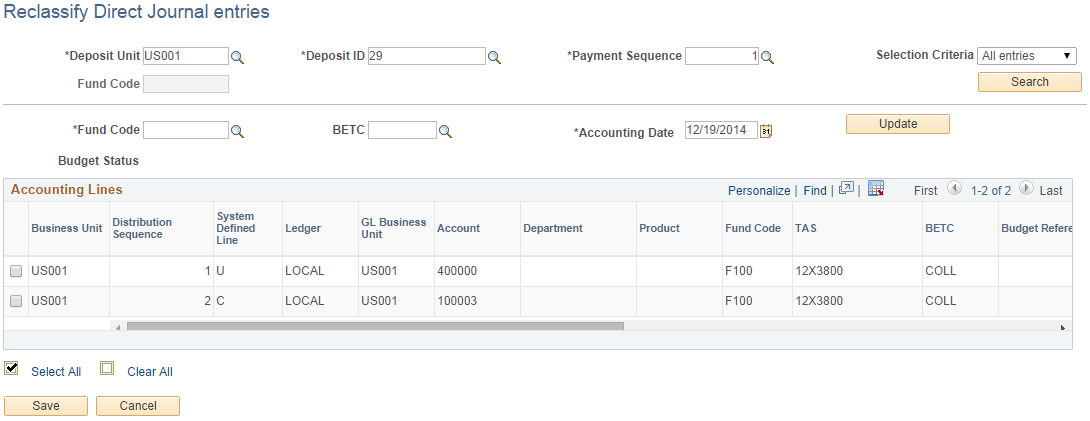

Reclassify Direct Journal Entries Page
Use the Reclassify Direct Journal entries page (PAR224_DIRJRNL) to identify accounting entries for direct journals and reclassify the entries to correct the fund.
The reclassification entries are recorded in the PS_PAY_MISC_DST table with a line number starting from 600. You can also change the BETC and accounting date.
Navigation:
Accounts Receivable, and then Receivables Maintenance, and then Reclassify Direct Jrnl Entries
This example illustrates the fields and controls on the Reclassify Direct Journal entries page. You can find definitions for the fields and controls later on this page.
Search
Click to display the accounting lines that match the entered deposit unit, payment sequence, fund code, and accounting date.
Selection Criteria
Accounting Date
Enter the accounting date to be used on the new reclassification entries. If no date is entered, it will default to the current date. The budget date will be set to the same date as the accounting date.
Update
  • The fund code and accounting date are changed to the specified values. The system retrieves the TAS based on the fund code. The TAS value defaults in from the TAS_FUND_CD_TBL/TAS_DEFN_TBL.
