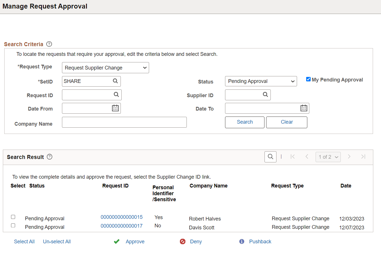

To locate requests that require your approval, enter search criteria and click the Search button.
Initial supplier requests submitted to the Editor/Approver will not generate any search results with Status as “Pending Editor Review”. Search results will display with Status as “Pending Editor Review” when the requests has been sent back to the Requestor by the Approver or Editor.

Request ID
Click the request ID value on the Manage Request Approval search page to review registration details and review approvers.
When you click a request ID value from the search results, a detailed change request approval page displays for that change request.

Pushback
Allows approvers to send back one step in the approval flow process to the approver who last approved the change request. This option is only available for second or subsequent approvers in a multiple approval workflow path.

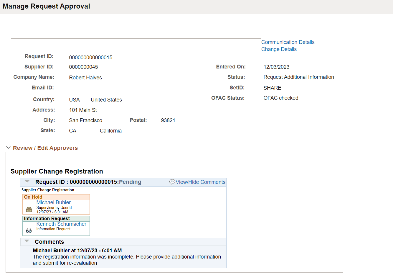

Request More Information
Allows approvers to send an email notification to the original request-submitter requesting for additional information. This notification includes a link with the change request ID. The requester who submitted the original request may then provide the requested information either by clicking the link in the email or by navigating to the history page to search for and select the pending change request.
Note: When the Supplier Request System Setup has been configured to allow modifications by Editor for registration requests, the Request More Information button sends the request goes back to the Editor, and not the requester.
Approve
Allows approvers to approve a change request. If the change request is approved, the master update status of the draft record is set to Approved, and the supplier records are updated. The submitter is then notified of the approval.
Note: If the change request contains personal identifier or sensitive information and the approver tries to approve it without reviewing the information on the Review page, the pop-up message appears again to alert the approver. This pop-up message is only to alert the approver. It will not stop the approver from approving the Change Request. For mass approval, if the change request contains personal identifier or sensitive information, the Approve link will be disabled when the approver selects the checkbox.
Deny
Allows approvers to deny a change request. If the change request is denied, the draft record approval status is updated and the process terminated. The submitter is notified of the denial.

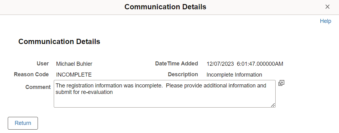

Depending on the set up in the supplier request system, an approver may be required to provide a reason code and comments when either requesting additional information or when denying a request.
Whenever there is reason code information present while there is communication with a requester, the Communication Details link displays on the Manage Request Approval details page. All reason codes and comments are included in the Communication Details, including those entered upon initial submission of the change request. If reason codes have not been used, the Communication Details link will not be displayed in the Manage Request Approval details page.
This example illustrates the fields and controls on the Communication Details Page.

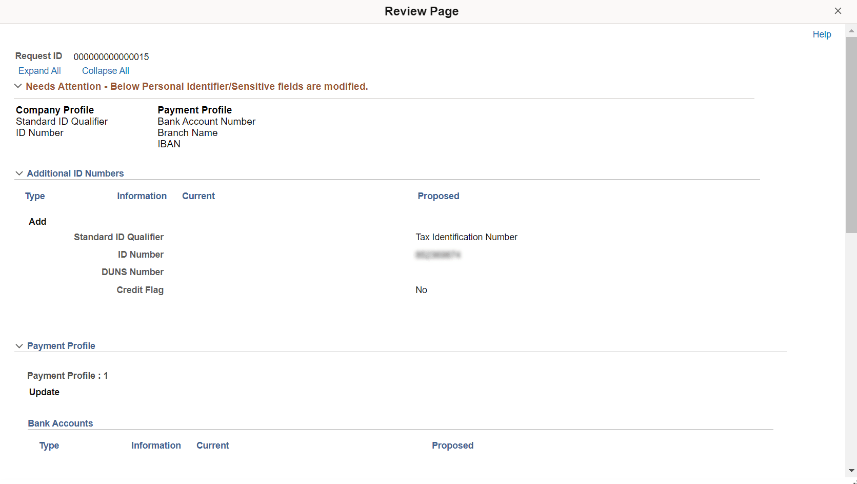

Change Request Review Page

Needs Attention - Below Personal Identifier/Sensitive fields are modified section displays the Change Request train stop and associated field names where personal identifier or sensitive information is available. Approver can review these field details on this page. This section only appears if personal identifier or sensitive information fields are available in the Change Request.
