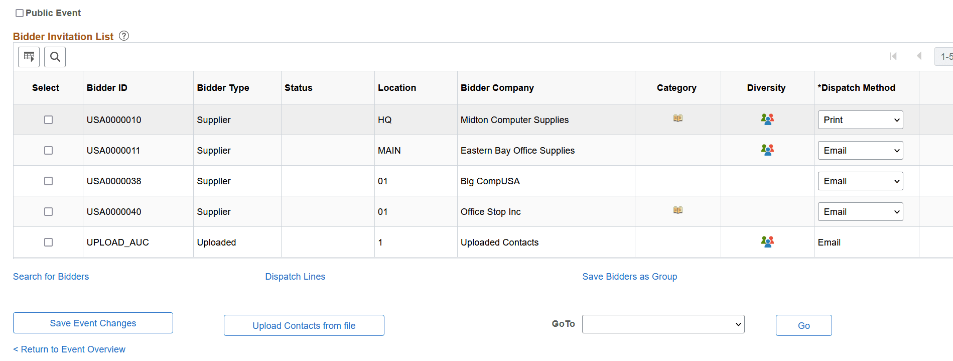

Invite Bidders Page
Use the Invite Bidders page (AUC_DISPATCH_PG) to announce an event and solicit bids from registered bidders, suppliers, or customers.
Specify that bidders place bids on certain line items only. Invite bidders who are not currently suppliers or customers.
Navigation:
Sourcing, and then Create Events, and then Create Event Details, and then Select Bidder Invitations link
This example illustrates the fields and controls on the Invite Bidders page (1 of 2). You can find definitions for the fields and controls later on this page.
Invite Bidders page
This example illustrates the fields and controls on the Invite Bidders page (2 of 2). You can find definitions for the fields and controls later on this page.

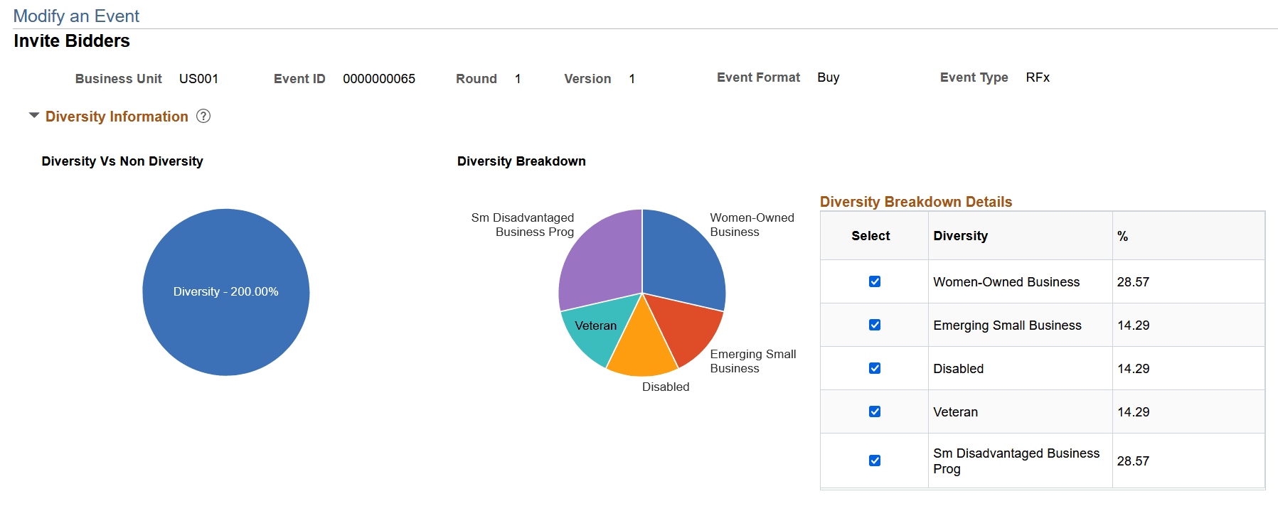

Diversity Information
Displays diversity information for the selected bidders in form of pie charts. The first pie chart displays the diversity versus non diversity percentage, while the second pie chart provides a breakdown of the percentage distribution amongst various diverse sections. Based on the selected diversity fields, the Diversity Breakdown pie chart will display the respective sections. Each Diversity is represented by an unique color in the pie chart and by hovering over on any section of the pie chart, corresponding details of the Diversity can be viewed.
Status
Status indicates whether the supplier is approved or not. This field is applicable only to bidder type, Supplier.
Category
Displays the category details that is associated with the bidder ID. Bidders are displayed based on the categorization tree that the bidder is associated with.
Diversity icon (Diversity icon)
Click Diversity icon to view the selected diversity details for the respective bidder ID.
Public Event
Select to make the event available to any interested party. For all events, bidders must be registered to bid.
When you select Public Event, a bidder called PUBLIC_AUC appears on the bidder list. You can use the PUBLIC_AUC bidder to invite unregistered bidders. Click the Contact Details button and enter the names and the email addresses of the people to invite.
Dispatch Method
Select to determine the dispatch method for sending an invitation. Options are Email, Fax, and Printed Document. This method appears by default from the business unit setting.
Contact Details icon (Contact Details icon)
Click the Contact Details icon to view or update contact information about the invited bidders.
Search for Bidders
Click to access a sortable list of bidders to use for sending invitations.
Dispatch Lines
By default, bidders are invited to bid on all line items. Click to specify that a bidder is invited to bid on certain line items only.
Save Bidders as Group
Click this link if you want to save the bidders for this event as a group. The system accesses the Bidder Group Details page, where you can enter bidder group information.
See Bidder Group Details Page.
Upload Contacts from File
Select to access the File Attachment page and upload bidder contact information from a comma-separated values (CSV) file.
Note: The CSV file should consist of only two columns-one for contact name and another for email address. Do not include a header or label row.
After you upload the file, a new row is created in the Bidder Invitation List with UPLOAD_AUC for the Bidder ID. You can select the Details icon to access the Upload Event Contacts page and review data uploaded from the CSV file.
Invitations are sent to the email addresses contained in the CSV file.
Renotify
Click to resend event notices and updates to selected suppliers.

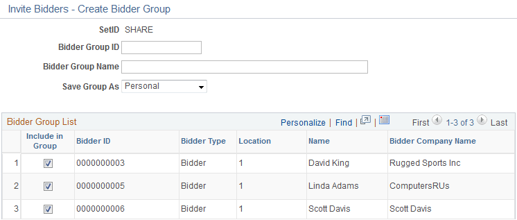

Use the Bidder Group Details page (BIDDER_GROUP) to save the list of invited bidders as a group that can be used to invite to subsequent events.
Navigation:
Click the Save Bidders as Group link on the Invite Bidders page.
This example illustrates the fields and controls on the Bidder Group Details page. You can find definitions for the fields and controls later on this page.
To add a bidder group:
  1. Enter the name in the Bidder Group ID field.
  2. Enter the group name in the Bidder Group Name field.
  3. In the Save Group As field, select Department or Personal.
    If you select Department, the department number and name appears. Users who are associated with the specified department will have access to the bidder group. If you select Personal, the bidder group is available only to the specific individual who created it.

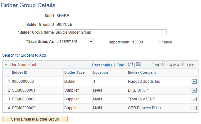

Use the Bidder Group Details page (BIDDER_GROUP) to modify bidder groups.
This example illustrates the fields and controls on the Bidder Group Details - Bidder Group Setup page. You can find definitions for the fields and controls later on this page.
Field or Control Description
Send Email to Bidder Group
Click this button to create and send an email notification to members of an existing bidder group outside of a specific event.
On the Email Notification page, only bidder contacts with valid email addresses will be included in the Send To line.

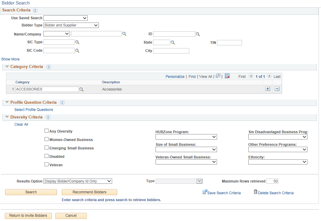

Bidder Search Page
Use the Bidder Search page (AUC_BIDDER_SRCH_M) to add bidders to bidder groups.
Navigation:
Click the Search for Bidders to Add link on the Bidder Group Details page.
This example illustrates the fields and controls on the Bidder Search page (1 of 2). You can find definitions for the fields and controls later on this page.
This example illustrates the fields and controls on the Bidder Search page (2 of 2). You can find definitions for the fields and controls later on this page.
Use Saved Search
Select a previously saved search.
Bidder Type
Select a value to search for bidder or supplier contacts or bidder groups. Bidder groups may contain any combination and number of bidders, suppliers, and customers.
The default value is Bidder and Supplier. Use the Bidder and Supplier option if you want to perform a single search for both bidders and suppliers.
Name/Company
Select a supplier name or a bidding company name.
ID
Select an Bidder or Supplier ID number.
SIC Type
Select an SIC type.
State
Select a state of the bidder or supplier.
TIN
Select the Taxpayer Identification Number (TIN) type for the bidder or supplier.
SIC Code
Select required SIC Code.
City
Enter the bidder’s or supplier’s city.
Show More / Show Less
Select to expand and collapse additional fields.
Contact
Enter the contact name of the bidder company you would like to invite. If you search by the company name, the default contact appears in the search results. Only the invited contact for a bidder company has access to view the event, place bids, and view bidding activity.
Group ID
Select to search for a bidder group by group ID.
This field works with the Bidder Type field. If you select a bidder type of Supplier, then the system returns supplier quote groups. To search for a bidder group, you must select a bidder type of Bidder.
Group Name
Select to search for a bidder group by group name.
This prompt works with the Bidder Type field. If you select a bidder type of Supplier, then the system returns supplier quote groups. To search for a bidder group, you must select a bidder type of Bidder.
Type
Select a supplier type specific to a supplier. This field displays only if you select Bidder and Supplier or Supplier as the Bidder Type.
Item ID
Select a supplier item specific to a supplier. This field displays only if you select Bidder and Supplier or Supplier as the Bidder Type.
Include Not Open For Ordering
Select this check box if you want to display suppliers in the search results who are not open for ordering.
Category Criteria
Displays Category criteria, which is one of the search criteria for bidder search.
Category
Select suitable category from the prompt. Bidders will be searched based on the associated categorization tree.
Profile Question Criteria
Displays the profile questions selected on the Select Profile Question page.
Use the profile questions search fields to filter required bidders and suppliers based on their answers entered during supplier registration.
Select Profile question
Select to add profile questions from the Select Profile Question page. The Select Profile Question page displays profile questions from the PeopleSoft Source to Settle Common Information: Profile Questions Page which were marked for inclusion on the Bidder Search page.
Diversity Criteria
Select criteria to search for bidders based on Diversity. Criteria include:
  • Any Diversity
  • Women-Owned Business
  • Emerging Small Business
  • Disabled
  • Veteran
  • HUBZone Program
  • Size of Small Business
  • Veteran-Owned Small Business
  • Sm Disadvantaged Business Prog (small disadvantaged business program)
  • Other Preference Programs
  • Ethnicity
Note: On selecting Any Diversity criterion, all other diversity criteria are disabled, as all diversity criteria will be included in the search.
Results Option
Select from the drop-down list to modify the search results. Options include:
  • Display Bidder/Company Id Only: This is the default option. Select to show the bidder or company ID. The invitation is sent to the primary contact for a company with multiple contacts.
    If you select all bidder types (Bidder Type field is blank) and click the Recommend Bidders button, the results option defaults to Display Bidder/Company Id Only and the other options are not available.
  • Display All Contacts: This option returns all individual contacts in the search results.
  • Display Contacts Of Type: This option is available only with the Supplier bidder type selected. Select a contact type in the Type drop-down menu.

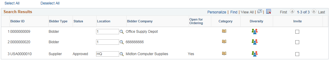

Search
Select to retrieve the rows of information.
The Search Results grid displays rows that includes both bidders and suppliers. For suppliers who are not open for ordering, the result rows include both Yes and No values to identify which are open and not.
The Selected Bidders grid displays the rows of invited bidders and suppliers. Select the Invite check box for each bidder or supplier that you want to invite to the event.
