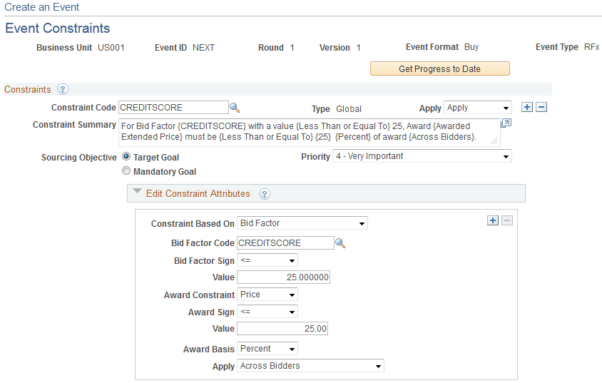

Event Constraints Page
Use the Event Constraints page (AUC_CONSTRAINTS_PG) to view or add constraints assigned at the event level.
Navigation:
Click the Event Constraints link on the Event Summary page.
This example illustrates the fields and controls on the Event Constraints page. You can find definitions for the fields and controls later on this page.
Field or Control Description
Get Progress to Date
Click to have the system retrieve the progress to date of meeting the constraint.
Constraints
Constraint Code
Select from a predefined list of constraints or create an ad hoc, event-specific constraint by entering a unique constraint code
Apply
Select Apply or Ignore. If you select Ignore, the constraint will not be considered by the optimization engine when determining an ideal award allocation. It will also not be edited against when an award is posted.
Constraint Summary
View a description of the constraint. This field is display-only.
Sourcing Objective
Select a value to indicate whether the constraint must be met or is a targeted objective:
  • Target Goal
  • Mandatory Goal: If you select Mandatory, the priority is automatically set to Critical.
Priority
Select a priority for the constraint. Higher-priority constraints are met before lower-level objectives if optimization is used to determine an award.
Edit Constraint Attributes
You can edit any constraints that have been added to the event.
Constraint Based On
Select a value upon which the constraint should be based:
  • Awarded Amount
  • Awarded Bidders
  • Awarded Quantity
  • Bid Factor
Award Constraint
This field is available only if the Constraint Based On field is set to Bid Factor. Select a value to indicate the basis of the constraint used during the award process:
  • Price: The constraint applies to the extended price of the award for all lines in the event.
  • Quantity: The constraint applies to the awarded quantity for the entire event.
Award Basis
Select a value to indicate the basis for the award:
  • Amount: Constraint will be based on a specified dollar amount or quantity.
  • Percent: Constraint will be based on a percent of the quantity or amount awarded.
Constraint Based on Values
This table lists the different fields that are available in the Edit Constraint Attributes group box based upon the constraint based-on value.
Constraint Based-On Value Available Fields
Awarded Amount: Indicates that the constraint is based on the amount awarded for the event per bidder.
Award Sign
Value
Award Basis
Apply
Awarded Bidders: Indicates that the number of bidders must be awarded for the event.
Award Sign
Value
Awarded Quantity: Indicates that the constraint is based on the quantity awarded for the event. You should use this option only for line-level constraints, not event-level constraints.
Award Sign
Value
Award Basis
Apply
Bid Factor: Indicates that the constraint will be associated with a bid factor.
Bid Factor Code
Bid Factor Sign
Award Constraint
Award Sign
Value
Award Basis
Apply
Expression

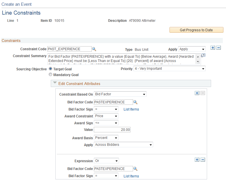

Line Constraints Page
Use the Line Constraints page (AUC_LN_CONST_SEC) to add or view constraints at the line level.
Navigation:
Click theLine Items link on the Event Summary page.
Click the Yes or No link in the Constraints column on the Line Items: Advanced Definition page.
This example illustrates the fields and controls on the Line Constraints page. You can find definitions for the fields and controls later on this page.
Add any constraints at the line level.
See Event Constraints Page.
