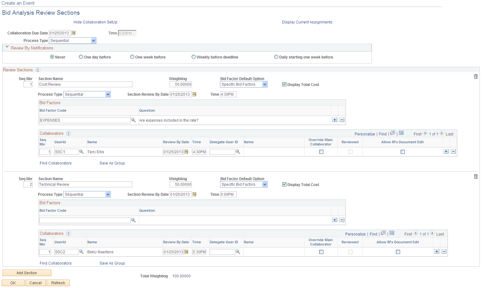

Bid Analysis Review Sections Page
Use the Bid Analysis Review Sections page (AUC_EVENT_COLLAB) to set up bid review sections, weightings, reviewers, and also review groups.
Navigation:
Sourcing, and then Create Events, and then Event Details, and then Event Summary
Click the Bid Analysis Review Sections link on the Event Summary page.
This example illustrates the fields and controls on the Bid Analysis Review Sections page. You can find definitions for the fields and controls later on this page.
Field or Control Description
Show Collaboration Setup or Hide Collaboration Setup
Click the links to display or hide the Collaboration Due Date and Time fields, as well as the Process Type field.
Enter the date and time by which collaboration should be completed. Collaboration must be complete before event preview.
Process Type
Select from the following options:
  • Sequential
  • Parallel
Each Bid Analysis Review Sections page shows overall and section-level collaboration process type settings for sequential or parallel collaboration and collaboration review due date fields.
The process type per section allows the reviewers assigned to the review group to collaborate either sequentially or in parallel.

Review Sections
Seq Nbr
Displays the sequence number of bid factors.
Section Name
Enter the review section name, for example, Cost Review or Technical Review.
Weighting
Enter the weighting for this review section.
Bid Factor Default Option
Choose an option for defaulting Review Section definitions onto bid factors added to an event at both line and header levels. Select one of the following values from the Bid Factor Default Option list:
  • All Bid Factors: The review section will be defaulted onto every bid factor added on either an event line or overall header.
  • None: No defaulting. The review section will always be manually added onto desired bid factors.
  • Specific Bid Factors: The review section will be defaulted onto bid factor codes selected by the event creator.
Display Total Cost
Select this check box to display total cost. This field is available for RFx events only.
Bid FactorCode and Question
Enter a bid factor code from previously defined codes. The associated question displays in the Question field.
User ID and Name
Enter the user ID of the collaborator. The associated name displays in the Name field.
Override Main Collaborator
Select this check box to enable a collaborator to override the main collaborator.
Reviewed
Unavailable during collaboration setup. Updated automatically after a collaborator completes and routes their review.
Allow RFx Document Edit
Select to indicate that the collaborator can edit the RFx document.
Find Collaborators
Click this link to search for and select collaborators.
Save As Group
Click this link to access the Save As Group page (AUC_COLLAB_GRPSAVE), where you can save the list of selected collaborators into a group.

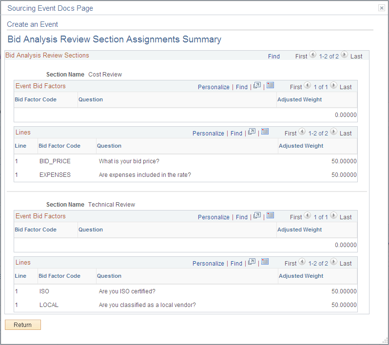

Bid Analysis Review Section Assignments Summary Page
Use the Bid Analysis Review Section Assignments Summary page (AUC_SPLIT_SUM_SEC) to display a summarized view of all Bid Analysis Review Section assignments.
This page is populated upon routing for review and is display-only.

This example illustrates the fields and controls on the Bid Analysis Review Section Assignments Summary page.
