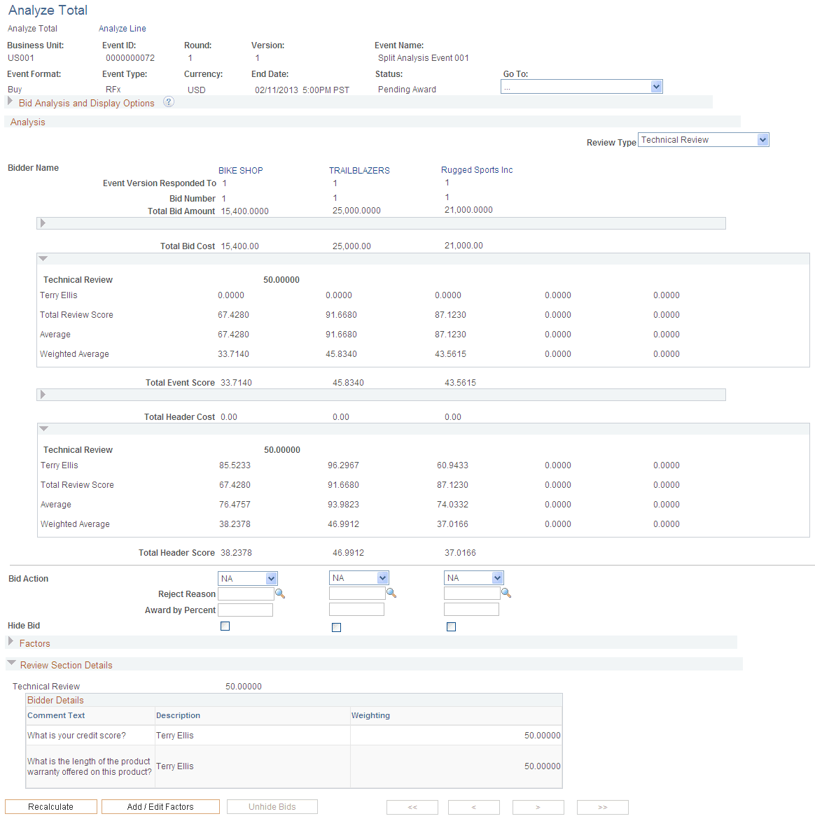

Analyze Total page, pending award after split analysis collaboration

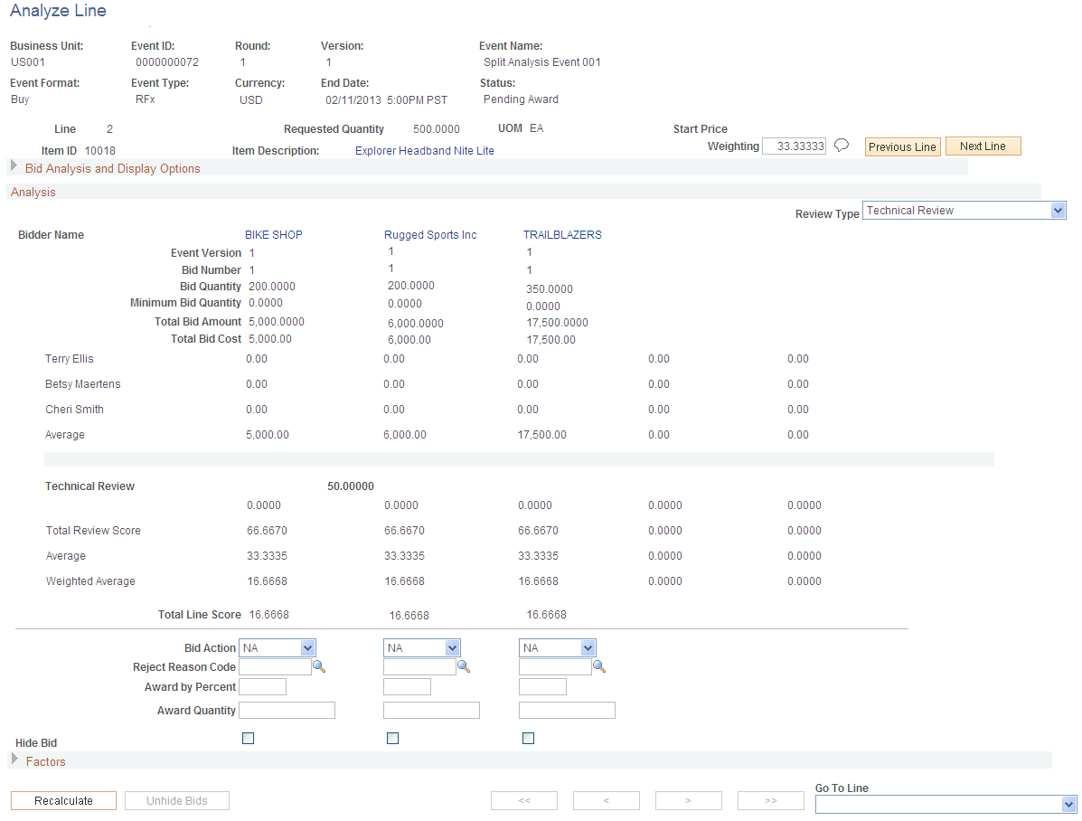

Analyze Line page, pending award after split analysis collaboration
