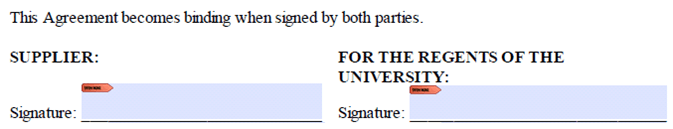

Enabling Usage Rights for Adobe Reader
These steps describe what a document administrator needs to do with a prepared Adobe PDF so that a signer can use Adobe Reader to electronically sign a prepared contract document. The signature fields with underscores need to be converted to digital signatures fields so that signers can sign the document. After a contract document is prepared for Adobe digital signature, the contract administrator needs to do the following:
After a PDF is created for digital signatures, the document administrator who has to extend usage rights to Adobe Reader users to sign document needs to run an extra step in Adobe Acrobat to convert the signature underline fields to Adobe signature fields that can be signed

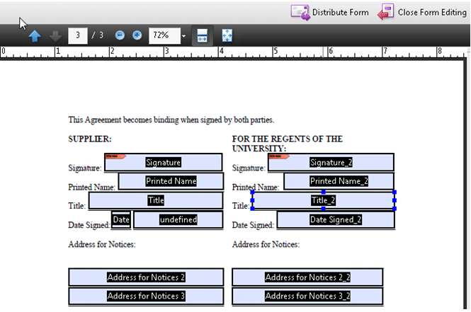

  1. In Adobe Acrobat, select Advanced, and then Accessibility, and then Run Form Field Recognition.
    Acrobat will convert all underscores that have the word signature in them
  2. Delete any form fields that do not require user input by clicking inside the field.
    This example illustrates the Run Form Field Recognition page in Adobe Acrobat.
    Run Form Field Recognition window
    In the example page shot, you would highlight Title 2 and click the Delete button.
  3. The contract administrator can edit the properties for each signature field to add a name and title, and add additional signature fields with hidden signatures. To do this, position the cursor inside the signature field, right-click, and select Properties.
  4. When editing is complete, click the Close Form Editing button (top/right).
    Adobe displays the signature fields that will appear in the PDF:
    This example illustrates Adobe Signature fields.
    Adobe Signature Fields
  5. (Optional) the document administrator can certify documents prior to sending the contract for additional signatures.
    In Adobe Acrobat, select Advanced, and then Sign and Certify (visible or invisible signature).
  6. Extend usage rights for users to use Adobe Reader to view and sign PDFs.
    In adobe Acrobat, select Advanced, and then Extend Features in Adobe Reader.
    The PDF is now ready to be routed for digital signatures.

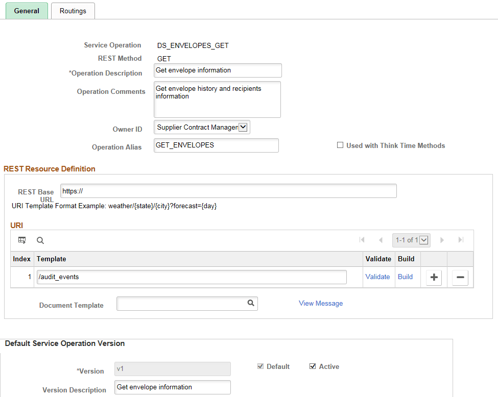

Service Operation
Enter the name of the service operation to view, or click the Lookup button to search for and select an operation.
The following service operations are available for DocuSign:
  • DS_ENVELOPES_GET
  • DS_ENVELOPES_POST
  • DS_ENVELOPES_PUT
  • DS_LOGIN_GET
  • DS_OAUTHTOKEN_POST
  • DS_OAUTH_GET
The following service operations need to be activated to use with Adobe Sign:
  • AS_AGREEMENT_DELETE
  • AS_AGREEMENT_GET
  • AS_AGREEMENT_PUT
  • AS_AGREEMENT_POST
  • AS_BASEURIS_GET
  • AS_OAUTHTOKEN_POST
  • AS_UPLOADFILE_POST
  • AS_USER_GET
Active
Select to activate the service operation.

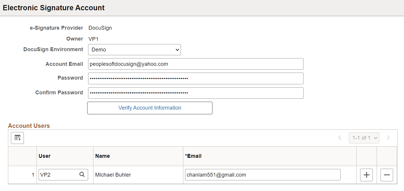

Electronic Signature Account Page
Use the Electronic Signature Account page (CS_ESIGN_SETUP) to specify DocuSign account information.
Oracle PeopleSoft has migrated from SOAP APIs to Adobe Sign REST APIs to manage documents for signing. Users need to review updates from Adobe Sign on deprecation of SOAP APIs. The set up page has been replaced with Configure OAuth page to configure authorization details for Adobe Sign.
Navigation:
Supplier Contracts , and then Supplier Contracts Setup , and then Electronic Signature Setup
Electronic Signature Account page for DocuSign (1 of 2)
Electronic Signature Account page for DocuSign (2 of 2)
Use the DocuSign Environment option to indicate whether the DocuSign account is used with your test or production environment. Options are Demo and Production. When you select the Demo option, documents you create will have a watermark stamped on them to indicate they are used for testing.
Enter the account information for the DocuSign user and click the Verify Account Information button to authenticate account information.
Use the Account Users group box to specify users added to the DocuSign account.
You are not adding users here; users are added in the DocuSign account.
Use the Signing Groups group box to view signing groups associated with the DocuSign account. Select the Group Members link to access the Signing Group Users page and view individual users associated with the signing group. Signing groups are defined in the DocuSign application.

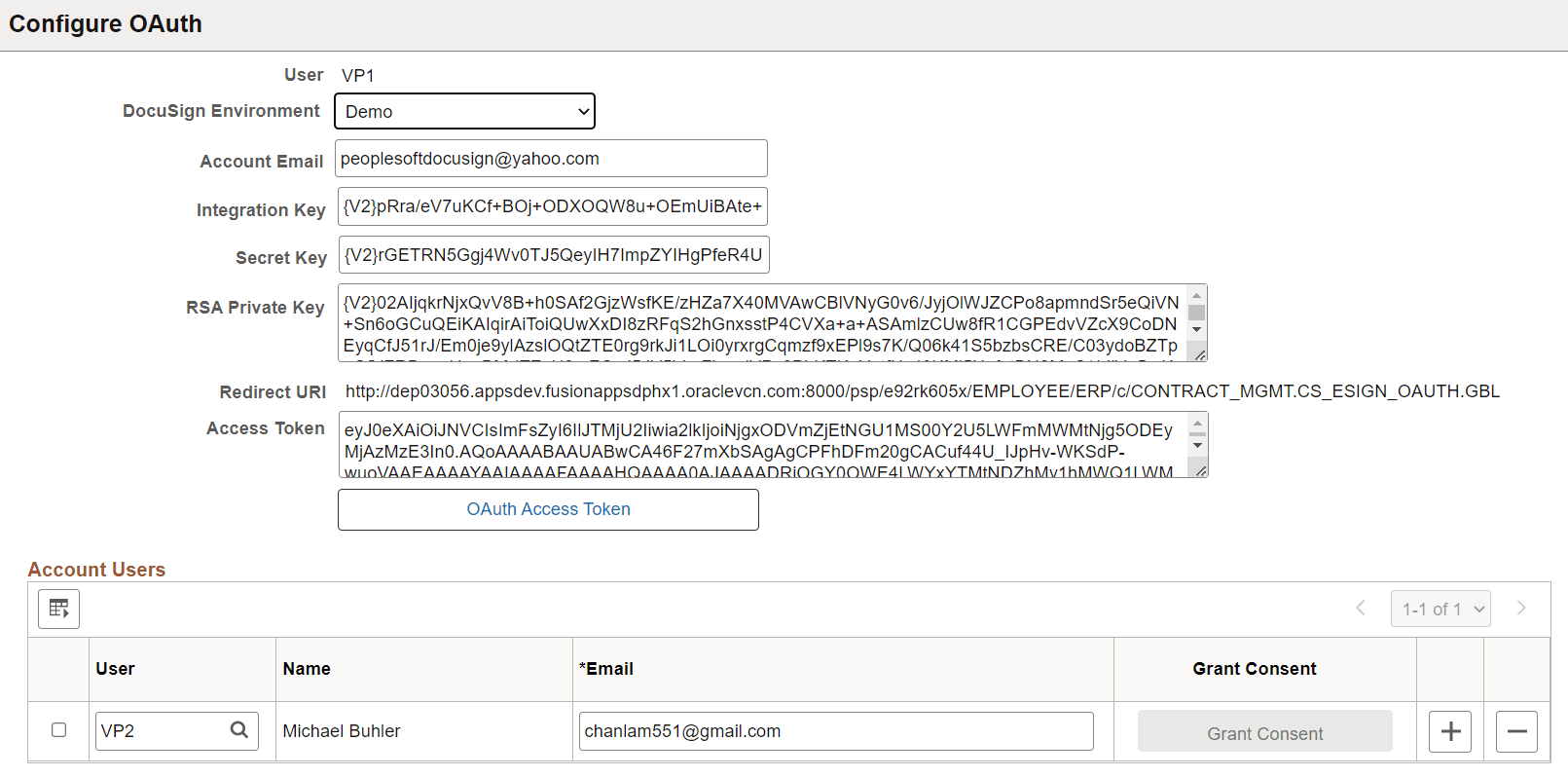

Configure OAuth Page
Use the Configure OAuth page (CS_ESIGN_OAUTH) to authorize API access by account administrator. The configuration starts with user authentication by logging into Adobe Sign or DocuSign account and then grant requested permissions to manage documents for signing. At the end of the process, an access token is returned to Configure OAuth page. Administrator will complete the process by entering users in the account, if any, and then save the page.
See document ‘30174722_Installation’ on the PeopleSoft FSCM 9.2: Update Image Documentation My Oracle Support page for instructions to configure OAuth access token for Adobe Sign.
See document '35171314_Installation' in My Oracle Support for OAuth configuration instructions for DocuSign.
Navigation:
Supplier Contracts, and then Supplier Contracts Setup, and then Configure OAuth
This example illustrates the fields and controls on the Configure OAuth page for DocuSign (1 of 2). You can find definitions for the fields and controls later on this page.
Configure OAuth page for DocuSign(1 of 2)
This example illustrates the fields and controls on the Configure OAuth page for DocuSign (2 of 2). You can find definitions for the fields and controls later on this page.

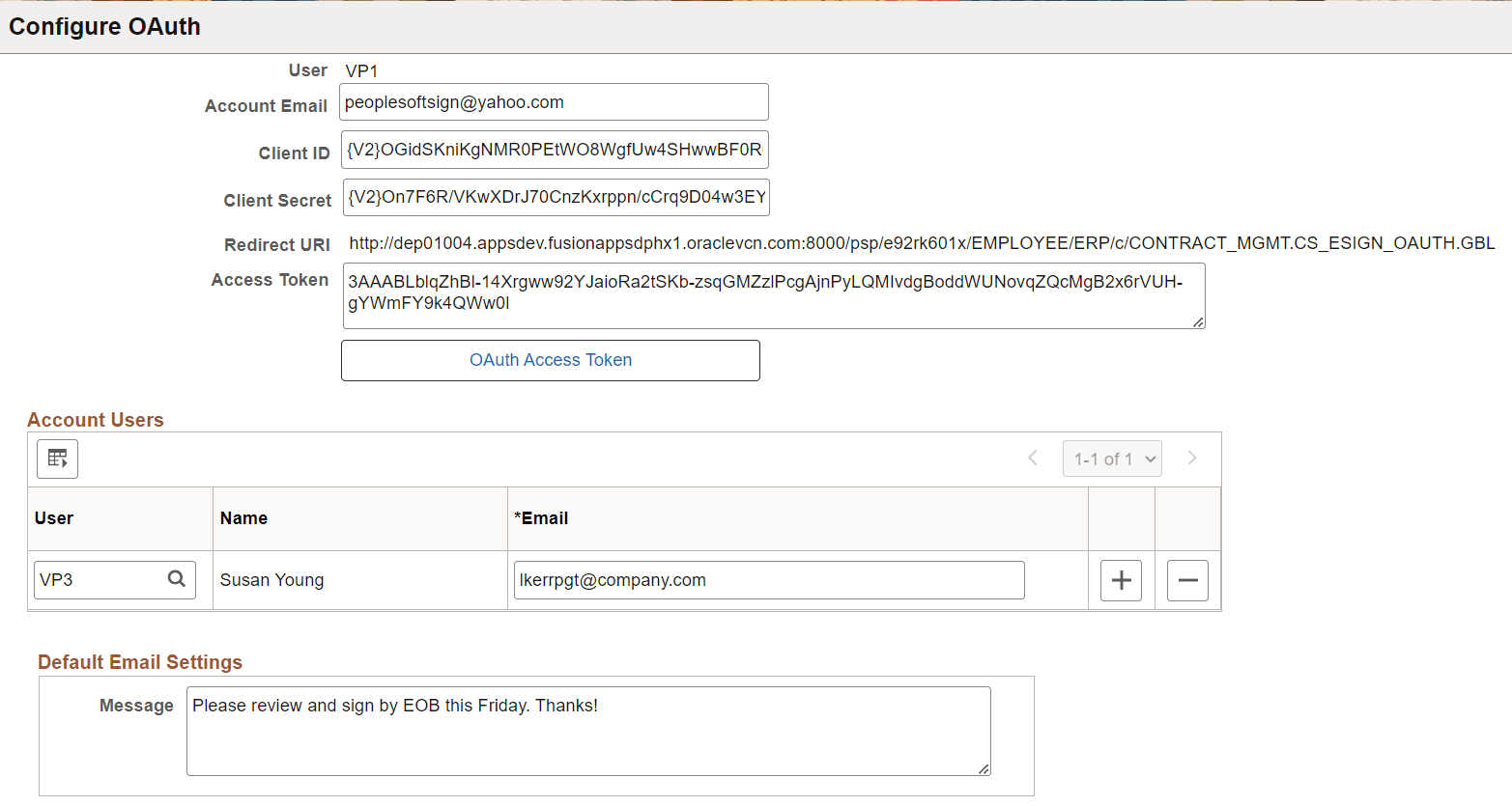

This example illustrates the fields and controls on the Configure OAuth page for Adobe Sign. You can find definitions for the fields and controls later on this page.
Field or Control Description
DocuSign Environment (DocuSign only)
Indicate whether the DocuSign account is used with your test or production environment. Options are Demo and Production.
Account Email
Enter Adobe Sign account email ID.
Integration Key (DocuSign only)
Enter the integration key obtained from the DocuSign account.
Client ID (Adobe Sign only)
Enter Client ID obtained from Adobe Sign.
Secret Key (DocuSign only)
Enter secret key obtained from the DocuSign account.
Client Secret (Adobe Sign only)
Enter client secret obtained from Adobe Sign.
RSA Private Key (DocuSign only)
Enter the RSA private key obtained from the DocuSign account.
Redirect URI
Displays URI to redirect user back to the PeopleSoft Configure OAuth page.
OAuth Access Token
Click button to get OAuth Access Token. Ensure the Redirect URI matches with Adobe Sign or DocuSign.
User will be authenticated and asked to grant permissions for API application to manage documents. Once authorized by user, an authorization code is returned to Configure OAuth and the code can then be used to exchange for an access token and refresh token. When token expires, refresh token is used to get new token to make REST API requests.
Account Users
Account Users
Associate PeopleSoft user ID to each user added to the Adobe Sign or DocuSign account with permission to manage documents for signing.
Grant Consent (DocuSign only)
Click on Grant Consent link to log into your DocuSign account and grant consent for Supplier Contracts applications to send documents for e-signing.
Email to Get User Consent
Select this button to send an email to selected users to authenticate with DocuSign and grant consent for Supplier Contracts applications to act on their behalf.

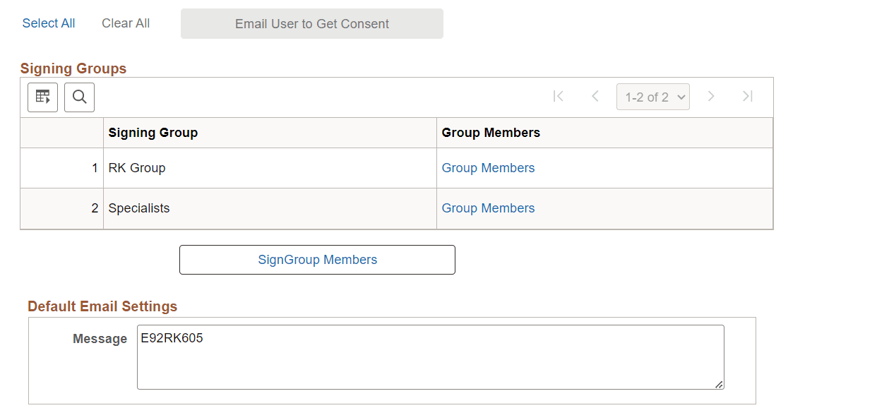

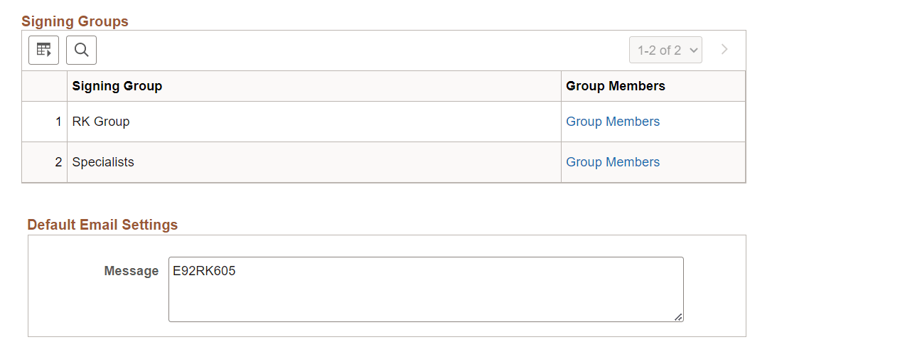

Signing Groups
Signing Group
Displays the signing groups associated with the DocuSign account.
Group Members
SignGroup Members
Select this button to refresh the list of signing groups when you make updates to signing groups in the DocuSign account.
Default Email Settings
Enter the default text for email message that will be used in the email notifications sent to signatories.
