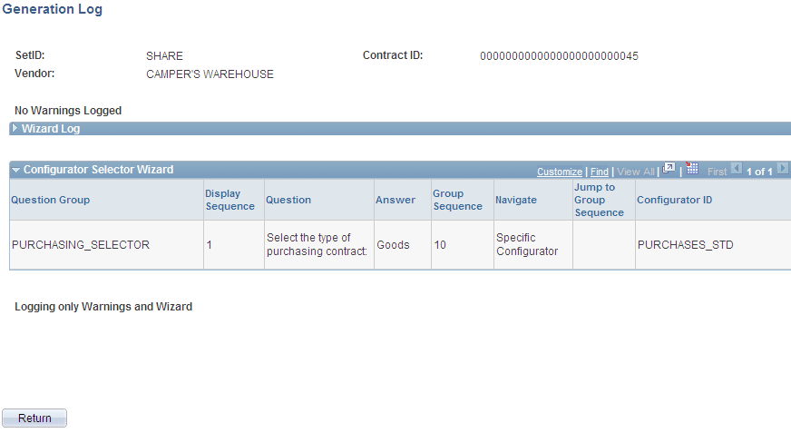

Generation Log Page
Use the Generation Log page (CS_DOC_WGEN_LOG) to view generation logs.
Navigation:
Supplier Contracts, and then Create Contracts and Documents, and then Document Management. Click the Generation Log link on the Document Management page.
This example illustrates the fields and controls on the Generation Log page. You can find definitions for the fields and controls later on this page.
Generation Log page
The logging option that is specified on the Document Configurator Definition page determines the grids that appear for the Generation Log page.
Use this page to view document processing information. This information indicates system processing conditions and any warnings that were produced during the document's generation.
Logging occurs during processing for rules, alternate clauses, and resolution of binds. The system provides messages on this page that indicate what it is logging. The messages are:

Configurator Selection Wizard
Use this grid to review the generation process when the system generates a document using a configurator selection wizard. This grid is similar to the Wizard Log grid, except it provides additional navigation information and the configurator ID used by the configurator selection wizard to create the document.
The values in the Navigate field define whether the configurator was defined for the wizard or if the configurator was selected based on the answers to wizard questions. The value in the Configurator ID field is either the predefined configurator or the configurator the system selected based on answers to configurator selection wizard questions. See Configurator Selection Wizards.
