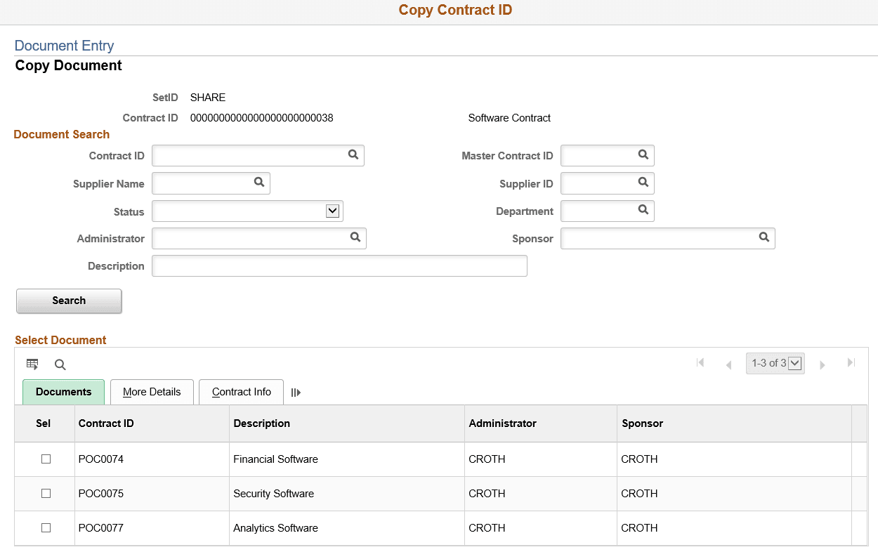

Understanding How to Copy Documents
Using the Copy Document feature, you can create documents for any source transaction by copying them from existing documents. This saves time when a new document contains the same edits that may have been done on a prior document. The Copy Document Page provides document attributes that you can use to search for existing documents. When searching document types, the search is limited to documents that have the same type that you specify for the document that you are creating. The system does not use a document configurator to build documents that you create when using the copy document method. Instead, it copies the document from the existing authored document and refreshes document content based on the bind variables of the source transaction for the target document.
When using multi-source configurators, the system enables you to copy documents from different source transactions as long as the existing and new documents use the same multi-source configurator within the document type.
You can specify rules within a multi-source configurator to include or exclude content from a document for each source so that the source and target document can include different content. For content that does not change due to rules or refreshed bind information, changing any edits made to the source document are preserved as much as possible in the target.
The system does not copy amendment files or imported documents.
When you are using the Copy Document button on the Add a Document Page, the system provides a convenient method to find and copy an existing document from which you can create a new document. Using the button, you access the Copy Document Page, and search for the document that you want to copy. After retrieving the document, the system displays the Create Document Page for you to define attributes for the new document.
After you select the document attributes, click the Create Document button to create the document. If the current configurator uses a wizard, the system runs the wizard using default values from the corresponding wizard in the document from which you are copying. You can override these values. The system then creates the document and displays the Document Management Page.

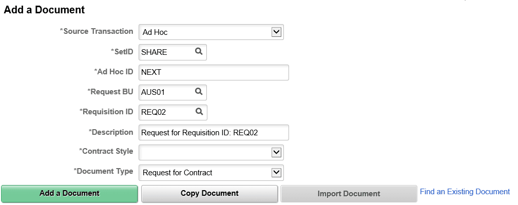

Example: Creating Ad Hoc Documents from Purchasing Requisitions
To create ad hoc documents from a purchasing requisition:
  1. Navigate to the Add a Document page.
  2. Select Ad Hoc in the Source Transaction field.
  3. Enter the SetID.
  4. Select Request for Contract in the Document Type field.
    Note that the available fields expand to include Request BU and Requisition ID.
  5. Enter an ID in the Ad Hoc ID field or allow the field to default to NEXT.
  6. Enter the business unit for the requisition.
  7. Enter the requisition ID.
    The system completes the Description field to access the Create Document page.
  8. Click the Add a Document button.
Use the Add a Document page (CS_DOC_ADD) to create ad hoc documents and ad hoc contracts from purchasing requisitions using Document Management.
Navigation:
Supplier Contracts, and then Create Contracts and Documents, and then Document Management
This example illustrates the fields and controls on the Add a Document page for purchasing requisitions.
Add a Document for Ad Hoc Requisition
Term Definition
Request BU (request business unit)
Select the business unit in which the requisitions exists. This field is only visible when using a document type that is setup to link to an eProcurement or Purchasing requisition.
Note: If you access this page directly from an eProcurement or Purchasing requisition page, the system automatically populates the field.
Requisition ID
Select the requisition to which you want to attach this document. This field is only available when you are using a document type that is setup to use a requisition. When the system creates the document, it provides a link from the Document Management page to the requisition in PeopleSoft Purchasing or eProcurement. In addition, you can access the document in the document authoring system using links from Purchasing or eProcurement requisition pages.
After the requisition is approved, buyers can use the document as supplemental information as they progress through the requisition process.
Note: If you access this page directly from an eProcurement or Purchasing application requisition page, the system updates this field.

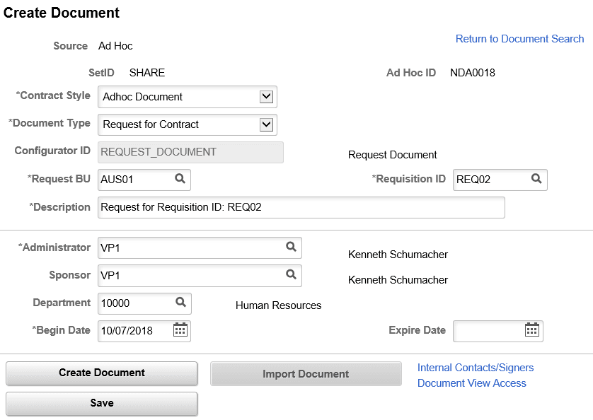

This example illustrates the fields and controls on the Create Document page for a requisition.
Create Document for Ad Hoc Requisition
Use this page to define document attributes for the requisition document. You can also import a document to use with the requisition. See Creating Authored Documents for Purchasing Contracts.

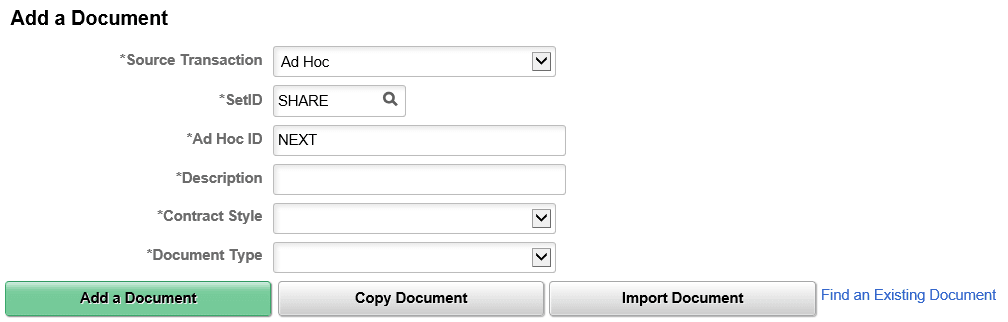

Add a Document Page
Use the Add a Document page (CS_DOC_ADD) to create documents for all source transactions.
Navigation:
This example illustrates the fields and controls on the Add a Document page when Ad Hoc is selected as the source transaction.
Add a Document
Use this page to select a source transaction and enter the key information pertaining to the document to be added. The field order may change based on the source transaction selected.
Field or Control Description
Source Transaction
Select Ad Hoc, Purchase Order, Purchasing Contract, or Sourcing Event. Depending on the source transaction that you select, either the Contract ID, PO ID, Ad Hoc ID, or Event ID field appears.
Note: For purchasing contract, purchase order, and sourcing event source types, you need to create the transactional data before creating a contract document.
Ad Hoc ID
Enter a name for the ad hoc document. This field is only available when you select Ad Hoc in the Source Transaction field.
Contract Style
Select a contract style you want to use for the document. The contract style is linked with the document type and source transaction.
  • Once a style is selected, only Document Types, which have been activated for use with this style, will appear in the document type drop down menu.
  • When the Source Transaction is a Procurement contract option, then contract style is restricted by that contract format, and cannot be changed.
PeopleSoft Source to Settle Common Information: Contract Style page
Document Type
Select a document type to use with this document. When creating a document the list of valid document types for a user is controlled by the roles associated with the document type on the Document Type Page. If installation options have been set to use the document type, the Document Type field is required. If the Use Document Type installation option has not been selected, the Document Type field does not appear on this page.
Note: If the document is based on a document type that points to a configurator selection wizard to determine which is the best configurator for the document, the system launches the wizard after you click the Add a Document button. These questions guide you when selecting a configurator to use with the new document. When the wizard is complete, the system automatically assigns the configurator ID.
Note: If the document type you are using has the Automatic Document Creation check box selected, then when you click the Add a Document button, the system immediately generates the document using the values specified in the document type and bypasses the Create Document page.
Contract ID
Select the purchasing contract for which you want to create a document. This field is only available when you select .Purchasing Contract in the Source Transaction field.
Event ID
Select the event from which you want to create a document. This field is only available when you select Sourcing Event in the Source Transaction field.
PO ID(purchase order ID)
Select the purchase order for which you want to create a document. This field is only available when you select Purchase Order in the Source Transaction field.
Description
The Description field is required.
  • If you are creating a purchasing contract document, the system enters the description from the purchasing contract.
  • If you are creating a purchase order document, the system uses the purchase order ID as the default value for purchase order description.
  • If you are creating a sourcing event document, the system uses the event name as the default value for the Description field.
Add a Document
Click to create the document based on a document configurator ID.
Copy Document
Click to access the Copy Document Page and create a new document from an existing document that is in the system.
Import a Document
Click to import a legacy document or a contract.
Note: Depending on user preference settings, this button may not be visible for all users.
See Importing Documents.

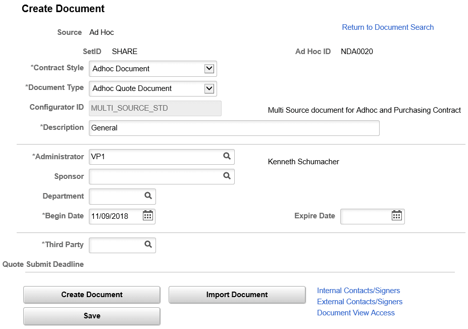

Use the Create Document page (CS_DOC_CREATE) to provide additional details when creating documents for all source transactions.
Navigation:
Supplier Contracts, and then Create Contracts and Documents, and then Document Management. Click the Add a Document button on the Add a Document page.
This example illustrates the fields and controls on the Create Document page for ad hoc sources. This page is similar when other sources are selected. However, variations may exist due to differences specified on the document type.
Create Document page (Ad Hoc)
Use this page to review and enter supplemental information and to create the contract document for ad hoc, purchase orders, purchasing contract, and sourcing event documents.
Contract Style
Select to change the contract style that you entered on the Add a Document page for Ah Hoc documents. If you change this field, it must correspond with the document types that are available. Depending on the type you select, the fields that are displayed on this page might change.
You cannot change the contract style for purchase order and purchasing contracts.
Document Type
Select to change the document type that you entered on the Add a Document page. Depending on the type you select, the fields that are displayed on this page might change. This field is only visible if Document Types are enabled.
Configurator Selector
Click to run the wizard that will select the configurator based on the answers to wizard question. The button is only available if document types are enabled and the document type selected is defined to use a configurator selector wizard.
Configurator ID
If you use a document type that has a specific configurator ID defined for it, the system automatically populates the Configurator ID field based on the document type. Or, if you are using a configurator selector wizard, the system populates the field when you complete the configurator selector wizard's questions. The Configurator ID field is only available if document types are not enabled, or if you are using document types and the user has configurator override capability defined on the document type.
Begin Date
For Ad Hoc documents only, this date represents the start date of the document. For example, this might be the begin date of the contract. The system uses this date to determine which effective content to use from the configurator ID when creating the document. The system does not display this date for PeopleSoft Purchasing contract documents. Their begin date is already specified in the contract itself.
Expire Date
For Ad Hoc documents only, this date represents the end date of the document, such as the end date of the contract. The system does not display this date for PeopleSoft Purchasing contract documents. Their expire date is already specified in the contract itself.
Description
You can override the description.
Cycle Start Date
Displays the current date. Only users who are set up with full document access on their user preferences can override the date. The start date establishes a cycle start date on which to track cycle times for contract document and amendment creation, approval, and execution. Using the cycle start and end dates, you can track documents to ensure that they meet time requirements.
Cycle End Date
Displays the date based on the number of days of cycle time and the cycle calendar that has been set up on the Installation Options page. The system adds the defined cycle time from the start date to arrive at the end date. The system calculates the date using the calendar to only include actual working days. Only users who are set up with full document access on their user preferences can override the date with a new value.
You use these cycle dates on the Document Management search results to identify contract documents that have stalled or are not progressing through the collaboration and approval cycle.

Create Document
Click to create the document. The system initiates the document generation process, expands the configurator, resolves binds and rules, and populates the generation log. If generation errors occur, the system displays a message. When the document is complete, the Document Management page appears with the appropriate buttons and links available for you to begin the document's life cycle.
Note: If the document configurator uses a wizard, the system presents the questions to the document author before generating the document.

Import Document
Click to import an document that was created outside of Supplier Contract Management. For additional information about importing document, see Understanding Document Import.

Copy Contract ID - Document Entry - Copy Document page
You can copy a document that is based on a different source transaction if the document type has been set up to allow copying from a different source transaction. The system determines the document combinations that can be copied by using the setting in the Applicable Sources section of the document configurator. These settings define the other source transactions documents that can be copied for documents that use the configurator.
Use the Document Search section to search for existing documents. The section fields depend on the type of document that you selected on the Add a Document page. The search criteria for ad hoc documents, is related to document attributes defined for a document.
  • For purchasing contracts, additional search criteria relates to contract information.
  • For purchase order documents, the search criteria relates to purchase order information.
  • For RFx documents, the search criteria relates to sourcing event information.
The Copy From Source field appears when you are using a document configurator that is defined to use with multiple transaction sources. For example, this allows you to copy a document from an ad hoc document to a purchase order contract document when both documents use the same configurator. In addition, the document type must allow copying from one source to another. However, if a section needs to be changed due to a rule change or perhaps a change to transaction data in a repeating section, then the configurator is used to rebuild that section.
When you select an option in the Copy From Source and select a value in the Supplier SetID field, the system verifies the SetID and business unit corresponding to the ID, and displays only those documents for the copy from source type in the Select Document section.
After you click the Search button, the system provides the documents that match the search criteria in the Select Document section. Select the Sel (select) check box next to the document that you want to copy. Use the Documents tab to view basic information about the documents that are retrieved in the search, and use the More Details tab to view the document's status, begin date, and expiration date. You must have security access to the document before you can copy it. The system provides a warning if the document is not in an Approved, Collaborated, Complete, Dispatched, or Executed status, and if a separate amendment exists . Only the latest version of the main contract is copied.
The system performs searches based on matching source transactions, existing authored documents, contract process options, and document types. You cannot copy imported documents unless you are copying from a sourcing event to the awarded contract or purchase order document.
Searches also include the following criteria:
  • The document must exist in the system.
  • The source transaction must be of the same type, unless you select a multiple source configurator
  • Documents returned in the search must match the document type unless you select a multiple source configurator.
  • If copying from a document with a different source transaction, then both the ‘from and to’ documents must use the same multiple source configurator.
  • Purchase order contracts, must match the contract process option.
    Therefore, if you are searching for a particular contract and the process option does not match, that contract does not appear in the search results.
After you select the document that you want to copy, click the OK button. The Create Document page appears with information about the document that you are going to copy and the document you are going to create.
