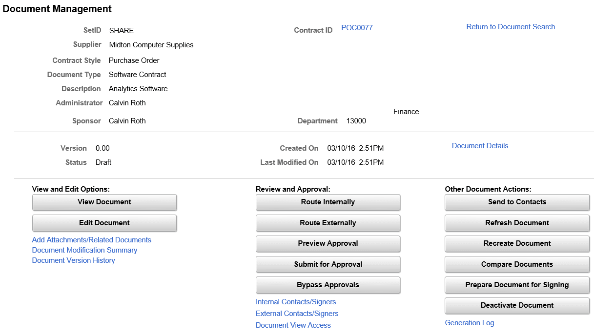

This example illustrates the fields and controls on the Document Management Page.
Document Management
The Document Management page controls the document authoring system. The actions that you take to manage document life cycles begin here. Depending on the type and status of the document, the system displays different fields and buttons as the document goes through its life cycle.
This topic describes the Document Management page as you use it for purchasing contract and ad hoc documents. Terms that are not defined here are listed in the Common Elements Used When Managing Document Life Cycles topic. The Life-Cycle Statuses and Actions section also provides more detailed information about this page.
The status of the document, collaboration, and approval determine the actions that you can perform to the document. The action links and buttons on this page will vary. For a complete listing of the links and buttons, see the Document Actions table.
These fields and buttons are available:
Field or Control Description
Return to Document Search
Click to access the Document Search page, where you can search for another document. The search page will be displayed with the last set of search criteria and results shown.
Ad Hoc ID
Displays the ad hoc identifier. The field only appears for ad hoc source transactions.
Contract ID
Displays the identifier for the procurement contract for which you are creating or maintaining documents. The field only appears for purchasing contract source transactions. .
PO ID
Displays the system-defined identifier for the PeopleSoft Purchasing purchase order for which you are creating or maintaining documents. The field only appears for purchase order source transactions.
Contract Style
Displays the contract style that was used to create the document.
Document Type
Displays the document type that was used to create the document. .
BU/Requisition (business unit/requisition)
Click this link to access PeopleSoft Purchasing and PeopleSoft eProcurement requisition pages for this business unit and requisition. This field appears only if the document is tied to a requisition.
Amendment Configurator ID
Displays the amendment configurator ID that was used to create the amendment. The system displays this field when a configurator has been established for an amendment and is defined as a use for amendments-only document. See Creating Document Amendments.
Document Details
Click to access the Document Details page, where you can update the administrator, document type, sponsor, department, document description, and user-defined fields. See Maintaining Document Details.
Description
Displays either a contract description or a user-defined description for the document that is identified in the Document ID field. Use the Document Details link to add or update the description.
Version
Displays the current version of the document. The system automatically updates the version of a document. The system updates versions each time that the document is checked in, refreshed, recreated or amended. You can control whether the system updates the version by selecting the Allow Check in as Same Version check box on the Document Formatting and Options page. When you select the check box, the system provides an additional option for you to indicate that you want to use the same version when you check in the document.
Add Attachments/Related Documents and Modify Attachments/Related Documents
Click to access the Attachments and Related Documents page, where you can add or view existing attachments and related documents, upload additional attachments, and set external or internal use for the attachment. An extra grid appears that displays attachments that were added to Purchasing contracts using the Contract page.
Related documents are other document within the document authoring system that you can link to the current document. When you link one document to another document, you can use the Where Used as Related Document link for that document to access the Search for All Content Instances page that provides details about where the document has been added to another document as a related document.
See Viewing and Uploading Attachments and Related Documents.
Status
Displays the current status of the document. Along with approval and collaboration requirements, the document status can also be determined by the document type. You define the statuses that a specific document type should use. For example, you can reduce the number of statuses that a document goes through by selecting values that use only two statuses for a document as it goes through its life cycle. Newly generated documents start with a status of Draft.
If document approvals are not required, the Pending Approval status is not applicable.
Displays the current document status. Values can be:
  • Draft: - The document has been generated and is in an initial Draft status. The system displays the latest version of the draft.
  • In Collab (pending collaboration): - The document has been routed for collaboration, but all collaborators have not responded.
  • Collabed (collaborated): - The document has been reviewed by all collaborators and the document administrator or owner has reviewed and updated the document based on collaborator reviews.
  • Pending (pending approval): - The document has been routed using workflow approval.
  • Approved: - The current document has been approved internally and is available for supplier dispatch for final signatures and execution.
  • Denied: - The current document has been denied internally.
  • Dispatched: - The current documents have been dispatched to the supplier and are waiting for final signatures.
  • Executed: - The current document has been executed.
    The system preserves the executed version and enables the contract for amendments. When an amendment is first initiated, the authored status cycles begins again starting with Draft and the amendment number is shown. Previous versions, including current executed contract, can be viewed by clicking the Maintain Document button.
  • Pending Review (collaborated, pending review): - The document has been reviewed by all collaborators and is awaiting a final review by the document administrator or owner.

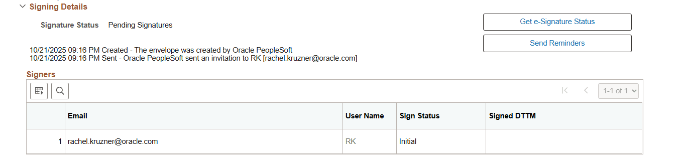

Signing Details
Use this section to track the status of pending signatures. This section appears only after a document has been submitted for signing.
Document Management page - Signing Details section
Get e-Signature Status
Click to track the status of pending signatures.
When clicked, the page displays the signature status and associated signer information.
Send Reminders
Click to send email reminders to signers who are currently pending signatures.
