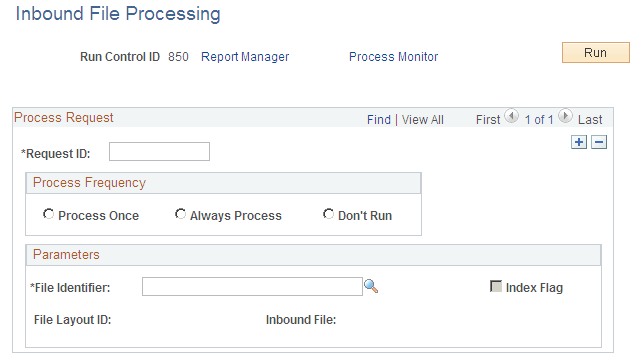

Inbound File Processing Page
Use the Inbound File Processing page (PSIBFILERUNCNTL) to launch this process to load sales order data from a flat file using an EDI X.
12 850 format. The data is loaded into PeopleSoft's staging tables.
Navigation:
PeopleTools, and then Integration Broker, and then File Utilities, and then Inbound File Processing
This example illustrates the fields and controls on the Inbound File Processing page. You can find definitions for the fields and controls later on this page.
For inbound flat file data using the EDI X.12 850 format, use the Inbound File Processing run control page to launch the Application Engine process PTIB_INFILE that initiates the file-to-message processing. The file-to-message processing function reads the file and publishes it as a message.

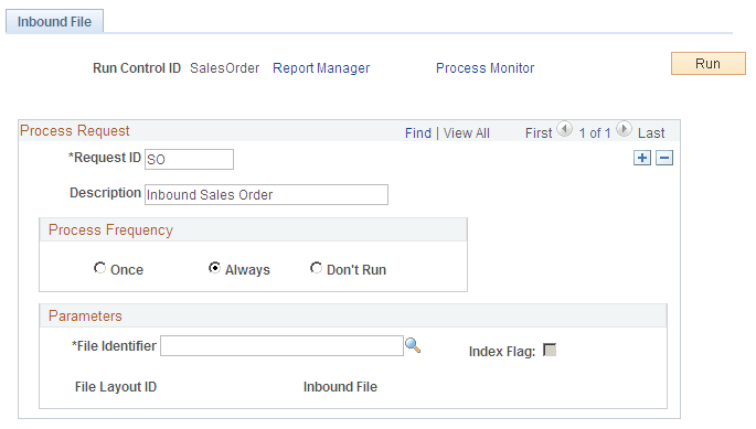

Inbound File Page
Use the Inbound File page (EO_FILETOMSG) to launch this process to bring sales order data in a non-EDI flat file (EDI X.
12 850 format) into PeopleSoft's inbound staging tables.
Navigation:
Enterprise Components, and then Integration Definitions, and then Initiate Processes, and then Inbound File Publish
This example illustrates the fields and controls on the Inbound File process page. You can find definitions for the fields and controls later on this page.
For inbound flat file data not using the EDI format, use the Inbound File run control page to launch an Application Engine process that initiates the file-to-message processing. The file-to-message processing function reads the file and publishes it as a message.

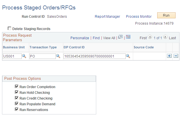

Electronic Commerce Page
Use the Electronic Commerce page (RUN_OM_EC) to launch this process to load inbound sales order data from the inbound staging tables to the PeopleSoft production tables.
Navigation:
Order Management, and then Electronic Commerce, and then Process Staged Orders and RFQs
This example illustrates the fields and controls on the Electronic Commerce page. You can find definitions for the fields and controls later on this page.
The Electronic Commerce process (OM_EC) is part of the overall inbound electronic commerce flow and is the process that takes sales orders that are loaded in the staging tables and validates the fields that are on the record to insure that the values are correct. The process performs these steps:
  • Edits the data, such as customer numbers and units of measure, to ensure that they are valid.
  • Converts the customer's product or item number to a PeopleSoft product identifier, when a PeopleSoft product identifier is not provided.
  • Assigns PeopleSoft order numbers.
  • Sets system defaults and status flags.
  • Validates data changes to ensure that they are valid.
  • Loads data into the production order tables (order staging data that is found to have errors is not loaded into the production tables until the errors are resolved).

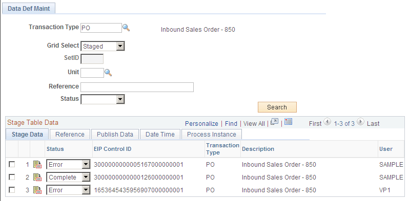

Data Def Maint Page
Use the Data Def Maint (Data Definition Maintenance) page (EO_EIP_CTL_MAINT) to view data detail or correct errors for inbound sales order transactions.
Navigation:
SCM Integrations, and then Transaction Error Handling, and then Transaction Error Data Defn
This example illustrates the fields and controls on the Data Definition Maintenance page. You can find definitions for the fields and controls later on this page.
Use the Data Definition Maintenance page to view the status of the transaction. Select a Transaction Type of PO. Enter a business Unit. Click the Search button.

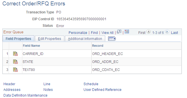

Click the Details icon to access the Error Summary page where you can view and correct errors.
This example illustrates the fields and controls on the Error Summary page. You can find definitions for the fields and controls later on this page.
Error Summary page
Navigate to the Header, Line, Schedule, Addresses, Notes, or User Defined References to fix errors.

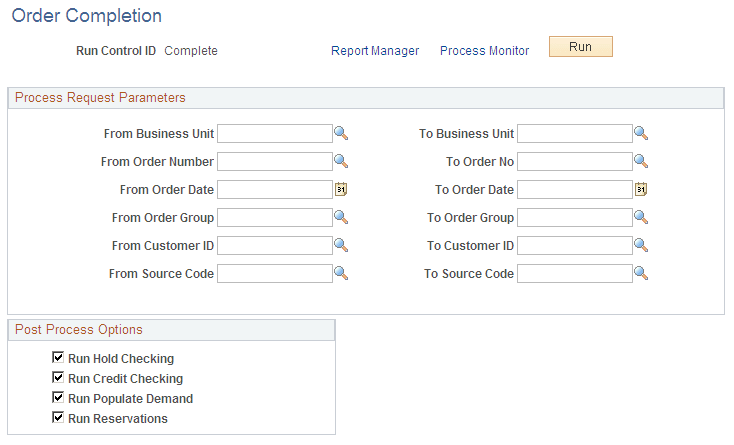

Order Completion Page
Use the Order Completion page (RUN_OM_BACKGRND ) to run the Order Completion process to complete processing for the request for all inbound sales order data.
Navigation:
Order Management, and then Quotes and Orders, and then Process Orders, and then Order Completion
This example illustrates the fields and controls on the Order Completion page. You can find definitions for the fields and controls later on this page.
The Order Completion/Repricing process (OM_BACKGRND) completes processing for sales orders that are entered into PeopleSoft Order Management by several methods, including flat file and XML messages. Completing this process enables you to access the orders from the Order Entry Form component.
Enter the selection criteria, and click Run.
