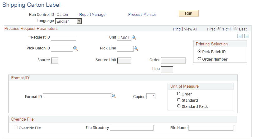

Shipping Carton Label Page
RUN_INS6025
Select the process request parameters for shipping carton labels. The shipping carton labels can be automatically printed during picking.

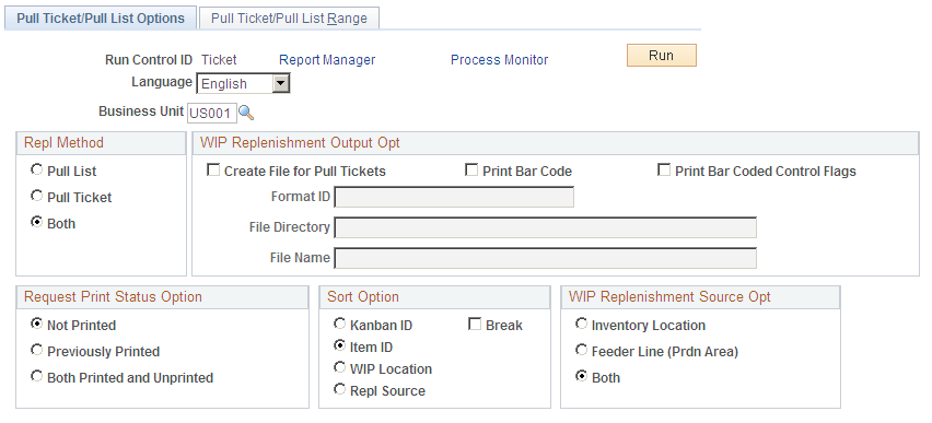

Pull Ticket/Pull List Options Page
Use the Pull Ticket/Pull List Options page (RUN_FPS6500) to indicate how you want to print pull tickets and pull lists.
Navigation:
  • Manufacturing Definitions, and then Kanban, and then Electronic Kanbans, and then Print Pull Ticket/Pull List, and then Pull Ticket/Pull List Options
  • SCM Integrations, and then Barcode Labels, and then Pull Ticket Label, and then Pull Ticket/Pull List Options
This example illustrates the fields and controls on the Pull Ticket/Pull List Options page. You can find definitions for the fields and controls later on this page.
Field or Control Description
WIP Replenishment Output Opt
Choose one of the three options for the WIP Replenishment Output Options.
  • Select Create File for Pull Ticketsto create an extract file. You can use this file to download pull ticket information to label generation software.
  • Select Print Bar Code to print bar codes for bar coded fields on the pull ticket.
  • Select Print Bar Coded Control Flags to attach an item's control flags to the bar code printed on each line of the pull ticket. These control flags enable the electronic data collection system to prompt for the lot ID, serial ID, staged date, or shipping serial ID immediately after the user scans the bar-coded line number field. For cases that do not require control flags, you might prefer not to select this check box. The format for the bar code printed for each detail line is LSDAH:99999, where:
    • L = Lot ID Control Flag
    • S = Serial ID Control Flag
    • D = Staged Date Control Flag
    • A = Actual Cost Control Flag
    • H = Shipping Serial ID Control Flag
    • : = Constant
    • 99999 = Line Number
Note: PeopleSoft delivers printer settings for all SQR output to a generic line printer. However, when printing bar coded information on reports on a PCL printer (HP Laser Jet), you must first define the printer type accordingly. You may do this by changing the printer type settings delivered in SETENV.SQC from LINEPRINTER to HPLASERJET.
Format ID
Select a Format ID for the extract file. You set up format IDs on the Data Collection Label Setup page.
File Directory and File Name
Enter the File Directory and File Name to which you want to save the pull ticket file extract.
Request Print Status Option
Select a Request Print Status Option: Not Printed, Previously Printed, or Both Printed and Unprinted.

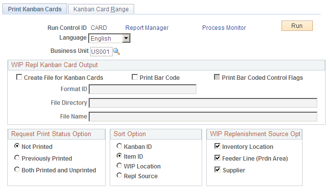

Printing Kanban Card Page
Use the Print Kanban Card page (RUN_FPS6510) to print Kanban Card labels.
Navigation:
  • SCM Integrations, and then Barcode Labels, and then Print Kanban Card Label, and then Print Kanban Cards
  • Manufacturing Definitions, and then Kanban, and then Kanban Cards, and then Print Kanban Cards
This example illustrates the fields and controls on the Print Kanban Cards page. You can find definitions for the fields and controls later on this page.
WIP Repl Kanban Card Output
Choose one of the three options for the WIP Replenishment Kanban Card Output options.
  • Select Create File for Kanban Cardsto create an extract file. You can use this file to download Kanban card information to label generation software.
  • Select Print Bar Code to print bar codes for bar coded fields on the Kanban card.
  • Select Print Bar Coded Control Flags to attach an item's control flags to the bar code printed on each line of the Kanban card. Flow Production uses serial control and lot control flags. These control flags enable the electronic data collection system to prompt for the lot ID, serial ID, staged date, or shipping serial ID immediately after the user scans the bar-coded line number field. For cases that do not require control flags, you might prefer not to select this check box. The format for the bar code printed for each detail line is LSDAH:99999, where:
    • : = Constant
Format ID
Enter the File Directory and File Name to which you want to save the Kanban card file extract.
If you print Kanban cards that haven't been previously printed, the system changes the Kanban ID status to Open from New. Cards that were previously printed display Reprint on the card.
Use the Shipping Carton Label page (RUN_INS6025) to select the process request parameters for shipping carton labels.
Navigation:
SCM Integrations, and then Barcode Labels, and then Shipping Carton Label
This example illustrates the fields and controls on the Shipping Carton Label page. You can find definitions for the fields and controls later on this page.
If the format ID is not entered, it automatically appears first from the ship to location, then from the sold to location, or then from the Label Setup page, in that order, depending on which of these values exist.
To specify a file directory and file name for the label extraction file, select the Override File check box, and enter the file directory and file name. Deselect the Override File check box to create the extraction file in the default directory with the default file name.
To select the directory for the carton label file, use the following hierarchy:
  1. The path you specify for the file directory takes precedence.
  2. If you do not specify a file directory, the directory automatically appears the Pick Plan Bar Coding Options page in the Setup Fulfillment component (ORDER_FULF_SETUP).
  3. If no directory is specified on the Pick Plan Bar Coding Options page in the Setup Fulfillment component, the directory name is the FILEPREFIX that was specified in SETENV.SQC during the initial system setup.
    For information on setting the FILEPREFIX in the SETENV.SQC, refer to the installation documentation.
  4. If no FILEPREFIX was specified during system setup, the directory name defaults to the current directory where the label program is running.
To name the file for the carton label file, use the following hierarchy:
  1. The file name specified in the File Name field takes precedence.
  2. If you don't specify a file name, the file name is the file prefix defined on the Pick Plan Bar Coding Options page in the Setup Fulfillment component combined with the last five digits of the process ID and the file suffix defined on the Pick Plan Bar Coding Options page.
  3. If nothing is specified on the Pick Plan Bar Coding Options page, the last five digits of the process ID are used as the file name and the file name suffix is the FILESUFFIX that you specified in SETENV.SQC when you initially set up the system.
    For information on setting the FILESUFFIX in the SETENV.SQC, refer to the installation documentation.
  4. If no FILESUFFIX was specified in SETENV.SQC when you initially set up the system, the last five digits of the process ID are used as the file name and no suffix is appended.
File Prefix File Name File Suffix
Override
Override
Override
The file prefix defined on the Pick Plan Bar Coding Options page in the Setup Fulfillment component.
The last five digits of the process ID. If multiple requests can be entered on the label request page, then an additional two-digit sequential number starting with 01 is appended to the end of the file name.
The file suffix defined on the Pick Plan Bar Coding Options page in the Setup Fulfillment component.
None
The FILESUFFIX that you specified in SETENV.SQC.
None
None.
