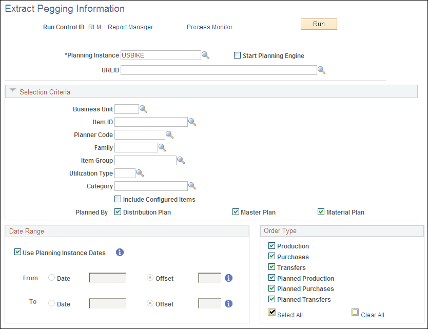

This process will extract information on supply that has been pegged to top level demand, and place it in the output table PS_SPL_PEGGING_INF. You will need to create a report to view the pegging information. You can filter the extracted output by adjusting the values within the Selection Criteria, Date Range, and Order Type group boxes.
Page Used to Extract Pegging Information
Extract Pegging Information Page
PL_PEGGING_REQ1
Extract information on supply that has been pegged to top level demand.
Use the Extract Pegging Information page (PL_PEGGING_REQ1) to extract information on supply that has been pegged to top level demand.
Navigation:
Supply Planning, Solve Plan, Extract Pegging Information
This example illustrates the fields and controls on the Extract Pegging Information Page. You can find definitions for the fields and controls later on this page.
Field or Control Description
Start Planning Engine
Select this box and the process will start the planning engine prior to running the extract.
Include Configured Items
A non-active field that is related to a deprecated product.
Offset
Values entered in the Offset field will allow the date range to be based on a set amount of days earlier or later than the current date.
