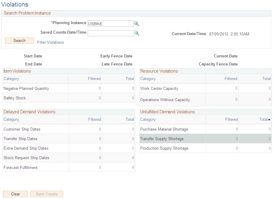

Violations Page
Use the Violations page (PL_REVIEW_ERRORS) to establish plan violation criteria and filters and retrieve violations that prevent a material or capacity plan from being feasible.
Navigation:
Supply Planning, and then Solve Plan, and then Analysis, and then Violations
This example illustrates the fields and controls on the Violations Page. You can find definitions for the fields and controls later on this page.
Violations page
Field or Control Description
Saved Counts Date/Time
Select a previously saved set of violation counts for review. You can save summary violation counts at any time, including before or after solver runs. When you save violation counts, the system retains the totals only. Additional details for saved counts are not available.
Search
Click to perform a new search using the filters that you defined.
Filter Violations
Click to access the Violations - Filter Violations page, where you can specify selection criteria to narrow the number of violations that the system displays on the Violations summary page.
Start Date
The beginning time boundary. Used with the end of time, this region defines the time period within which the system recognizes orders and changes. Solvers do not recognize times before the start of time.
End Date
The concluding time boundary. Solvers do not recognize orders or changes after this date.
Current Date
The current date and time for the planning instance. This fence is used to define various time offsets respected by the planning solvers.
Early Fence Date
The beginning time of the interval within which solvers process the elements of the material- and capacity-feasible plans and calculate constraint violations.
Item Violations
Negative Planned Quantity
An item has a negative planned quantity on hand between the item's early fence and the late fence. The system calculates the violation if the item's histogram quantity falls below zero at any time between the current time and the late fence.
Note: The system counts an item with negative planned quantity only once, even if the item has multiple occurrences of negative planned quantity on hand.
Safety Stock
The system generates a violation if an item has a planned quantity on hand below safety stock between the item's early fence and the late fence.
Note: The system counts an item with stock violations only once, even if the item has multiple occurrences of safety stock violations.
Delayed Demand Violations
Customer Ship Dates
The target ship date on a customer order cannot be met, and the order will ship late. The system generates a violation if the planned ship date is after the target ship date.
Transfer Ship Dates
The scheduled ship date on a transfer cannot be met and the transfer will be supplied late. The system generates a violation if the planned ship date is after the scheduled ship date.
Extra Demand Ship Dates
The target demand date on an extra demand required cannot be met and the extra demand will be supplied late. The system generates a violation if the planned schedule date is after the schedule ship date.
Stock Request Ship Dates
The target ship date on a material stock request cannot be met and the material stock request will be shipped late. The system generates a violation if the planned ship date is after the schedule ship date.
Forecast Fulfillment
A forecast demand cannot be met on the forecast date. The system generates a violation if the forecast demand has been canceled or satisfied at a later time.
Resource Violations
Work Center Capacity
A work center is overloaded. The system generates a violation if the work center's aggregate utilization exceeds the resource aggregate capacity between the global early fence and the capacity fence.
Note: The system counts a work center capacity violation only once, even if the work center has multiple periods where it is overloaded.
Operations Without Capacity
A production operation occurs at a work center for which the work center capacity has been exceeded. The system generates a violation only for production operations for which no or partial work center availability exists. For example, if an operation occurs in an overloaded capacity bucket and the operation only consumes available capacity, the system does not generate a violation.
The system sorts which operation steps use the available capacity according to:
  • Operation start date and time.
  • Priority.
  • Work center quantity usage (smallest to largest).
  • Sequence number.
By sorting based on operation start date and time, the system first allocates available capacity to operations that may have started in a previous capacity bucket.
Unfulfilled Demand Violations
Production Supply Shortage
Demand has no supply for items where the default sourcing option is a production option. The system generates a violation if the supply for any demand on an item (for which the default sourcing option is a production sourcing option) does not exist or would occur after the demand date. If an item has no default sourcing option, the system considers the sourcing type a production sourcing option if the item's make or buy option is Make.
Purchase Material Shortage
Demand has no supply for items where the default sourcing option is a purchase option. The system generates a violation if the supply for any demand on an item (for which the default sourcing option is a purchase sourcing option) does not exist or would occur after the demand date. If an item has no default sourcing option, the system considers the sourcing type a purchase sourcing option if the item's make or buy option is Buy.
Transfer Supply Shortage
Demand has no supply for items where the default sourcing option is a transfer option. The system generates a violation if the supply for any demand on an item (for which the default sourcing option is a transfer sourcing option) does not exist or would occur after the demand date.

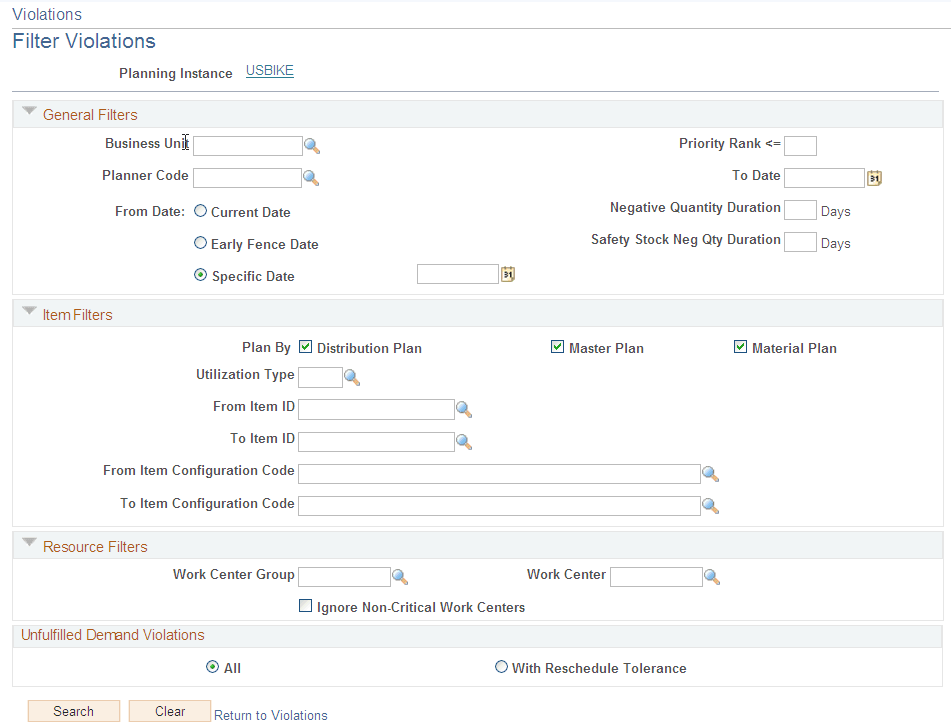

Violations - Filter Violations Page
Use the Violations - Filter Violations page (PL_RVW_ERR_FILTERS) to specify selection criteria to narrow the number of violations that the system displays on the Violations summary page.
Navigation:
Click the Filter Violations link on the Violations page.
This example illustrates the fields and controls on the Filter Violations Page. You can find definitions for the fields and controls later on this page.
Business Unit
Select violations for the specified inventory business unit only. For interunit transfers, the system uses the source business unit.
Planner Code
Select violations for items associated with a specific planner code only.
From Date and To Date
Select violations in the date range specified only. For item violations and capacity violations, the system selects only those violations where the occurrence falls within the date range for the item. For delayed demands, the system selects violations only if the target ship date is in the date range. For unfulfilled demands, the system selects violations only if the demand date is in the date range. Define the from date as an early fence date, current date, or as a specific date. If you specify no date range, the system uses the late fence date as the to date when calculating for violations.
Priority Rank
Applies to unfulfilled demand violations and delayed demand violations only. Select violations if the item's demand priority rank is equal to or higher than the specified priority.
Note: Small priority rank numbers (those numbers closer to zero) have higher demand priorities.
Negative Quantity Duration
Select only the negative quantity violations in which the duration is greater than or equal to the number of days specified in this field.
Safety Stock Neg Qty Duration (safety stock negative quantity duration)
Select only the safety stock violations in which the duration is greater than or equal to the number of days specified in this field.
Planned By
Select only those violations that are associated to items with these specified planned-by types: distribution plan, master plan, and material plan.
Utilization Type
Select only those violations with items that are associated with the utilization type.
From Item ID and To Item ID
Select only those violations with item codes in the specified range.
From Item Configuration Code and To Item Configuration Code
A non-active field that is related to a deprecated product.
Work Center
Select capacity violations that occur on the specified work center. The work center filter applies to operations without capacity and aggregate capacity violations only.
Work Center Group
Select capacity violations that occur on work centers in the specified work center group. The work center group filter applies to operations without capacity and aggregate capacity violations only.
Ignore Non-Critical Work Centers
Select the check box to ignore capacity violations for Non-Critical Centers.
All
Shows all Unfulfilled Violations. This is the default selection.
With Reschedule Tolerance
Select to display Unfulfilled Violations, without considering demands which are satisfied by supplies within tolerance.
The system determines the aggregate capacity error total according to the total count in the Operations without Capacity Filtered column on the Violations page. For example, suppose that after applying the item filter, the operations without capacity all occur on the same work center (and the total in the corresponding Filter column equals 1), then the work center capacity total error count equals 1.
Return to Violations
Click to return to the Violations page without performing a search.
Search
Click to apply the filtering criteria and review the results on the Violations page.
Clear
Click to delete all of the previously entered filter criteria.
