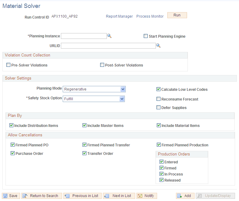

This example illustrates the fields and controls on the Material Solver Page . You can find definitions for the fields and controls later on this page.

Run
Click to generate a material plan using the PeopleSoft Process Scheduler.
Planning Instance
Select a planning instance. Planning instances IDs define a complete set of data analyzed to create a material supply plan
Solver Settings
Field or Control Description
Planning Mode
Values are:
Regenerative: The Material solver plans for every item in the model. The solver deletes all of the planned orders before planning for each item.
Net Change: The Material solver replans only those items that are marked to be planned, only items with violations (items with negative quantity at any point at or after the item's early fence). The solver uses an item histogram to check for projected on-hand quantity at any point. Projected on-hand quantity can become negative as a result of new demands, if supplies are deleted, or if the demand is not satisfied from the previous run. The Material solver considers no new supplies in net change mode (it does not reschedule new supplies to meet new demands), and creates only planned supplies to meet negative quantity.
Safety Stock Option
Specify how you want the solver to plan for safety stock levels. Select Ignore to ignore safety-stock constraints. Use this value for what-if scenarios.
Select Ignore Prior to First Demand if you want the solver to ignore safety stock demands prior to the first demand.
Select Fulfill if you want the solver to plan supply for safety-stock demand as early as possible after the item's early fence. This is the default setting.
Note: Once the Planning Instance is selected, the system updates this field with the value on Planning Instance. You can change it at anytime, and save. This new value will remain with the run control, and not copy back to the Planning Instance.
Defer Supplies
Select to indicate that supplies should be moved out later to meet a demand. Generally, supplies are moved earlier to meet demands on time.
Plan By
Use this group box to indicate whether you want the solver to include items that have been defined in the material plan, master plan, distribution plan, or any combination. The solver includes items that are associated with the specified planned-by types only.
Select the Include Distribution Items, Include Master Items, or Include Material Items check box or any combination to items in include in the material plan.
Allow Cancellations
At the start of the solver run, the Material solver deletes planned orders that are not firm and cancels all the excess supplies at the end of the run. You can also use the check boxes in the Allow Cancellations group box to define to the Material solver which orders it can cancel when the supply is not frozen.
The system passes the frozen supply setting from the PeopleSoft Manufacturing system. You can then make the update in PeopleSoft Supply Planning and apply the update back to manufacturing. Frozen orders cannot be cancelled by the Material solver even if the orders are in excess. You can define an order as frozen using pages for each type of order. The system reschedules nonfrozen orders to meet demand on time. If the supplies are frozen and supply cannot be created on time, the system uses late frozen supply. If there is no late supply, then the supply is created in the early fence.
The default value for the check boxes is selected. Click the check box for the type of order or for the firm-planned order that you want to deselect. When you deselect an order, the system deselects the check box and does not allow the cancellation of frozen supplies. Available orders include:
