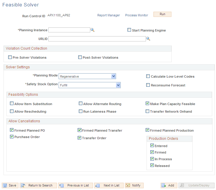

Feasible Solver Page
Use the Feasible Solver page (PL_FSBL_SOLVE) to define criteria for the Feasible solver.
Navigation:
Supply Planning, and then Solve Plan, and then Initiate Feasible Solver
This example illustrates the fields and controls on the Feasible Solver Page. You can find definitions for the fields and controls later on this page.
Solver Settings
Field or Control Description
Planning Mode
Values are:
Regenerative: Before you run the feasible solver, all nonfrozen planned orders are removed from the planning instance, all independent demands are moved back to their original target dates, and the solve is initiated.
Net Change: All supplies are retained and renetted against all demands in the model.
Safety Stock Option
Select one of these values:
  • Fulfill: Select to plan for safety stock demand as early as possible after an item's early fence. This is the default setting.
  • Ignore: Select to ignore safety stock constraints. When you select this value, the Material solver does not plan for meeting safety-stock levels nor does it plan supply for safety-stock demand.
  • Ignore Prior to First Demand: Select to ignore all of the safety stock constraints that occur prior to the first demand.
Note: Once the Planning Instance is selected, the system updates this field with the value on Planning Instance. You can change it at anytime, and save. This new value will remain with the run control, and not copy back to the Planning Instance.
Feasibility Options
Allow Alternate Routing
Select to enable the Feasible solver to attempt to use additional means of supply as defined on the sourcing template to resolve infeasibilities. The Feasible solver attempts to use alternate purchases, transfers, or production options to resolve a material infeasibility before it tries to reschedule the demand or supply. Select this option if you want the solver to use alternate routings when you also select the Run Lateness/Stock Adjust Phase option.
Run Lateness Phase
The Reduce Lateness Phase is a post process that performs a search to determine all of the possible methods to source the end item and meet the end demand on time. It considers late demands in priority order, working on intolerably late orders first. It attempts to meet the demand on time. If it cannot, it attempts to meet the demand as close as possible to the due date. Failing that, it attempts to reduce the lateness of the order as much as possible.
The stock adjustment phase attempts to reduce temporary excess by scheduling supplies just in time for their demands while maintaining capacity. In addition, it attempts to restore any missed safety stock periods by scheduling late any demands that are a lower priority than safety stock.
Make Plan Capacity Feasible
Select to indicate that you want the Feasible solver to resolve capacity violations between the early fence and capacity fence. If you do not select this option, the solver considers only material feasibility, not capacity feasibility, when you run the plan.
Note: The Feasible solver resolves aggregate resource violations, not detailed resource violations.
Transfer Network Onhand
Select to indicate that you want to create planned transfers with the available planned on-hand quantity if there are any from the source business unit, starting at the early fence of the source business unit and item. This option is run for each transfer option on the sourcing template in the order of the sourcing template priority.
If the available on hand at the source business unit is more than the demand quantity, the system only transfers up to the demand quantity. If the supply is not enough to cover the demand, the system continues to the next transfer option on the sourcing template until the demand quantity is fully covered or all transfer options are exhausted.
Allow Cancellations
At the start of the solver run, the Feasible solver deletes planned orders that are not firm and cancels all the excess supplies at the end of the run. You can use the check boxes in the Allow Cancellations group box to define to the feasible solver which orders it can cancel.
The system passes the frozen supply setting from the PeopleSoft Manufacturing system. You can then make the update in PeopleSoft Supply Planning and apply the update back to manufacturing.
The default value for the check boxes is selected. Click the check box for the type of order or for the firm-planned order that you want to deselect. When you deselect an order, the system deselects the check box and does not allow the cancellation of frozen supplies.
The default value for the check boxes is selected. Click the check box for the type of order or for the firm-planned order that you want to deselect. When you deselect an order, the system deselects the check box and does not allow the cancellation. Available orders include:
Production Order: Select to allow the cancellation of production orders.
Purchase Order: Select to allow the cancellation of purchase orders.
Transfer Order: Select to allow the cancellation of transfer orders.
Production Order: Select from Production Order statuses for cancellations. The statuses are:
  • Entered
  • Firmed
  • In process
  • Released
The default is to cancel Production Orders that are excess.
Firmed Planned Production: Select to allow the cancellation of firmed-firmed production. This is a production ID or production schedule that has a quantity, start date, and due date, but the bill of material and routing are frozen and the component and operation lists exist.
Firmed Planned PO: Select to allow the cancellation of firm-planned purchase orders.
Firmed Planned Transfers: Select to allow the cancellation of firm-planned transfers.
