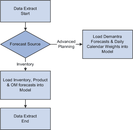

Understanding Data Extract Methods
This diagram illustrates how PeopleSoft Supply Planning extracts forecast data from demand management and inventory transaction systems:
This diagram illustrates how PeopleSoft Supply Planning extracts forecast data from demand management and inventory transaction systems.
Extracting forecast data from transaction systems
When PeopleSoft Supply Planning completes the initial data extraction, it writes the only bucketed unconsumed forecasts for PeopleSoft Inventory items to the Unconsumed Forecast table (PL_FORECAST_UNC). You can maintain the forecast quantities and daily weights for this forecast under the Refine Plan - Forecasting menu.

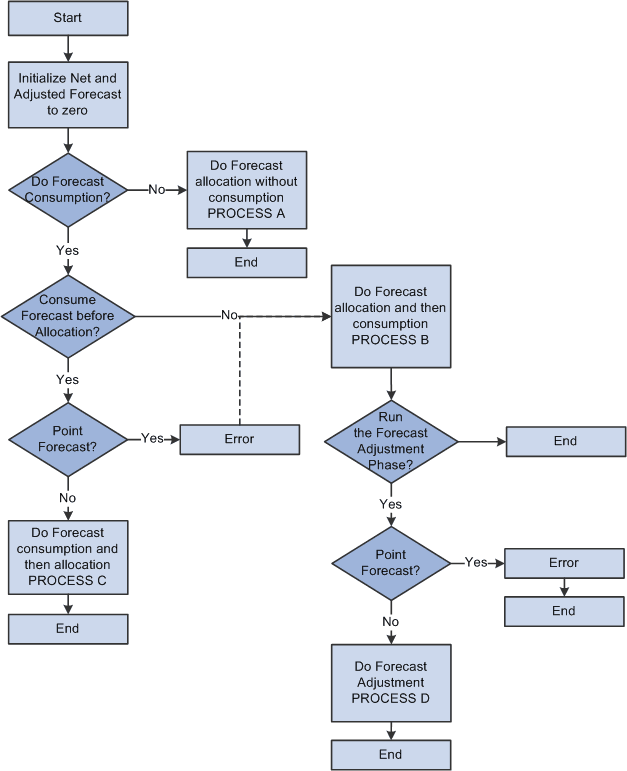

This diagram illustrates different scenarios for processing forecasts in PeopleSoft Supply Planning:
This diagram illustrates different scenarios for processing forecasts in PeopleSoft Supply Planning.
Processing forecasts in PeopleSoft Supply Planning

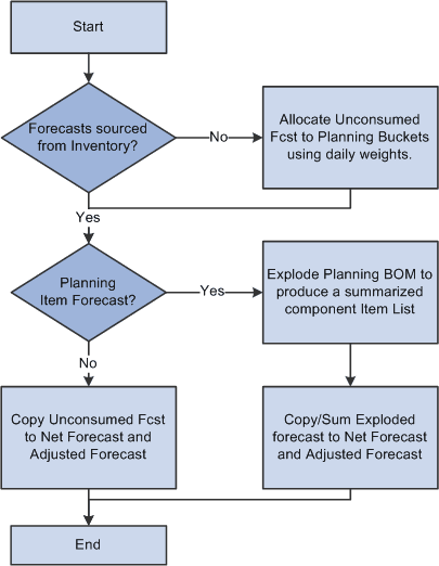

Forecast Allocation Without Consumption (Process A)
If you define a run control to indicate that you do not require forecast consumption, PeopleSoft Supply Planning assumes that the entered forecasts are net forecasts and performs these steps:
This diagram illustrates what steps are performed by PeopleSoft Supply Planning.
Forecast allocation without consumption
PeopleSoft Supply Planning performs these steps for each item in the Unconsumed Forecast table (PL_FORECAST_UNC).

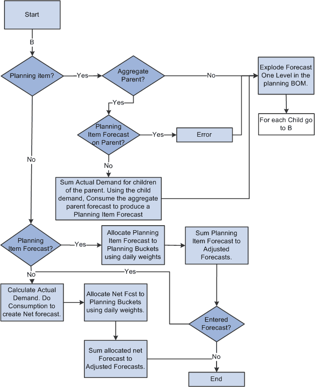

Forecast Allocation Followed by Forecast Consumption (Process B)
In this scenario, PeopleSoft Supply Planning converts forecasts from PeopleSoft Publish Forecast table buckets into PeopleSoft Supply Planning buckets, and then consumes the forecast:
This diagram illustrates how PeopleSoft Supply Planning converts forecasts from PeopleSoft Publish Forecast table buckets into PeopleSoft Supply Planning buckets, and then consumes the forecast:
Forecast allocation followed by forecast consumption

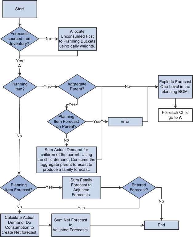

Forecast Consumption Followed by Forecast Allocation (Process C)
In this scenario, PeopleSoft Supply Planning consumes a forecast using period buckets, producing a net forecast for each PeopleSoft Publish Forecast table. PeopleSoft Supply Planning then allocates the net forecast into planning periods.
This diagram illustrates how PeopleSoft Supply Planning consumes a forecast using period buckets, producing a net forecast for each PeopleSoft Publish Forecast table. PeopleSoft Supply Planning then allocates the net forecast into planning periods.
Forecast consumption followed by forecast allocation
