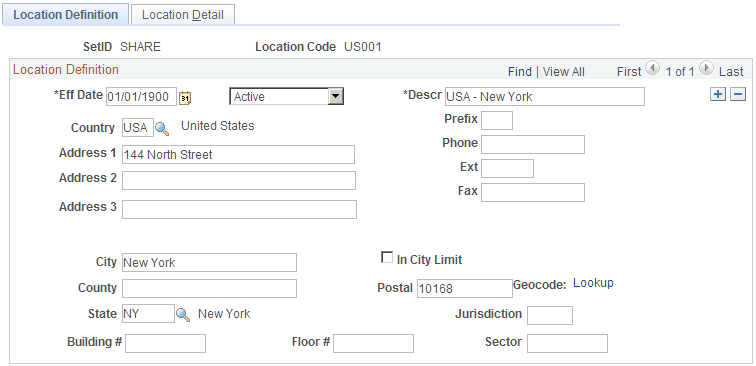

Location - Definition Page
Use the Location Definition page (LOCATION_TBL) to define a location code, such as a branch office or shipping office.
Navigation:
Set Up Financials/Supply Chain, and then Common Definitions, and then Location, and then Setting Up Locations, and then Location Definition
This example illustrates the fields and controls on the Location Definition page. You can find definitions for the fields and controls later on this page.
Enter a description and populate the fields for the telephone and address information.
The address fields that appear are defined on the Address Format page.
Field or Control Description
In City Limit
Select if you use a third-party tax provider product and if you need to access additional city tax information.
Note: The In City Limit is not used by the Vertex O Series tax solution.
Alternate Character Set
Click to access a page where you can enter or display (or both) field values in an alternate character set. This button appears only if you selected the Alternate Character check box on the User Preferences - Overall Preferences page.
Address 2 and Address 3
If not used at this location, you can enter values in these fields to provide more information about the location, such as Printing Division or Western Annex.
Address 4
The space available to display addresses on a page is limited. The Address 4 field will not appear if you select some of the optional address fields on the Address Format page, such as Number 1 or House Type.
GeoCode
This value is used by third-party tax applications to link a location definition to their tax calculation algorithms. If no geocode has been selected, this field displays a Lookup link. Clicking the geocode value or Lookup link accesses the Tax GeoCode Selection page, where you select a geocode value for the location definition.
You must select a geocode for each location definition in order to integrate properly with your third-party tax application.
Error messages that appear for this field are issued by the third-party application, and more information is provided in the third-party application documentation.
