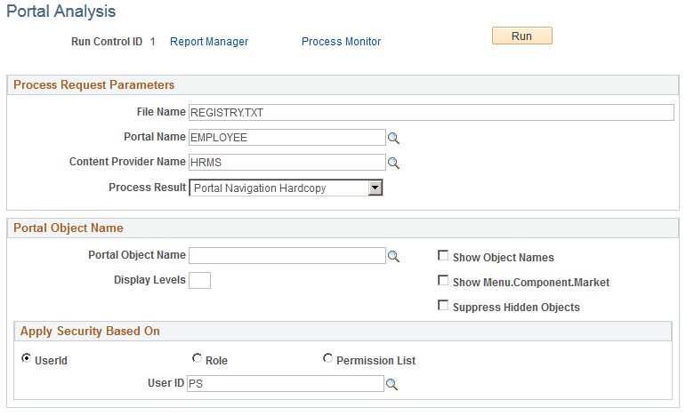

This example illustrates the fields and controls on the Portal Analysis page. You can find definitions for the fields and controls later on this page.
Field or Control Description
File Name
Enter the name of the file you want the process to create and populate with the portal analysis. The process will distribute the file to the reporting repository.
Portal Name
Enter the name of the portal you want to analyze.
Content Provider Name
Select HRMS in the Content Provider Namefield to analyze HCM portal navigation.
Process Result
Select the processing result from the following options:
  • Portal/Menu Path
    The result creates a straight list of the portal and menu paths. This result does not use the other values on the page so the system hides them when you select this option.
  • Portal Navigation Hardcopy
    This result gives you more options and can create a more hierarchical view of the navigation.
Portal Object Name
Select the portal object name.
Display Levels
Enter the number of portal levels to print. Leave empty to print all the levels.
Show Object Names
Select to display the object names of the CREFs or folders.
If you leave this check box deselected, the process will just display the labels.
Show Menu.Component.Market
Select to display the CREFs menu, component, and market information.
Suppress Hidden Objects
Select to keep the process from including hidden objects.
If you leave this check box deselected, the system identifies hidden objects with the following text preceding the object name: *hidden*.
Apply Security Based On
Select to analyze the portal navigation for the security access assigned to a UserId, Role, or Permission List. Select the userID, role, or permission list to use.
