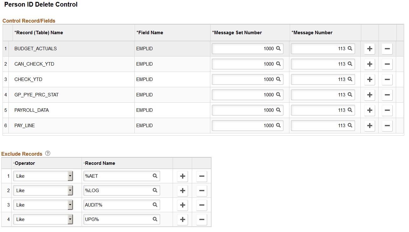

This example illustrates the fields and controls on the Person ID Delete Control page.

Control Record/Fields
The ID on each of the following payroll control records and the associated messages are delivered predefined as priority data for HCM:
  • GP_PYE_PRC_STAT
  • PAY_LINE
  • CHECK_YTD
  • CAN_CHECK_YTD
  • PAYROLL_DATA
  • BUDGET_ACTUALS
Although the administrator can remove any of the delivered records, enabling the ability to delete person IDs that have data related to this data, Oracle recommends that you do not delete the rows of predefined payroll control records. Keep these as your base ID delete control records for individual IDs and define additional priority data as necessary.
You can override the record controls identified here on a case by case basis on the PeopleSoft Human Resources Administer Workforce: Person ID Delete Page.
To define an additional control record, or to add an additional field from the same record, click the Add a new row (+) button at the level where you want to insert it. The system enters a new row and renumbers the sequence of control records. Select the record name, field name, and message data. The new row is not added until you click Save.

Exclude Records
Use this section to specify specific records to be excluded from the deletion process so the data is retained. This enables you to retain data in specific tables, including audit and archived tables.
Field or Control Description
Operator
Select the operator that defines the relationship of the rule to the record name value. Options include Equal or Like. Select Equal to exclude the specific record that you specify. Select Like to exclude records with record names like the string that you specify.
Record Name
Enter the record name to be excluded from the change or delete process. Enter the record name when the operator value is Equal. Use a wild character (%) with a partial record name when the operator is Like.
Note: When using the Like operator, you should include the % wild character as a prefix or suffix within the Record Name field. For example, entering UPG% indicates that they process should not consider any records that begin with UPG when identifying records for deletion. Likewise, entering %UPG tells the process to not look at any records that end in UPG. Special characters are not allowed except the percentile % wild card.
Important:
Users with the ID Delete User role can choose whether to check for excluded records when running the Person ID Delete process from the PeopleSoft Human Resources Administer Workforce: Person ID Delete Page. If a user chooses not to check, then all person data is deleted regardless of your exclusion rules.
