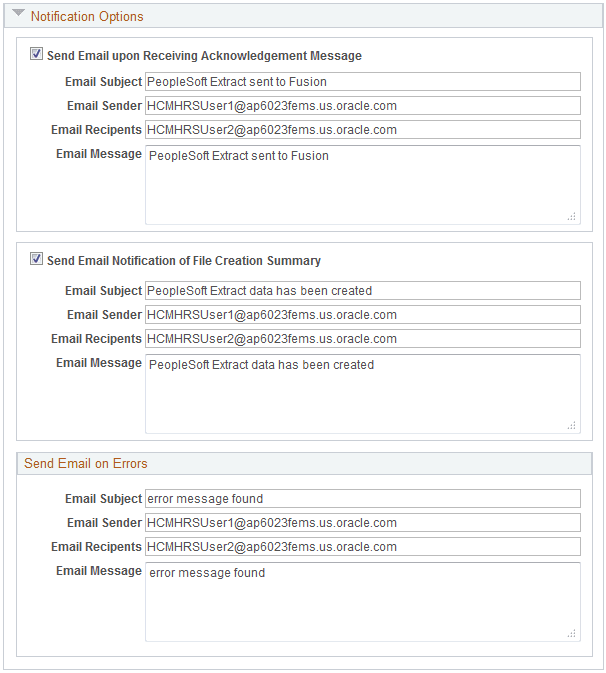

Notification Options
The types of notifications that you can enable in this group box depend on whether the integration is inbound or outbound. Selecting any of the “Send Email” check boxes enables you to enter the subject, sender, recipients, and message text for the associated notification email.
Field or Control Description
Send Email on Successful File Load
Select to send a notification email whenever incoming files are loaded successfully.
Send Email upon Receiving Acknowledgment Message
Select to send a notification email whenever the system receives an acknowledgement from Fusion that the outgoing file was received.
Send Email Notification of File Creation Summary
Select to send a notification email with a summary of information regarding the creation of each outgoing zip file.
Oracle PeopleSoft delivers Notification Composer Framework to manage the setup and administration of all notifications in one central location.
Once you have adopted the Notification Composer feature, you must use it to create new notifications and manage your existing notifications.
Notifications delivered with HCM Image 47 or later must use Notification Composer.
For more information about Notification Composer Framework, see Enterprise Components: Understanding Notification Composer.
Send Email on Errors
Unlike the other notifications, emails sent when the system encounters errors with the sending or receiving of zip files are not optional. Enter the subject, sender, recipients, and message text for the error message.

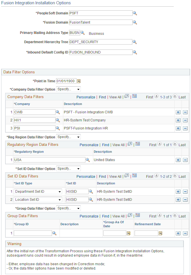

Fusion Integration Installation Options Page
Use the Fusion Integration Installation Options page (FT_INSTALL) to define the domains, configuration, and data filter options for your Fusion integration.
Navigation:
Set Up HCM, and then Common Definitions, and then Fusion Integrations, and then Talent/Workforce Compensation, and then Fusion Installation Options, and then Fusion Integration Installation Options
This example illustrates the fields and controls on the Fusion Integration Installation Options page.
This page is required setup for Fusion integration.
PeopleSoft Domain
The value in this field should be PSFT to correspond to the values used in the Application Integration Framework. All of the DVMs and XREFs are delivered with the PSFT domain value.
If you change this value, then you must update the PeopleSoft domain definitions for all of the corresponding DVMs and XREFs.
Fusion Domain
This value in this field should be FusionTalent to correspond to the values used in the Application Integration Framework. All of the DVMs and XREFs are delivered with the FusionTalent domain value.
If you change this value then you must update the Fusion domain definitions for all of the corresponding DVMs and XREFs.
Primary Mailing Address Type
Select the address type that the system uses to determine the primary mailing address for employees.
The system uses this value as the default mailing address on the Fusion employee HR address record. In addition, the system uses this value to set the Person Address default in Fusion.
Department Hierarchy Tree
The system uses the value you enter here to determine the manager for employees in specific cases.
The system determines an employee’s manager based on:
  1. The supervisor ID in the Job record.
  2. The manager of the department if there is no supervisor ID in the Job record.
  3. If the manager from steps 1 and 2 is the same as the employee, the system uses the department hierarchy tree specified here to find the parent department and retrieve the manager of the parent department.
Inbound Default Config ID (inbound default configuration ID)
Enter the ID of the default inbound configuration you want the system to use for inbound web service calls.
See Receiving Data from Fusion.
Data Filter Options
The fields in this group box enable you to filter the employee data that the system extracts, transforms, and sends to Fusion when you run the FT_EXTRACT process.
Control data is not affected by these filter options.
See Send HR Data to Fusion Page.
Point in Time
The system extracts and publishes data only for employees whose HR Status is Active as of the date you enter here or later.
Company Data Filter Option
Define how the system filters by company when it extracts and publishes data to Fusion. Values are:
All: The system extracts and publishes data for all companies.
Specify…: The system extracts and publishes data only for the companies that you specify in the Company Data Filters grid, which becomes available when you select this value.
Reg Region Data Filter Option (regulatory region data filter option)
Define how the system filters by regulatory region when it extracts and publishes data to Fusion. Values are:
All: The system extracts and publishes data for all regulatory regions.
Specify…: The system extracts and publishes data only for the regulatory regions that you specify in the Regulatory Region Data Filters grid, which becomes available when you select this value.
Note: Currently, it is only possible to specify US regulatory regions.
Set ID Data Filter Option
Define how the system filters by set ID when it extracts and publishes data to Fusion. Values are:
All: The system extracts and publishes data for all set IDs.
Specify…: The system extracts and publishes data only for the set IDs that you specify in the Set ID Data Filters grid, which becomes available when you select this value.
Group Data Filter Option
Define how the system filters by Groups when it extracts and publishes data to Fusion. Values are:
All: The system extracts and publishes data for all groups.
Specify...: The system extracts and publishes data only for the group IDs that you specify in the Group Data Filters grid, which becomes available when you select this value.
Note: The system extracts and publishes data only for employees whose HR status is Active on or before the date in the Refinement Date field.
In selecting your data filters, make sure that the assignment supervisors for the filtered employees also meet your filter criteria. If the assignment supervisors do not meet the filter criteria, the system automatically selects the employees that reference those assignment supervisors for data transformation.
To identify the supervisors of the filtered employees, you need to reference those employees’ assignment records.

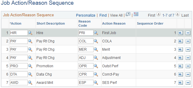

Job Action/Reason Sequence Page
Use the Job Action/Reason Sequence page (FT_JOB_ACT_SEQ) to define the inbound interface sequence order for associated job actions and reasons.
Navigation:
Set Up HCM, and then Common Definitions, and then Fusion Integrations, and then Talent/Workforce Compensation, and then Fusion Inbound Sequence, and then Job Action/Reason Sequence
This example illustrates the fields and controls on the Job Action/Reason Sequence page.
This page is required only for receiving inbound compensation data from Fusion. Fusion can send multiple job actions and reasons back from Workforce Compensation. This page defines the sequence in which the system processes changes. The sequence is by action and action reason (reason code). Add all of the job actions and corresponding reason codes used by the inbound process.
