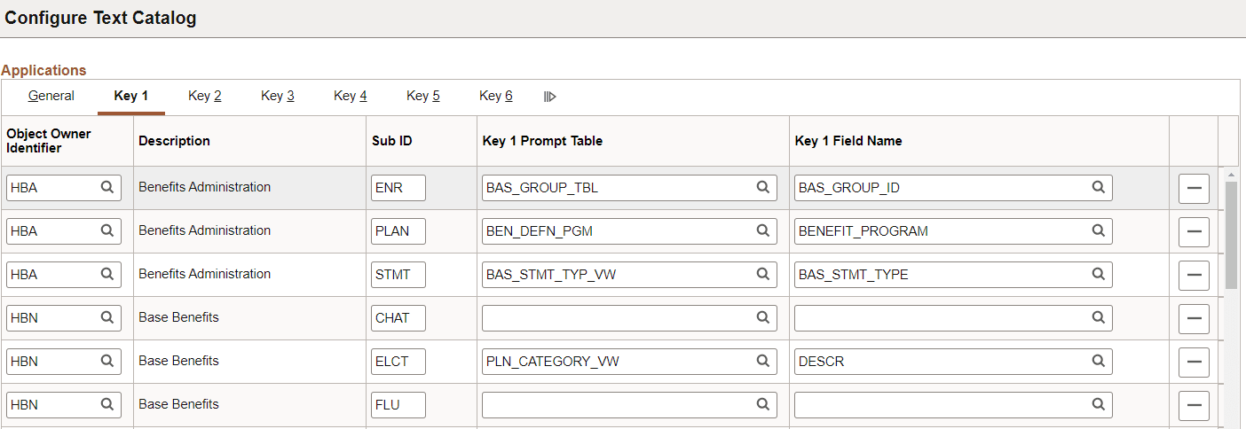

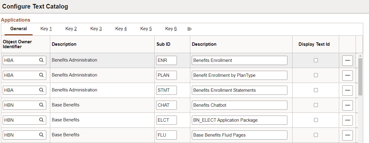

Configure Text Catalog Page
Use the Configure Text Catalog page (HR_SSTEXT_CFG) to configure the text catalog for an application. Designate keys that are used to store and retrieve text catalog entries on the Configure Text Catalog: Key 1 through Configure Text Catalog: Key 6 pages.
Navigation:
Set Up HCM, and then Common Definitions, and then Text Catalog and Notepad, and then Configure Text Catalog, and then Configure Text Catalog
This example illustrates the fields and controls on the Configure Text Catalog page: General tab. You can find definitions for the fields and controls later on this page.
Use this page to add or remove applications from the text catalog and to configure options that affect the operation of the text catalog within an application. The page shot above shows the PeopleSoft HCM applications that are delivered with the text catalog feature enabled.
Field or Control Description
Object Owner Identifier and Description
Select an object owner. The system will display the description of the object owner.
Display Text Id
Select to have the system identifiers of the text entry appear instead of the corresponding text. You can use this option to find out which text ID corresponds to a particular piece of text that you want to modify.
Access the Text Catalog page: Key tabs.
The Key 2, Key 3, Key 4, Key 5, and Key 6 tabs are identical in appearance and usage to the Key 1 page (Set Up HCM, and then Common Definitions, and then Text Catalog and Notepad, and then Configure Text Catalog, and then Configure Text Catalog and access the appropriate key tab).
This example illustrates the fields and controls on the Configure Text Catalog page: Key tabs. You can find definitions for the fields and controls later on this page.
Configure Text Catalog page: Key 1 tab
Key 1 (2, 3, 4, 5, or 6) Prompt Table
Select the object name of the prompt table that defines the values by which the text catalog is partitioned for an application.
The values in this prompt table appear when a text catalog entry is defined and modified. You select the value that pertains to the context in which the entry appears on self-service pages or notifications.
Key 1 (2, 3, 4, 5, or 6) Field Name
Select the field in the prompt table that contains the value that appears in the prompt list for this key.
If you enter a value for the prompt table, you must also enter a value for the field name in the same row.

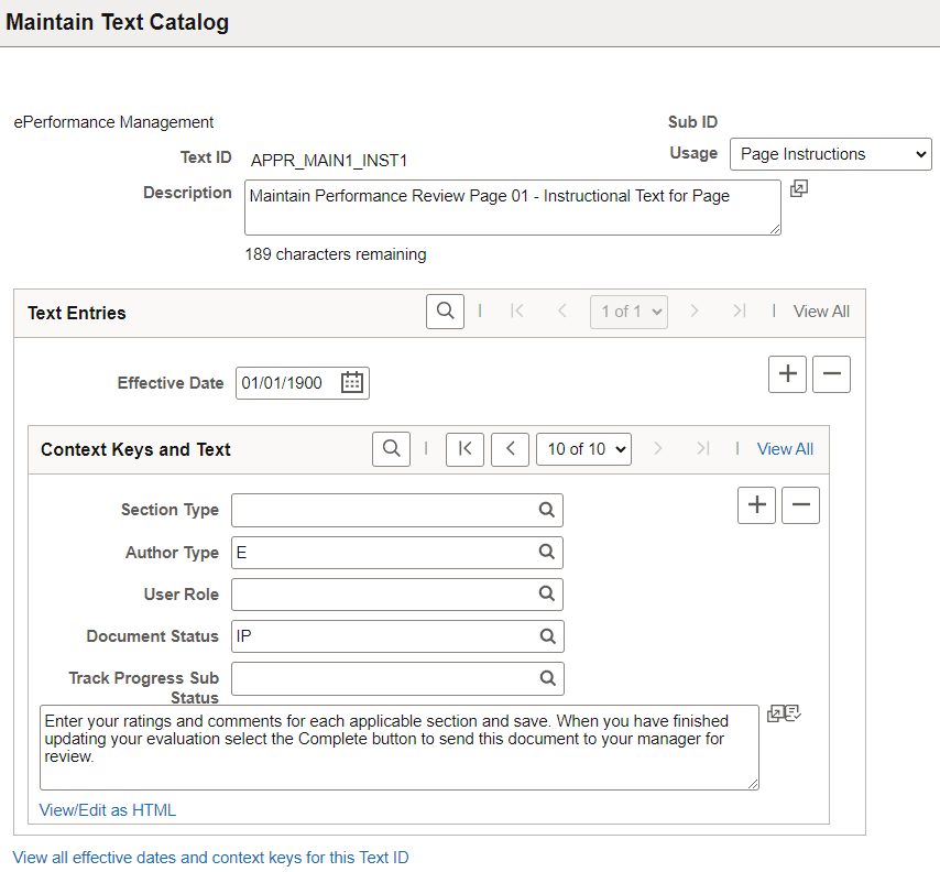

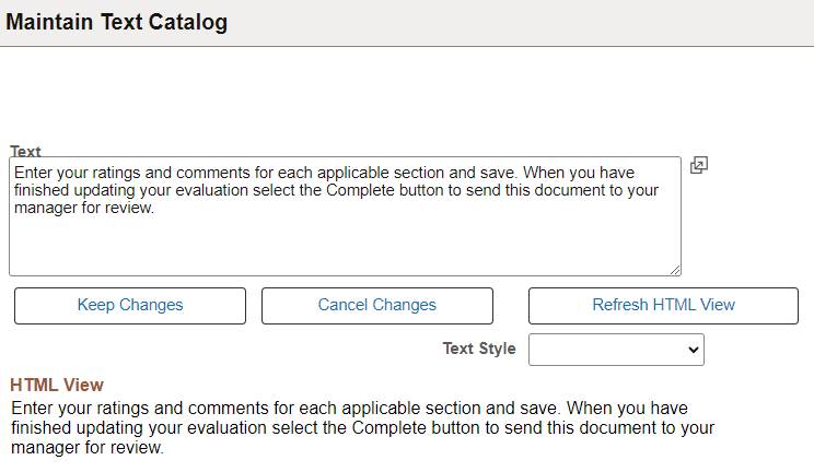

Maintain Text Catalog Page
Use the Maintain Text Catalog page (HR_SSTEXT_TEXT) to define text catalog entries, and define the values for context-sensitive keys.
Navigation:
  • Set Up HCM, and then Common Definitions, and then Text Catalog and Notepad, and then Maintain Text Catalog, and then Maintain Text Catalog
  • Set Up HCM, and then Product Related, and then ePerformance, and then Text Catalog, and then Maintain Text Catalog, and then Maintain Text Catalog
  • Set Up HCM, and then Product Related, and then eBenefits, and then Maintain Text Catalog, and then Maintain Text Catalog
  • Set Up HCM, and then Product Related, and then Compensation, and then Utilities, and then Compensation Alert Text, and then Maintain Text Catalog
This example illustrates the fields and controls on the Maintain Text Catalog page. You can find definitions for the fields and controls later on this page.
Context Keys and Text
The context keys that appear on this page are determined by the text catalog configuration for the application, which will display up to six keys. Use the context keys to target the message or text to a particular audience or specify the conditions under which the text is appropriate.
A blank value for any key is a wild card and means that the entry appears in all contexts of the key.
For example, the page shot above shows a configuration of an instructional text for the ePerformance application. The text that is defined in the free-form box applies only to the author type of employees (E) and only when the document status is in progress (IP).
For each text ID and effective date combination, define a complete wild card entry in which you leave all key fields blank. This entry, known as the root entry, is the default text entry that's used when no section type, author type, user role, or document status is specified.
View/Edit as HTML
Click to view and edit the HTML tags if the text will appear in an HTML area on the page.
See Maintain Text Catalog - HTML View Page.
HTML tags can only be used for text catalogs in the HTML area. It cannot be used anywhere else.
Text Substitution
The text strings that are substituted for specific tokens, such as %1 and %2, are different for each application that uses substitution in the text catalog. They are delivered with the application.
Token substitution in the text catalog works in the same way as in the PeopleTools Message Catalog. You supply the values for the tokens in a PeopleCode function call at runtime. The values are replaced by parameters in the PeopleCode when the text is rendered on performance documents. To use this feature, you must know PeopleCode.
If you want to update the delivered text IDs such that the substitution tokens take on a different meaning or are resequenced, you also need to make corresponding changes to the PeopleCode that calls the text catalog feature retrieval functions, since this copies supplier values to use in place of the tokens.
Text Limits
Although the text catalog framework allows you to enter long text entries, the page element where the text appears at runtime can have a lower character limit, resulting in truncated text. Any time you change a delivered text catalog entry, be sure to test your change. If the entry is truncated, on the runtime page, you must shorten your text.
See PeopleTools: PeopleCode Developer's Guide.
Use the Maintain Text Catalog - HTML View page (HR_SSTEXT_HTML) to view text catalog entries as HTML.
Navigation:
Click the View/Edit as HTML link on the Maintain Text Catalog page.
This example illustrates the fields and controls on the Maintain Text Catalog - HTML View page. You can find definitions for the fields and controls later on this page.

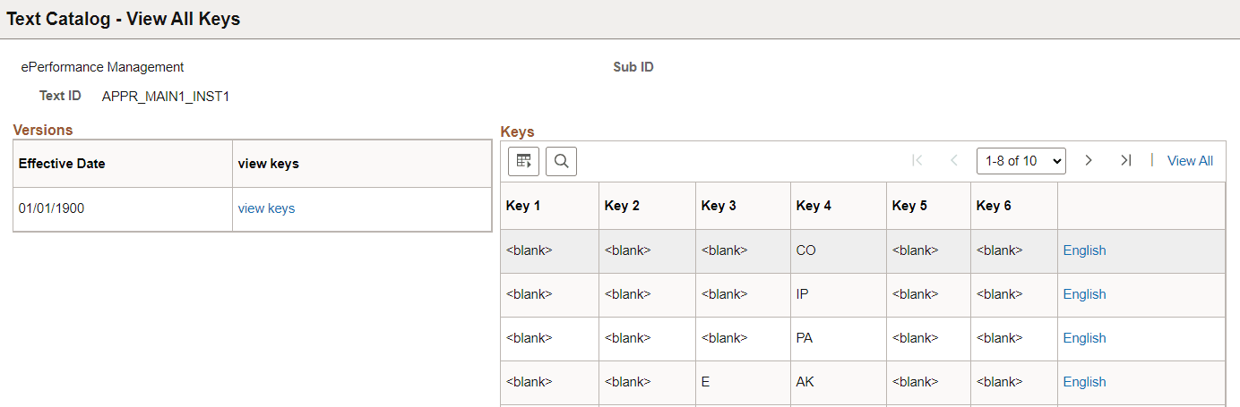

Text Catalog - View All Keys Page
Use the Text Catalog - View All Keys page (HR_SSTEXT_ALLKEYS) to view versions and context-key entries for a particular text ID and effective date combination by clicking the view keys link for the desired effective date.
Navigation:
Click the View all effective dates and context keys for this Text ID link on the Maintain Text Catalog page or the Test Text Catalog page.
This example illustrates the fields and controls on the Text Catalog - View All Keys page. You can find definitions for the fields and controls later on this page.
The Versions group box lists all effective-dated versions of the selected text ID.
Click the view keys link to list each set of context keys that is associated with the selected version. Click the language link to view the text that is associated with the context keys for the indicated language.

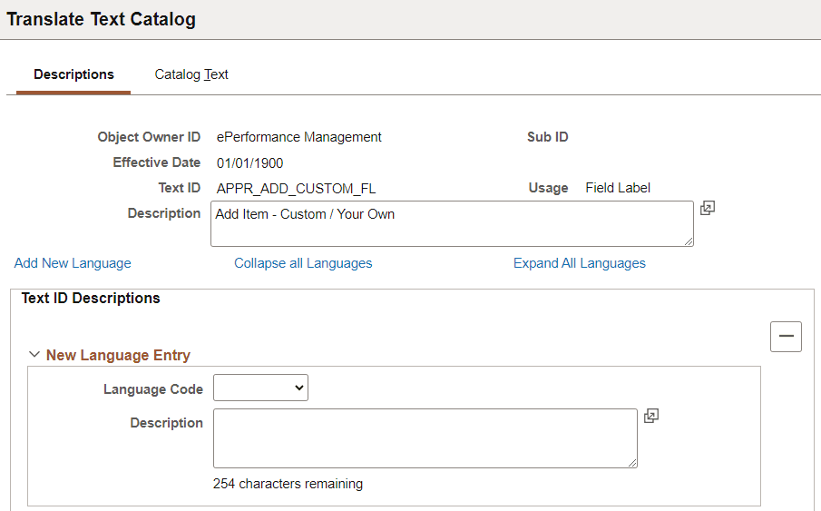

Translate Text Catalog - Descriptions Page
Use the Translate Text Catalog - Descriptions page (HR_SSTEXT_LANG) to select and describe the languages into which a text catalog entry is translated.
Navigation:
Set Up HCM, and then Common Definitions, and then Text Catalog and Notepad, and then Translate Text Catalog, and then Descriptions
This example illustrates the fields and controls on the Translate Text Catalog - Descriptions page. You can find definitions for the fields and controls later on this page.
Use this page to view a text catalog entry and the languages into which it is translated. The Collapse all Languages and Expand All Languages enable you to control the way the list of languages appears. You can add and remove languages on this page, but you cannot enter translation text.

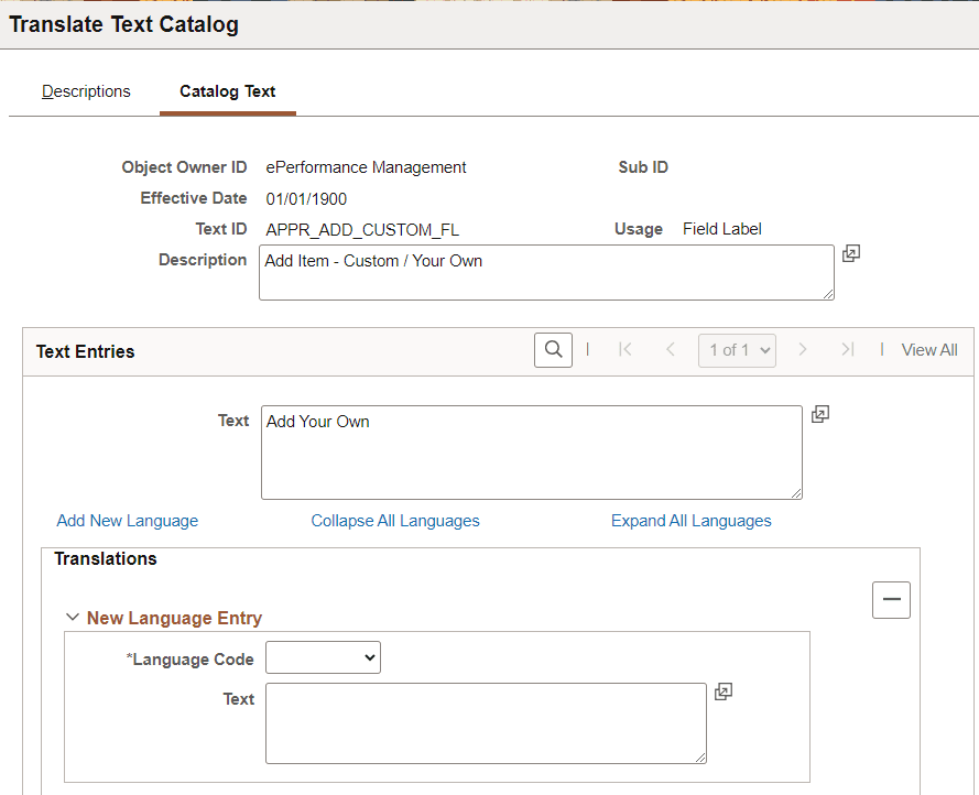

Translate Text Catalog - Catalog Text Page
Use this page to Translate Text Catalog - Catalog Text page (HR_SSTEXT_LANG2) to enter translations for text catalog entries.
Navigation:
Set Up HCM, and then Common Definitions, and then Text Catalog and Notepad, and then Translate Text Catalog, and then Catalog Text
This example illustrates the fields and controls on the Translate Text Catalog - Catalog Text page. You can find definitions for the fields and controls later on this page.
The Collapse all Languages and Expand All Languages enable you to control the way the list of languages and translation entries appears. You can add and remove languages on this page and view the text you are translating.

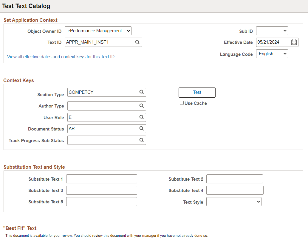

Test Text Catalog Page
Use the Test Text Catalog page (HR_SSTEXT_TEST) to test the text retrieval for a text ID, using any combination of key values.
Navigation:
Set Up HCM, and then Common Definitions, and then Text Catalog and Notepad, and then Invoke Text Catalog API, and then Test Text Catalog
Set Up HCM, and then Product Related, and then ePerformance, and then Text Catalog, and then Test Text Catalog, and then Test Text Catalog
This example illustrates the fields and controls on the Test Text Catalog page. You can find definitions for the fields and controls later on this page.
This page enables you to enter parameters for testing how the entries in the text catalog appear on self-service pages, given a set of parameters that you enter.
To test the text retrieval:
  1. Enter the text ID for the text.
  2. (Optional) Enter values for any key fields. The content keys that appear correspond to the application keys (up to six) that you configure on the HR Notepad Configuration - Configure Keys page.
    • If you leave all key fields blank, the system returns the root text when you click the Test button.
    • If you enter values for key fields, the system searches for the text with the best fit.
  3. (Optional) Enter values in one or more of the Substitution Text fields.
    When you click the Test button, the system replaces the variable (%1, %2, %3, %4, and %5) in the text entry with the value that you enter here.
  4. (Optional) Select a text style to see the returned text rendered in a particular HTML style.
    This features helps you visualize how the text appears on the self-service page. Values are PAADDITIONALINSTRUCTIONS (additional instructions), PABOLDTEXT (bold text), PAERRORTEXT (error text), PAPAGEINSTRUCTIONS (page instructions), and PAPAGETITLE (page title format).
  5. Click the Test button.
    The text entry that best matches the search criteria and context keys for the selected text ID appears.

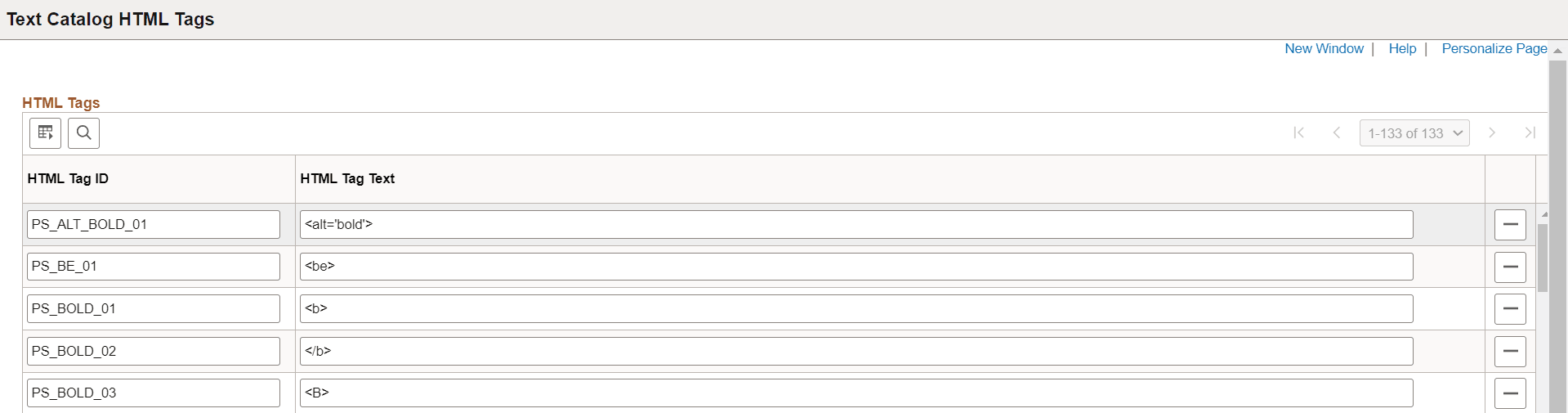

Text Catalog HTML Tags Page
Use the Text Catalog HTML Tags page (HR_SSTEXT_TAGS) to maintain HTML tags for use in text catalog entries.
Navigation:
Set Up HCM, and then Common Definitions, and then Text Catalog and Notepad, and then Text Catalog HTML Tags, and then Text Catalog HTML Tags
This example illustrates the fields and controls on the Text Catalog HTML Tags page. You can find definitions for the fields and controls later on this page.
All HTML tags that are used in text catalog entries must be specified on this page. For security purposes, HTML tags need to be assessed for XSS vulnerability before they are added.
For more information, refer to the HTML Tags in Text Catalog Entries section in this topic.
