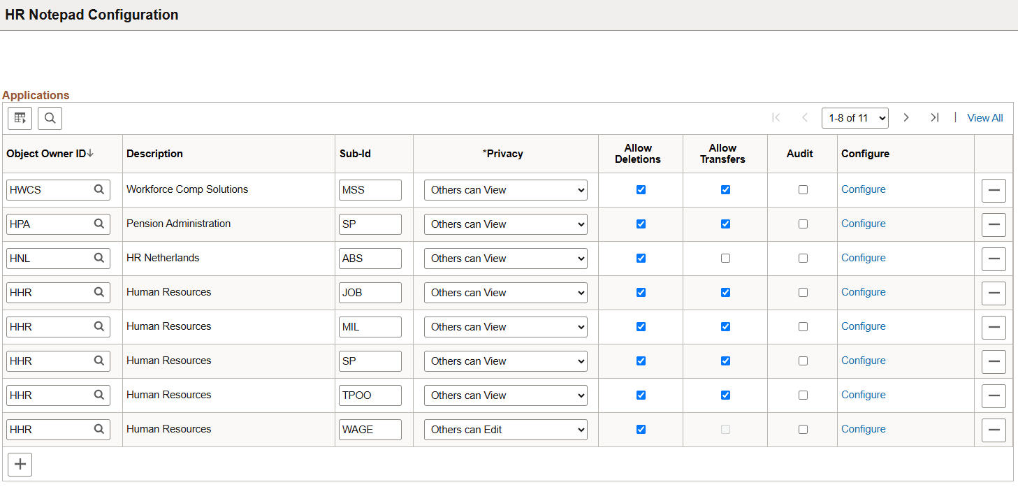

HR Notepad Configuration - Applications Page
Use the HR Notepad Configuration - Application page (HR_NP_CONFIG_HDR) to configure the HR Notepad for use by an application.
Navigation:
Set Up HCM, and then Common Definitions, and then Text Catalog and Notepad, and then Configure HR Notepad, and then HR Notepad Configuration
This example illustrates the fields and controls on the HR Notepad Configuration - Applications page. You can find definitions for the fields and controls later on this page.
Field or Control Description
Object Owner ID and Description
Select an object owner. The system will display the description of the object owner.
Privacy
Select from these options:
  • Private: Only the owner of the note can access the note.
  • Others can View: Anyone can view existing notes in this partition, but only the note owner can update an existing note.
  • Others can Edit: Anyone can view and edit existing notes in this partition.
Allow Deletions
Select to permit users to delete notes.
Allow Transfers
Select to permit users who entered and therefore are the owner of a note to transfer ownership of a note to another individual.
Audit
When selected, this check box enables the Audit Changes feature for the partition. The system will automatically retain a history of all changes made to existing notes, including transfers and deletions.
Configure
Click to access to the Configure Keys page.

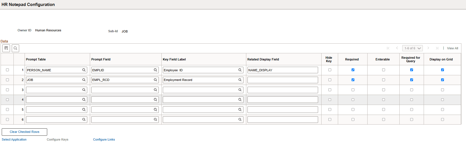

HR Notepad Configuration - Configure Keys Page
Use the HR Notepad Configuration - Configure Keys page (HR_NP_CONFIG2) to set up the keys for storing notes.
Navigation:
Click the Configure link for an application on the HR Notepad Configuration - Select Application page.
This example illustrates the fields and controls on the HR Notepad Configuration - Configure Keys page. You can find definitions for the fields and controls later on this page.
This page is for note pad key configuration and consists of six context key rows. Each row in the grid supports one key configuration requirement.
Prompt Table
Select the table that is used to provide a prompt list and validate the entry when a user enters a value into the key search field in the UI.
Prompt Field
Select the field within the prompt table that is used to provide the values in the prompt list. You must enter a value in this field if you enter a value in the Prompt Table field.
Key Field Label
Select the configurable label that will display on the page for this field.
Related Display Field
Enter the field name for the prompt table that appears in the UI as a related field for the value. This field is optional. If not specified, then there is no related-display field for the context key. For example, you do not usually specify a display field for a date or number context key.
Hide Key
Select to indicate whether this key field is exposed on the UI pages. This field is selected by default.
Required
Select to indicate that this key field is required when adding a note. This field is deselected by default.
Enterable
Select to indicate that the user is permitted to enter a value into this key field in the UI search criteria. This field is selected by default. You might deselect this field in cases which the key is automatically populated by the API and exposed on the UI, but you do not want the user to change it.
Required for Query
Select to indicate that the user must populate the key in the UI search criteria to see the list of notes that meet the search criteria, or to add a new note. This field is deselected by default.
Display on Grid
Select to display the context key value in the list of notes that meet the search criteria. You usually select this check box for any context key that has Required for Query deselected.
Clear Checked Rows
Click this button after you have selected any context key rows for which you want to clear from this configuration. The page will still display the row but the prompt table and field information will be cleared.

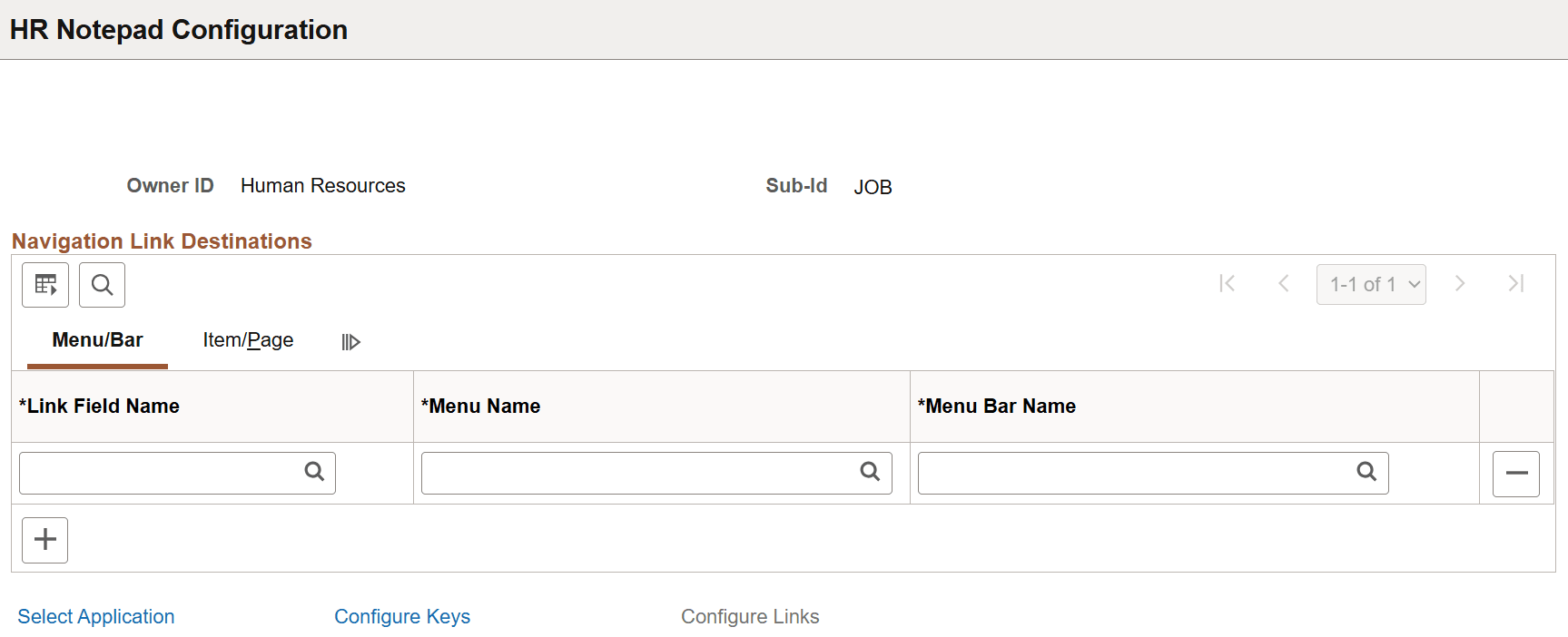

HR Notepad Configuration - Configure Links Page
Use the HR Notepad Configuration - Configure Links page (HR_NP_CONFIG3) to configure the links that appear on application note pages.
Navigation:
Click the Configure Links link on the bottom of the HR Notepad Configuration - Configure Keys page.
This example illustrates the fields and controls on the HR Notepad Configuration - Configure Links page: Menu/Bar tab. You can find definitions for the fields and controls later on this page.
Use this page to define the navigation that takes place when the user clicks one of the navigation links at the bottom of the Notepad UI.
Link Field Name
Select the name of the navigational link. The prompt table for this field is a view of the four navigational fields that are provided on the Note Detail UI. If you do not add a row for a link in the prompt table, the link does not appear on the UI for the application.
Menu Name
Select the name of the menu to which the user is transferred when they click the link. The prompt table for this field is a view of all menus in the database.
Menu Bar Name
Select the name of the menu bar to which the user is transferred when they click the link. The prompt table for this field is a view of all menu bars for the menu specified in the Menu Name field.

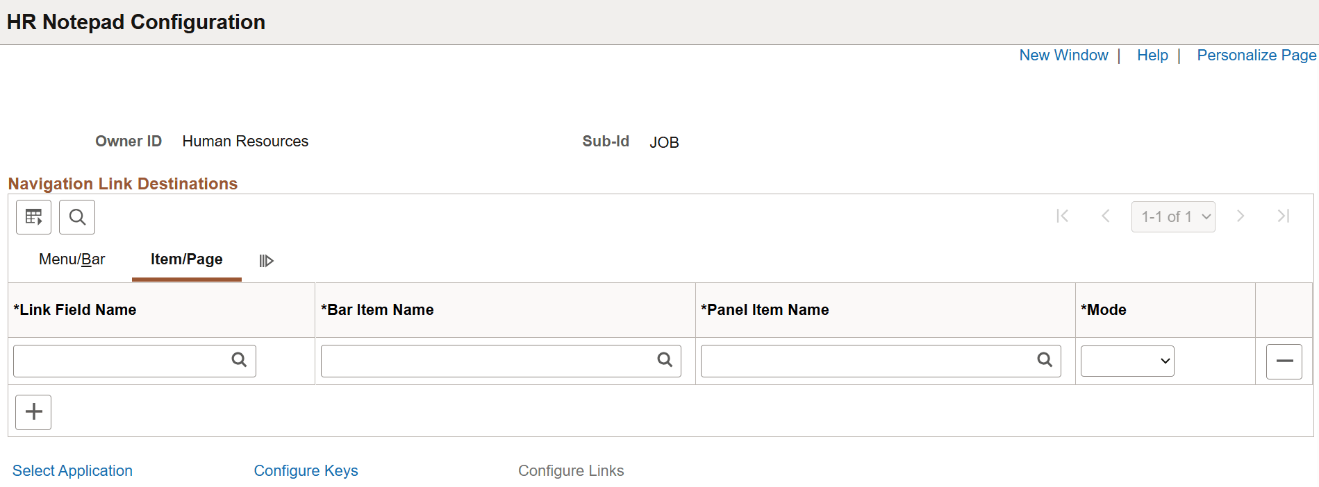

Access the Item/Page tab on the HR Notepad Configuration - Configure Links page.
This example illustrates the fields and controls on the HR Notepad Configuration - Configure Links: Item/Page tab. You can find definitions for the fields and controls later on this page.
HR Notepad Configuration - Configure Links page: Item/Page tab
Link Field Name
Bar Item Name
Select the name of the menu bar item to which the user is transferred when they click the link. The prompt table for this field is a view of all items for the menu bar specified in the Bar Name field.
Panel Item Name
Select the name of the page to which the user is transferred when they click the link. The prompt table for this field is a view of all pages for the bar item specified in the Bar Item Name field.
Mode
Select the operation mode for the page from the values Add, Update/Display, and Correction.

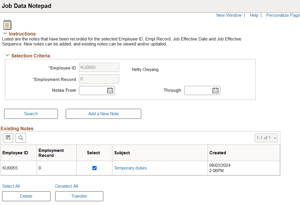

<application page> Notepad Page
Use the <application page> Notepad page (HR_NP_NOTE_SRCH ) to access the notepad page to search for and enter notes.
Navigation:
  • Click the Maintain/View Notes icon on an application page.
  • Click the Execute API button on the Note Pad Tester page.
This example illustrates the fields and controls on the Example of the Notepad page you access through the Job Data pages. You can find definitions for the fields and controls later on this page.
The fields that appear on the notepad page are determined by the notepad configuration.
Selection Criteria
Depending upon the configuration of a page, you may need to select a person to add or view notes. Optionally, enter a Notes From and Through date.
Search
Select to view a list of notes that meet the search criteria.
Add New Note
Select to access the Selected Note page, where you can create a new note.
Existing Notes
This section displays if there are any notes that meet the search criteria. Select the link in the Subject column to open the Selected Note page and view or edit an existing note. If you have ownership of the note, you can make updates to the note. If you do not have ownership (for example, you transferred ownership to another person or someone else entered the note), you cannot edit or delete the note, only view it.

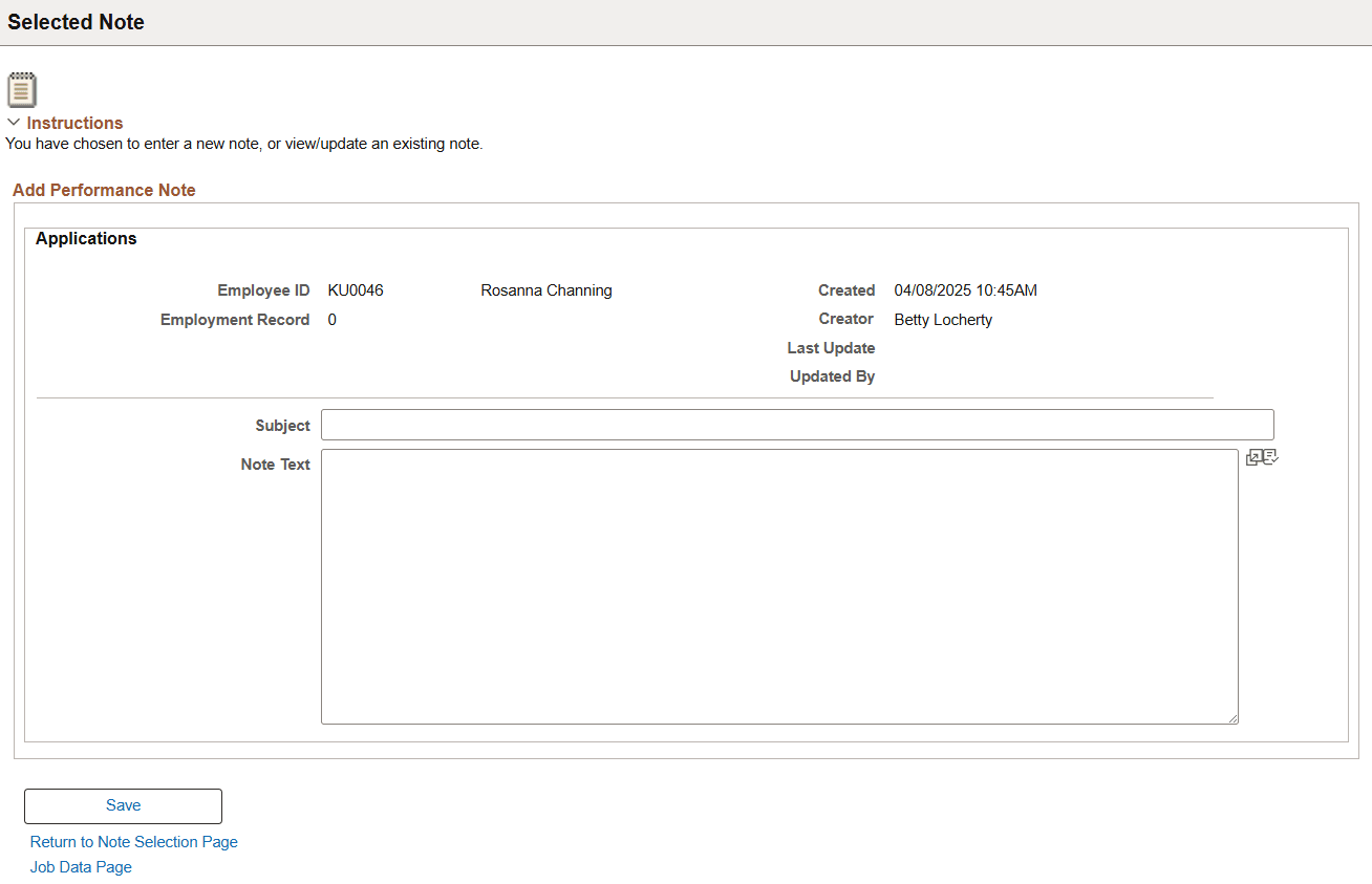

Selected Note Page
Use the Selected Note page (HR_NP_NOTE) to enter or update a note.
Navigation:
Click the Add a New Note button or select the View or Edit this Note link for an existing note on the <application page> Notepad page.
This example illustrates the fields and controls on the Selected Note page. You can find definitions for the fields and controls later on this page.
Selected Note page
Effective Date
The note date for new notes is the effective date that appears on the page. You cannot change the date.
Note: Changing the effective date of the record that is associated with the note does not change the note effective date. As a result, the note becomes inaccessible. For example, if you create a note for a job data row with a January 1, 2009 effective date, the note effective date is also January 1, 2009. If you use correction mode to change the effective date of the job data row to January 20, 2009, the note effective date remains unchanged. When you view the notes for the January 20 row of data, you will see only January 20 notes. Without a January 1 row of data, the original note is inaccessible, and users will not see any indication that the original note ever existed.
Subject
Enter the note subject. This entry appears as the link in the Subject column of the notepad page.
