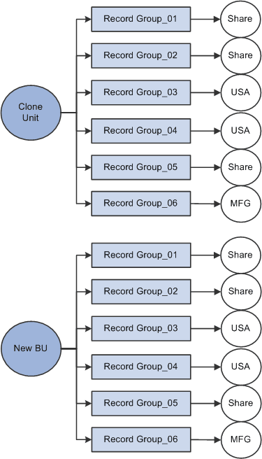

Cloning TableSet Setup From Existing Business Units
With the Clone from Existing Business Unit option, you can clone the TableSet sharing setup of an existing business unit.
When you first enter the Business Unit page, the Clone from Existing Business Unit option is clear. To activate the option, clear any set ID values from the Set ID field and move out of the field.
If you want the tableset sharing for the new business unit that you are creating to mirror that of another business unit you've defined, or if you want the two units to be similar except for a few record groups, enter the business unit that you want to mirror as the cloned business unit. When the record groups are linked to the new business unit, the system assigns each record group the same set ID that is used for the record group by the business unit that you selected as the Clone Unit.
For example, you specify an existing business unit to clone that has the set ID SHARE associated with record groups 01, 02, and 05, set ID USA associated with record groups 03 and 04, and set ID MFG associated with record group 06. The new business unit you create will share these identical set ID values for the same record groups, as shown in this diagram:
Cloning the tableset sharing setup from an existing business unit
