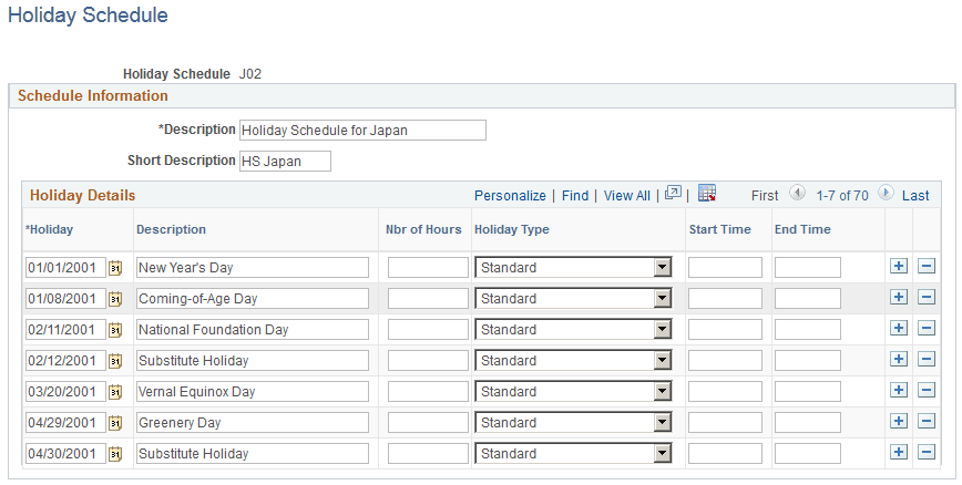

Holiday Schedule Page
Use the Holiday Schedule page (HOLIDAY_SCHED_TBL) to designate holidays for payroll processing.
Navigation:
Set Up HCM, and then Foundation Tables, and then Organization, and then Holiday Schedule, and then Holiday Schedule
This example illustrates the fields and controls on the Holiday Schedule page. You can find definitions for the fields and controls later on this page.
Field or Control Description
Holiday
Enter all of the holiday dates that your organization observes within this schedule.
Nbr of Hours (number of hours)
(Optional) You can specify the number of paid hours for each holiday.
Payroll for North America uses this field to reduce from pay.
Holiday Type
Select a holiday type.
The following values are used in PeopleSoft Payroll for North America:
Canadian: In Payroll for North America, this value designates a Canada statutory holiday.
Standard: In Payroll for North America, this value designates a U.S. holiday or Canada non-statutory holiday.
US Public: Select if the holiday is a public holiday in the U.S.
The following values are used in PeopleSoft Payroll for Hong Kong:
Hong Kong Statutory Holiday: In Payroll for Hong Kong, this value designates a Hong Kong statutory holiday.
Standard: In Payroll for Hong Kong, this value designates a public holiday.
Start Time and End Time
(Optional) You can specify the starting and ending time of each holiday.
Note: Payroll for North America and Global Payroll do not refer to these fields.
