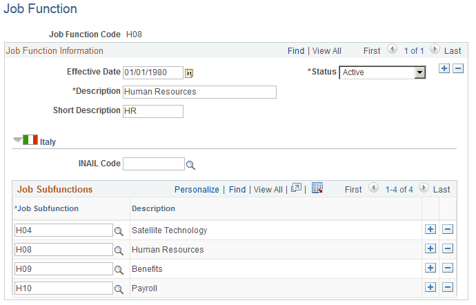

Job Function Page
Use the Job Function page (JOB_FUNCTION_TBL) to set up and define job function codes.
Define the relationship of subfunctions to job functions.
Navigation:
Set Up HCM, and then Foundation Tables, and then Job Attributes, and then Job Function, and then Job Function
This example illustrates the fields and controls on the Job Function page. You can find definitions for the fields and controls later on this page.
Job Function page
(ITA) Italy
Field or Control Description
INAIL Code ( Istituto Nazionale per l'Assicurazione contro gli Infurtuni sul Lavoro code)
The INAIL code classifies jobs according to the level of risk that is associated with the job and the related insurance that is required by the employer.
