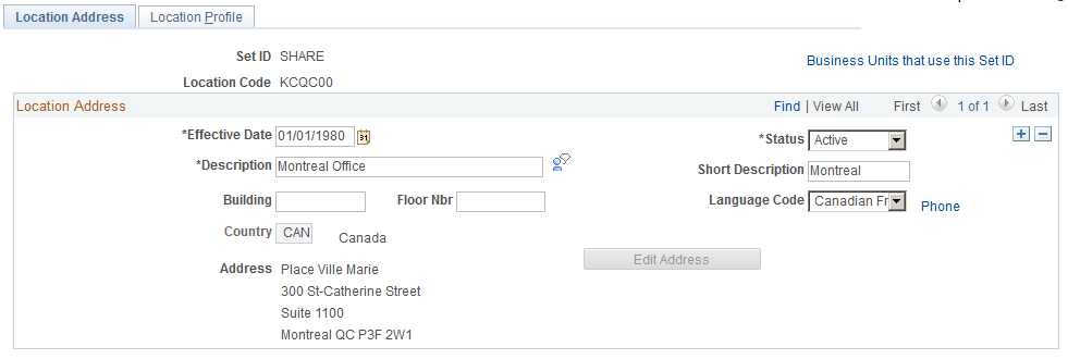

Location Address Page
Use the Location Address page (LOCATION_TABLE1) to enter physical locations in your organization, such as corporate headquarters, branch offices, and remote sales offices.
Navigation:
  • Set Up HCM, and then Foundation Tables, and then Organization, and then Define Location, and then Location Address
  • Set Up HCM, and then Foundation Tables, and then Organization, and then Location BRA, and then Location Address
This example illustrates the fields and controls on the Location Address page. You can find definitions for the fields and controls later on this page.
Field or Control Description
Building
Enter the building location, if applicable. For example, your corporate headquarters might be located in building 4 in an office park.
Floor Nbr (floor number)
Enter the floor number, if applicable.
Language Code
Select the code for the official language used at this location.
Phone
Click this link to enter phone numbers.

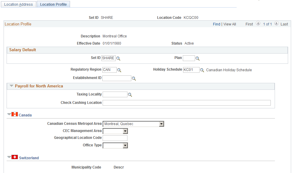

Location Profile Page
Use the Location Profile page (LOCATION_TBL2_GBL) to specify a salary administration plan for the location, as well as tax, establishments and local country information.
Navigation:
  • Set Up HCM, and then Foundation Tables, and then Organization, and then Define Location, and then Location Profile
  • Set Up HCM, and then Foundation Tables, and then Organization, and then Location BRA, and then Location Profile
This example illustrates the fields and controls on the Location Profile page (1 of 2). You can find definitions for the fields and controls later on this page.
This example illustrates the fields and controls on the Location Profile page (2 of 2). You can find definitions for the fields and controls later on this page.
You enter U.S. tax information for Canadian and German locations on this page.
PeopleSoft Payroll for North America references the Tax Location Table for location information, and PeopleSoft Pension Administration references the PeopleSoft Payroll for North America tax information. For more information about the relationship between the Locations component and the Tax Location Table in PeopleSoft Payroll for North America, see the PeopleSoft Payroll for North America documentation.
Set ID and Plan
Select a salary administration plan from the values that you created on the Salary Plan component.
See PeopleSoft Human Resources Manage Base Compensation and Budgeting: Setting Up Salary Plans, Grades, and Steps.
Tying a salary administration plan for a location helps you distinguish currency and cost-of-living differences for workers with the same job code. If you don't need to distinguish salary administration plans by location, leave this field blank.
Note: Select only the plans that are associated with the set ID that you selected on the Define Salary Plan component. If you select a salary administration plan on this page, the system uses that plan as the default value on the Job Data pages for the people in this location. Otherwise, it uses the salary administration plan that you enter on the Job Code Table.
See Classifying Jobs.

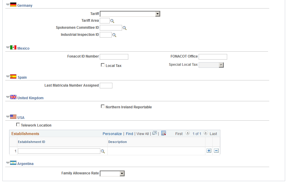

Regulatory Region
Enter the regulatory region that is associated with this location.
Note: (USA) If you select a regulatory region with a country value of USA, the system will hide the Estab ID field. To associate establishments with this location, use the Establishments fields in the USA section of this page.
Holiday Schedule
Select a holiday schedule for this location.
Note: If you use PeopleSoft Payroll for North America, the holiday schedule you select here is the default holiday schedule assigned to workers on the Job Data – Payroll page (JOB_DATA2). If you leave this field blank, the default holiday schedule comes from the Pay Group component. If you use PeopleSoft Global Payroll, the holiday schedule on this page is for informational purposes only; assigned pay groups control the default holiday schedule for processing.
See Setting Up Holiday Schedules.
Establishment ID
Select an establishment ID to associate with this location.
Note: (USA) If you select a Reg Region value with a country value of USA, the system hides this field. Set up establishments for U.S. locations in the USA section of this page.
Taxing Locality and Check Cashing Location
Select a taxing locality and check cashing location. This field is for information only.
(CAN) Canada
Canadian Census Metropol Area (Canadian Census Metropolitan Area)
Select the Canadian Census Metropolitan Area (CMA) code that is prescribed by Statistics Canada for this location. CMA refers to the main labor market area of an urban core with a population of at least 100,000. This field is required.
CEC Management Area (Canada Employment Center Management Area)
Select from the list of options.
Geographical Location Code
Enter the geographic location code as defined by Statistics Canada.
(CAN) If the Official Languages Act applies to your organization, use the information in the Geographic Location Code, Office Type, TBS Office Code, and National Capital Region fields as part of the Official Languages reports (PER102CN and PER108CN) that you submit to the Canadian government. If this is a military installation, the geographic location code entered on the first page of the Military Location component, is copied to the Geographical Location code in the Canada section.
See PeopleSoft Human Resources Meet Regulatory Requirements: Understanding Regulatory Requirements for Canada.
(CHE) Switzerland
Municipality Code
The default value is the municipality code that corresponds to the postal code of the location address. You can select a different code from the list of valid municipality codes for the canton that this location is in.
(DEU) Germany
Tariff
Enter the tariff, or the type of business conducted at this location, such as banking, retail industry, printing, or wood processing.
Industrial Inspection ID
Select the ID for this location from the list of values, if appropriate. Industrial inspection codes are included on Incident and Illness Reports that record the worker accidents and illnesses incurred on the job in the Monitor Health and Safety business process.
When you enter a person's location on the Job Data pages, the Tariff and Tariff Area values appear by default from the Locations component, based on the values that you entered on this component for the location.
When you enter a person's location and labor type on the Job Data pages, the system populates the Spokesman Committee ID and Works Council ID fields. These values are based on the person's location in the Work Location page (JOB_DATA1) and the value of the Labor Type (Management or Non-Management) in the Job Labor page (JOB_LABOR).
See PeopleSoft Human Resources Manage Labor Administration: Understanding the Works Councils Approval Business Process.
(MEX) Mexico
Fonacot ID Number
Enter the FONACOT ID for your location. FONACOT is a consumer fund for employees.
FONACOT Office
Identify the nearest FONACOT office for your location.
Tax Local
Select this check box if the location of the state is Chihuahua.
Special Local Tax
If the location of the state is Chihuahuathis field will default to Ciudad Juarez.
(ESP) Spain
Last Matricula Number Assigned
The Spanish government requires employers to assign each people a unique matricula number, which is used for government reporting. To avoid duplication of numbers, this field updates and stores the last matricula number assigned.
(GBR) United Kingdom
Northern Ireland Reportable
Select if this is a Northern Ireland reportable location. Indicates that people in this location are to be included in the community background report (Fair Employment Monitoring Return) that is provided for Northern Ireland.
USA
Telework Location
Select if this establishment allows workers to work remotely.
Establishments
Select one or more establishment IDs for this location.
Use the establishment-location relationship for affirmative action planning, EEO (Equal Employment Opportunity), OSHA (Occupational Safety and Health Administration), and other U.S. federal reporting regulations.
Only establishments with an effective date as of the location's effective date are available.
Assign locations and establishments to people on the Job Data - Work Location page. The system will only enable you to select an establishment associated with the location you select.
Note: If an establishment's Description is blank, the establishment has become inactive since you initially assigned it to this location.
Note: You can view the locations associated with an establishment on the Establishment Address page.
(DEU) German Public Sector
Municipality
Specify the municipality for locations used in German Public Sector.
See Also PeopleSoft Human Resources Manage German Public Sector: Municipality Table Page
(ARG) Argentina
Family Allowance Rate
Select the family allowance rate from these values: General, Zone 1, Zone 2, Zone 3 and Zone 4.
