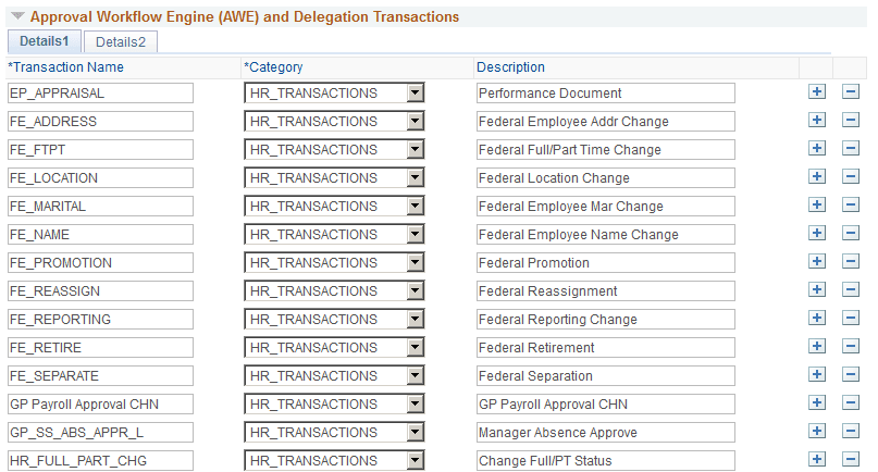

This example illustrates the fields and controls on the Workflow Transactions page: Details1 tab (2 of 3). You can find definitions for the fields and controls later on this page.

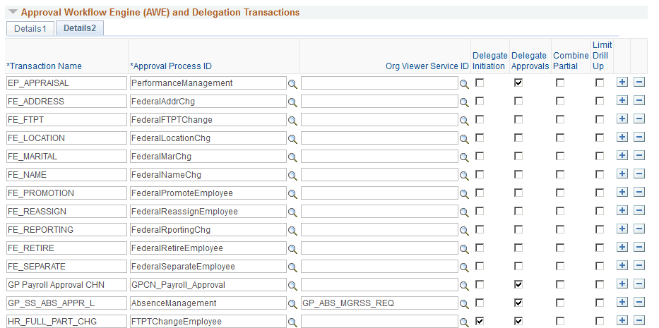

This example illustrates the fields and controls on the Workflow Transactions page: Details2 tab (3 of 3). You can find definitions for the fields and controls later on this page.
When implementing the Delegation framework, you must register all self-service transactions. Only the registered workflow transactions that you enable for delegation initiation or approval are available for subsequent delegation transaction setup.
