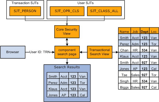

The system stores security data in transaction and user security join tables (SJTs). When you access a transaction component with a security search view, the security view references the security join tables to determine how the data is secured and what access the user has.
This graphic shows the search page determining which permission lists a user has and what data permission the list gives the user using either the transaction or user security join tables. The transaction security join table is determined by the type of data stored in the component:
The core security view uses the security data stored in the security join tables to determine which rows of data the user can access
