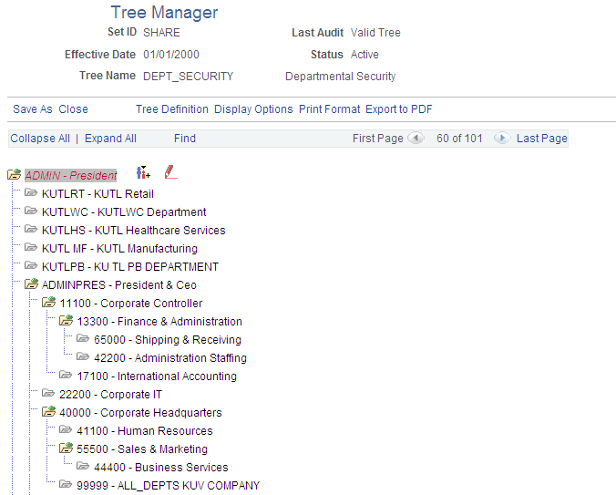

Understanding Data Permission Security by Department Security Trees
Each security set has a tree-based security access type. Tree-based security access types use department security trees to set up a hierarchy of your departments and enable you to use this hierarchy to simplify data assignment.
You use PeopleSoft Tree Manager to build a hierarchy of department security for an organization. A security tree provides a graphic means to grant and restrict access to data. The security tree doesn't have to represent your organization's hierarchy exactly, although it is usually very close.
To grant a row security permission list access to a group of departments, you grant access to the department to which all of those departments report. You can restrict access to individual departments or to a group of departments if you need to. This is an example of a department security tree for the SHARE set ID:
This example illustrates a portion of the SHARE department security tree.
Example of a portion of the SHARE department security tree
Using this security tree you could, for example, grant a row security permission list access to department 13000 and the system includes department 13000 and all the departments that report to it, giving the permission list access to everyone in all fourteen finance departments.
You can also restrict access to one of the branch entities. For example, if a row security permission list needs access to everyone in Finance except for Business Services, grant access to department 13000, but restrict access to department 15000, giving access to departments 13000, 20000, 22000, 25000, 27000, and 31000.

Creating and Modifying Security Trees
You can create a security tree automatically or manually.
Use the Tree Manager page (PSTREEMGR) to use to set up or modify department security trees.
You must run the Refresh SJT_CLASS_ALL process whenever you set up or modify a tree.
Navigation:
Tree Manager, and then Tree Manager, and then Tree Manager

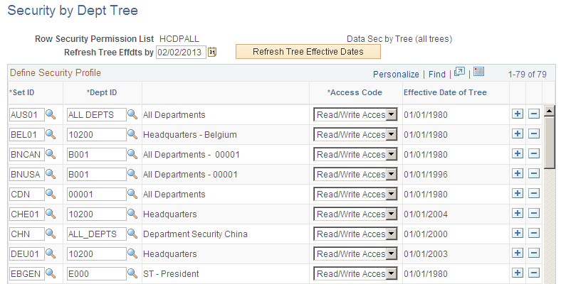

Security by Dept Tree Page
Use the Security by Dept Tree page (SCRTY_TABL_DEPT) to grant tree-based department data access to row security permission lists.
Navigation:
Set Up HCM, and then Security, and then Core Row Level Security, and then Security by Dept Tree, and then Security by Dept Tree
This example illustrates the fields and controls on the Security by Dept Tree page. You can find definitions for the fields and controls later on this page.
Field or Control Description
Refresh Tree Effdts by (refresh tree effective dates by)
The system will reference the trees that are effective as of this date when you select a tree set ID in the Define Security Profile grid. Select a date in the future to reference a future-dated tree.
For example, to use the department security trees that are current as of today's date, enter today's date in this field.
Refresh Tree Effective Dates
Select to refresh the trees listed in the Define Security Profile grid to trees that are effective as of the date in the As of Date for Trees field.
Note: To ensure that your row security permission lists use the current trees you must enter the appropriate as of date and click this button whenever you create a more recent version of a set ID's security tree.
Set ID and Dept ID (department ID)
Enter the tree set ID and the ID of the department that you are granting access to. The row security permission list has access to each department ID that reports up to this one on the security tree (unless you specify otherwise) so you don't have to select each department ID individually.
Access Code
Indicate what kind of access the row security permission list has to the data for this department ID.
To restrict access to one or more departments that report up to a department ID that you've granted access to, insert a row and select the restricted department's ID and then select an Access Code of No Access.
You need to restrict access explicitly only for department IDs that report up to the department ID to which you want to grant access. Otherwise, the row security permission list doesn't have access to a department unless it or the department to which it reports has been granted access on this page.
Effective Date of Tree
Displays this set ID's tree effective date. Make sure that the effective date of the tree is accurate. The system will not update the effective date automatically if you make a newer version of a tree.
To update trees, enter the date as of which the tree is effective in the Refresh Tree Effdts by field and click the Refresh Tree Effective Dates button.
