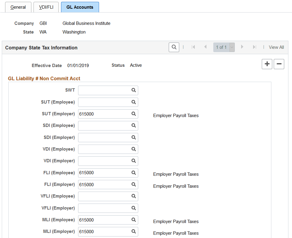

Company State Tax Table - GL Accounts Page
CO_STATE_TAX_TBL3
Enter your general ledger account numbers for state taxes.

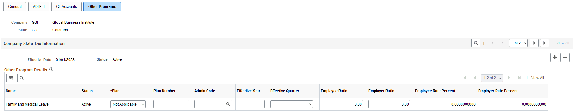

Company State Tax Table - Other Programs Page
CO_STATE_TAX_TBL4
Configure company-specific tax parameters for other programs.

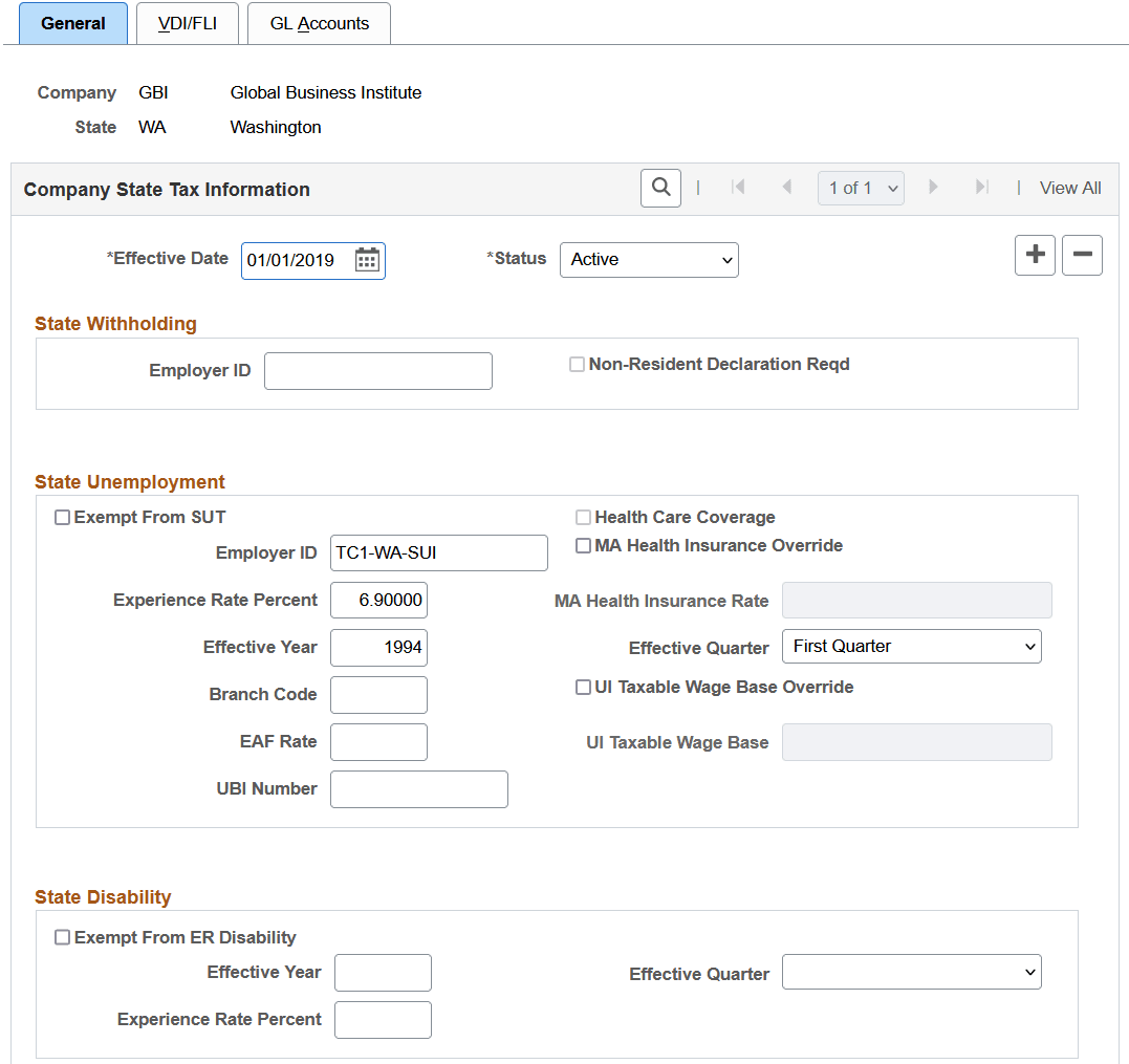

Company State Tax Table - General Page
Use the General page (CO_STATE_TAX_TBL) to set up an entry in the Company State Tax Table for each state where your organization collects or pays taxes.
Navigation:
  • Set Up HCM, and then Product Related, and then Payroll for North America, and then Federal/State Taxes, and then Company State Tax Table, and then General
  • Set Up HCM, and then Product Related, and then Payroll for North America, and then Federal/State Taxes, and then Agency State Tax Table USF, and then General
  • Set Up HCM, and then Product Related, and then Payroll Interface, and then Payroll, and then Company State Tax Table, and then General
This example illustrates the fields and controls on the Company State Tax Table - General page (1 of 2). You can find definitions for the fields and controls later on this page.
This example illustrates the fields and controls on the Company State Tax Table - General page (2 of 2). You can find definitions for the fields and controls later on this page.
The State field in State Tax Data 1 and Local Tax Data is edited against this table. You must create entries in this table before entering any state and local tax information for your employees.
State Withholding
Field or Control Description
Employer ID
Enter your state employer ID for state withholding.
Non-Resident Declaration Reqd
This check box is selected or deselected by default according to the Federal/State Tax Table 1 record for the state. Indicates whether the state requires a Non-Resident Declaration for non-resident employees.
State Unemployment
Exempt From SUT
Select this check box if the company is not required to pay SUT for this state. Use this option if you've specified, on the Company table, that the company as a whole is not exempt from SUT. If you select it here, Exempt from SUT becomes the default at the employee level; employees hired in this state have this check box selected on the State Tax Data page.
See Company State Tax Table - General Page.
Employer ID
Enter your state employer ID for state unemployment.
MA Health Insurance Override
(MA only.) The Massachusetts standard Health Ins Rate is set by default from the State Tax table. For Massachusetts, the Health Insurance Rate differs for newer employers. If you're a Massachusetts employer to whom a lower rate applies, select this check box and enter the correct Massachusetts Health Ins Rate.
Experience Rate Percent
The experience rate you enter in the State Unemployment group box should reflect the rate you receive from your state unemployment agency. Enter the year and quarter when the rate becomes effective in the Effective Yr/Qtr field. This enables you to have different rates within a single calendar year.
Note: You must set up a record for Quarter 1, because the system assumes a Quarter 1 record exists. A record for a subsequent quarter is required only if the rate changes mid-year. If you set up a Quarter 2 record, and you don't have a Quarter 1 record, you receive the error 000013 - "The SUT rate for the company and state displayed below was not found in the Company State Tax Table” (as indicated on the message report) during Pay Calculation. This error occurs regardless of the pay end date you are processing.
MA Health Insurance Rate
(MA only.) If you select Override, enter the correct health insurance rate.
Branch Code
This field is informational for Arizona. TAX860AZ.SQR appends the branch code to the end of the state EIN.
UBI Number (unified business ID number)
If the company you're adding is in Washington State, enter the UBI number assigned. Used for quarterly reporting for companies in the State of Washington only.
EAF Rate (employment administration fund rate)
If the company you're adding is in Washington State, enter the EAF rate used to calculate an additional tax for the Employment Administration Fund, which finances work search assistance and training for the unemployed. Used for quarterly reporting for companies in the State of Washington only.
UI Taxable Wage Base Override and UI Taxable Wage Base
An employer’s unemployment taxable wage base may vary depending on its unemployment experience rating. To identify a company as subject to the higher unemployment taxable wage base, and override the standard (lower) taxable wage base delivered on the Other Rates page of the State Tax Table entry for the state, first select the UI Taxable Wage Base Override check box, and then, in the UI Taxable Wage Base field, specify the taxable wage base that applies to the company
For example, the standard Rhode Island 2012 taxable wage base is $19,600 for most employers, but employers with an experience rate of 9.79% or higher must pay tax on a higher 2012 taxable wage base of $21,100. To identify the company as subject to the higher unemployment taxable wage base, select the UI Taxable Wage Base Override check box, and enter $21,000 in the UI Taxable Wage Base field.
State Disability
Exempt From ER Disability
Select this check box if employees in this state are exempt from employer-paid state disability tax. This field is for informational purposes only and is not used by the system.
The experience rate you enter in the State Disability group box should reflect the rate you receive from your state disability agency. Enter the year and quarter when the rate becomes effective in Effective Tax Yr/Qtr. This enables you to have different rates within a single calendar year.
Note: You must set up a record for Quarter 1, because the system assumes a Quarter 1 record exists. A record for a subsequent quarter is required only if the rate changes mid-year. If you set up a Quarter 2 record, and you don't have a Quarter 1 record, you receive the error 000097 – “The SDI Rate Table entry was not found for the state below” (as indicated on the message report) during Pay Calculation. This error occurs regardless of the pay end date you are processing.
Employer ID
(E&G) Enter the appropriate employer ID for state disability grouping in California, Michigan, and Minnesota. The T002CAHP, T002MIHP, and T002MNHP reports are grouped by employer ID if you enter the employer ID here and select the Separate Tax Report check box on the run control page. The report lists state withholding, state unemployment, and state disability.
Setting Up SUT Exemptions To Generate Data for the TAX810 and TAX860 Reports
The TAX810, and TAX860 reports are generated based on SUT wages. When you select the Exempt From SUT field on this page, the system does not generate taxable wages, and the TAX810, and TAX860 reports will contain no data.
Perform the following to generate taxable earnings, enabling the TAX810, and TAX860 reports to produce the required wage detail reporting data, while still remaining exempt from State Unemployment Taxes:
  1. Ensure that the Company Exempt from SUT field on the Company Table-FICA/Tax Details page is deselected.
  2. Leave the Exempt From SUT field on the Company State Tax Table - General page deselected.
    These steps should ensure that the Exempt From SUT field on the State Tax Data page remains clear for each employee. Verify that the Exempt From SUT field is clear on all three pages.
  3. Enter a dummy number in the State Unemployment Employer ID field on the Company State Tax Table – General page.
  4. Enter a value of 0 (zero) in the State Unemployment Experience Rate.
After you do these steps, the system can track taxable wages without calculating SUT tax dollars. The TAX810 or TAX860 report can report the SUT subject wages.

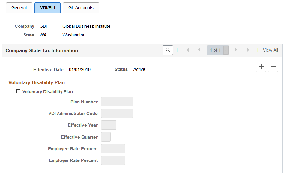

Company State Tax Table - VDI/FLI Page
Use the VDI/FLI page (CO_STATE_TAX_TBL2) to identify the voluntary disability plans associated with the company.
Navigation:
  • Set Up HCM, and then Product Related, and then Payroll for North America, and then Federal/State Taxes, and then Company State Tax Table, and then VDI/FLI
  • Set Up HCM, and then Product Related, and then Payroll for North America, and then Federal/State Taxes, and then Agency State Tax Table USF, and then VDI/FLI
  • Set Up HCM, and then Product Related, and then Payroll Interface, and then Payroll, and then Company State Tax Table, and then VDI/FLI
This example illustrates the fields and controls on the Company State Tax Table - VDI/FLI page (1 of 2). You can find definitions for the fields and controls later on this page.
This example illustrates the fields and controls on the Company State Tax Table - VDI/FLI page (2 of 2). You can find definitions for the fields and controls later on this page.
This page includes nearly identical sections for setting up information for your voluntary disability plan, and voluntary and state paid leave insurance plans.
Based on the state that is selected, some sections and fields on this page may be displayed or hidden to support state-specific requirements.
Voluntary Disability Plan
This section appears for all states.
Select this check box to indicate that the plan you're defining is a voluntary disability plan allowed by the state.
Plan Number
Enter the plan number of the voluntary disability plan. For New Jersey, this number appears on Form W-2.
VDI Administrator Code
Select the code that identifies the administrator of the plan. You maintain administrator codes on the VDI/FLI Administrator Table page.
Employee Rate Percent
Enter the employee-paid rate.
Note: You must set up a record for Quarter 1, because the system assumes a Quarter 1 record exists. A record for a subsequent quarter is required only if the rate changes mid-year. If you set up a Quarter 2 record, and you don't have a Quarter 1 record, you receive the error 000304 – “The VDI Rate Table entry was not found for the state below” (as indicated on the message report) during Pay Calculation. This error occurs regardless of the pay end date you are processing.
Employer Rate Percent
Enter the employer-paid rate.
(CA, HI, NJ, NY, PR) To set up VDI with a rate of zero so that you can track the VDI wages, enter 99.99999 as the Employee Rate Percent and Employer Rate Percent on this page.

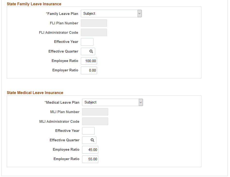

State Family Leave Insurance
This section appears for all states, and applies to Massachusetts, New Jersey, New York, and Washington.
Family Leave Plan
Select the applicable family leave insurance tax status for the company and state. Values are:
Exempt: Select if employees’ earnings are exempt from the family leave insurance tax.
Not Applicable: Select if the state plan does not apply to the employee.
Subject: Select if employees’ earnings are subject to family leave insurance tax.
Voluntary: Select if the company has a voluntary family leave insurance plan that covers the employees. This option does not apply to Massachusetts. MA allows voluntary plans, but they are not supported in Payroll for North America.
FLI Plan Number
Enter the plan number of the family leave insurance plan. This field appears if the selected family leave plan is Voluntary.
FLI Administrator Code
Select the code that identifies the administrator of the plan. You maintain administrator codes on the VDI/FLI Administrator Table page. This field appears if the selected family leave plan is Voluntary.
(NJ and NY) Enter the employee-paid rate.
Employee Ratio
(MA and WA) Enter the maximum percentage of premium that can be deducted from employees.
The total employee and employer ratio values must total to 100.00 percent.
(NJ and NY) Enter the employer-paid rate.
Employer Ratio
(MA and WA) Enter the percentage of premium to be contributed by employers.
(NJ, NY) To set up FLI with a rate of zero so that you can track the FLI wages, enter 99.99999 as the Employee Rate Percent and Employer Rate Percent on this page.
State Medical Leave Insurance
This section appears and applies to Massachusetts and Washington only.
Medical Leave Plan
Select to indicate that the plan you're defining is a voluntary medical leave plan allowed by the state. Values are:
Exempt: Select if employees’ earnings are exempt from the medical leave insurance tax.
Subject: Select if employees’ earnings are subject to medical leave insurance tax.
(WA) Voluntary: Select if the company has a voluntary medical leave insurance plan that covers the employees.
MLI Plan Number
(WA) Enter the plan number of the family leave insurance plan. This field appears if the selected family leave plan is Voluntary.
MLI Administrator Code
(WA) Select the code that identifies the administrator of the plan. You maintain administrator codes on the VDI/FLI Administrator Table page. This field appears if the selected family leave plan is Voluntary.
Employee Ratio
Employer Ratio
Use the GL Accounts page (CO_STATE_TAX_TBL3) to enter your general ledger account numbers for state taxes.
Navigation:
  • Set Up HCM, and then Product Related, and then Payroll for North America, and then Federal/State Taxes, and then Company State Tax Table, and then GL Accounts
  • Set Up HCM, and then Product Related, and then Payroll for North America, and then Federal/State Taxes, and then Agency State Tax Table USF, and then GL Accounts
  • Set Up HCM, and then Product Related, and then Payroll Interface, and then Payroll, and then Company State Tax Table, and then GL Accounts
This example illustrates the fields and controls on the Company State Tax Table - GL Accounts page (1 of 2). You can find definitions for the fields and controls later on this page.
This example illustrates the fields and controls on the Company State Tax Table - GL Accounts page (2 of 2). You can find definitions for the fields and controls later on this page.
Enter the general ledger account numbers, if applicable, for the following company liabilities:
GL Liability # Non Commit Acct
SWT
State Withholding liabilities.
SUT (Employee)
State Unemployment employee liabilities.
SUT (Employer)
State Unemployment employer liabilities.
SDI (Employee)
State Disability employee liabilities.
SDI (Employer)
State Disability employer liabilities.
VDI (Employee)
Voluntary Disability employee liabilities.
VDI (Employer)
Voluntary Disability employer liabilities.
FLI (Employee)
State family leave insurance employee liabilities.
FLI (Employer)
State family leave insurance employer liabilities.
VFLI (Employee)
Voluntary family leave insurance employee liabilities.
VFLI (Employer)
Voluntary family leave insurance employer liabilities.
MLI (Employee)
State medical leave insurance employee liabilities.
MLI (Employer)
State medical leave insurance employer liabilities.
VMLI (Employee)
Voluntary medical leave insurance employee liabilities.
VMLI (Employer)
Voluntary medical leave insurance employer liabilities.
FMLI (Employee)
Family medical leave insurance employee liabilities.
FMLI (Employer)
Family medical leave insurance employer liabilities.
VFMLI (Employee)
Voluntary family medical leave insurance employee liabilities.
VFMLI (Employer)
Voluntary family medical leave insurance employer liabilities.
Transit (Employee)
(OR) State transit tax employee liabilities.
LTC (Employee)
(WA) State long-term care insurance employee liabilities.
Use the Other Programs page (CO_STATE_TAX_TBL4) to configure company-specific tax parameters for other programs.
Navigation:
  • Set Up HCM, and then Product Related, and then Payroll for North America, and then Federal/State Taxes, and then Company State Tax Table, and then Other Programs
  • Set Up HCM, and then Product Related, and then Payroll for North America, and then Federal/State Taxes, and then Agency State Tax Table USF, and then Other Programs
  • Set Up HCM, and then Product Related, and then Payroll Interface, and then Payroll, and then Company State Tax Table, and then Other Programs
This example illustrates the fields and controls on the Company State Tax Table - Other Programs page. You can find definitions for the fields and controls later on this page.
This page is applicable to the Program Funding Configuration feature only.
This page appears if one or more programs have been set up and in effect for the state on the PeopleSoft Payroll for North America: Program ID Association Page. It lists all the state’s programs that are available as of the effective date.
If changes are made to the program definition or program association details, you need to add a new row on this page to see the updates. The updates will not show if you just modify the effective date of an existing row in Correct History mode.
Inactive program rows are displayed as read-only.
Name
Displays the funding program associated with the state.
Plan
Displays or select the plan type the employees are enrolled in. Values are:
Exempt: The employee is exempted from participation in the corresponding program, and the employee's earnings are exempt from the program's taxes.
Not Applicable (default): The corresponding program does not apply to the employee. With this tax status, the employer does not withhold program taxes from the employee or pay the employer taxes.
Subject: The employee is covered by the corresponding program, and their earnings are subject to taxation.
Voluntary: The employee is covered by an equivalent plan rather than by a state program. The employee's earnings are subject to premium deduction. Employers with private or equivalent plans must use Voluntary as the plan type.
(DE only) Waiver-State: The employee is exempted from participation in the Delaware Paid Leave state program. Employees who are part-time (working less than 25 hours per week) or not expected to work for 12 months (for example, students who work over the summer only) can submit a Waiver form (signed by both the employee and employer) to be excluded from the program.
(DE only) Waiver-Voluntary: The employee is exempted from participation in the Delaware Paid Leave private program. As mentioned previously, employees who are part-time or not expected to work for 12 months can submit a waiver form to be excluded from the program.
When a value is specified in this field for a program and you have selected the Automatic Employee Tax Data option on the Application Fundamentals: Installation Table - Products Page, the system will automatically default the program's Tax Status field in the Other Programs - Details section of the PeopleSoft Payroll for North America: State Tax Data Page for newly hired or transferring employees to match this value that is specified for the associated company.
Plan Number
Displays or select the plan number.
Admin Code
Displays or select the code that identifies the administrator of the plan. You maintain administrator codes on the PeopleSoft Payroll for North America: VDI/FLI Administrator Table Page.
Effective Year and Effective Quarter
Displays or enter the year and quarter when the plan setup becomes effective.
Do not enter any value in these fields if the selected plan is Subject.
Employee Ratio and Employer Ratio
Displays or enter the ratio of premium to be contributed by the employee and the employer.
The sum of ratio values specified on this page must be 100.
These fields become editable if the Company State Tax Data Option field is set to Ratio on the PeopleSoft Payroll for North America: Program ID Association Page. Default values specified from the Program ID Association page are prepopulated in these fields when the program appears for the first time on this page. For any new row that is added, data is prepopulated from the previous row.
Displays or enter the employee-paid rate and employer-paid rate.
These fields become editable if the Company State Tax Data Option field is set to Rate Percent on the PeopleSoft Payroll for North America: Program ID Association Page. Default values specified from the Program ID Association page are prepopulated in these fields when the program appears for the first time on this page. For any new row that is added, data is prepopulated from the previous row.
Important: If you have an equivalent or a private plan, you must set up the Employee Rate Percent and Employer Rate Percent values in these fields. Do not set up these values on the State Tax Table entry for the state. If you do, your values will be overridden the next time PeopleSoft delivers updates to the State Tax Table entry for the state.
