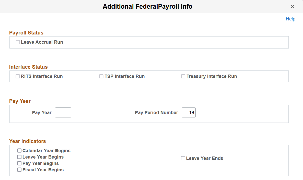

(USF) Additional FederalPayroll Info Page
GVT_PAY_STATUS_SEC
Indicate whether interfaces have been run and specify periods for Federal Leave Accrual processing.

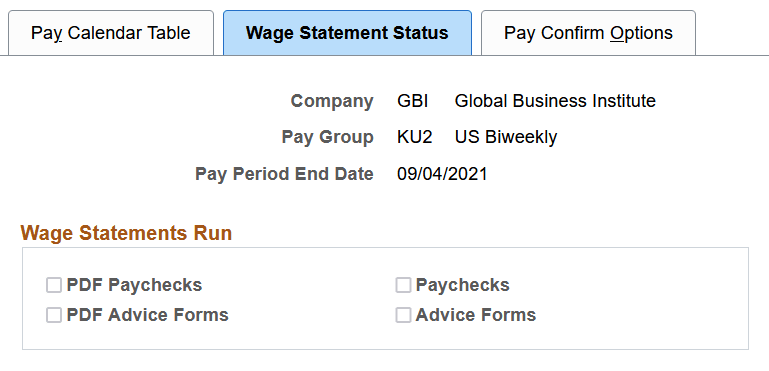

Wage Statement Status Page
PAY_CALENDAR_TBL3
Track the completion of pay statement processes.

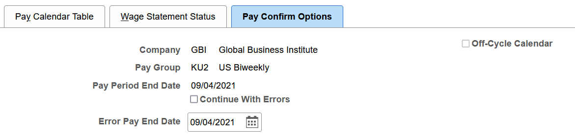

Pay Confirm Options Page
PAY_CALENDAR_TBL2
Select whether to bypass payroll messages during the Pay Confirmation process.

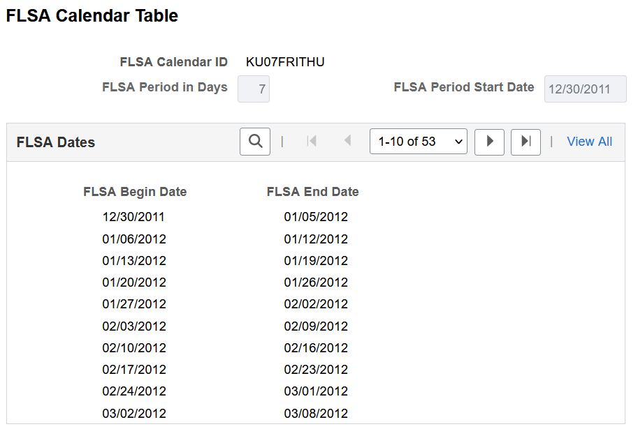

FLSA Calendar Table Page
Use the FLSA Calendar Table page (FLSA_CALENDAR) to set up FLSA calendars.
Navigation:
Set Up HCM, and then Product Related, and then Payroll for North America, and then Payroll Processing Controls, and then FLSA Calendar Table, and then FLSA Calendar Table
This example illustrates the fields and controls on the FLSA Calendar Table page. You can find definitions for the fields and controls later on this page.
Field or Control Description
FLSA Calendar ID
The FLSA Calendar ID that you added or selected in the entry page displays here. Use the FLSA Calendar ID to link an FLSA calendar to a pay group. For example, an FLSA Calendar ID of 14, MON-SUN, would be linked to pay groups whose pay period is 14 days and whose FLSA pay period begins on Monday and ends on Sunday. This ID is then used on the FLSA Period Definition page to associate the FLSA calendar to the pay group.
FLSA Period in Days
Use this field to define the length of the FLSA period for this Calendar ID. The information you enter here is used with the FLSA Period Start Date to determine the FLSA Begin Dates and FLSA End Dates, which display on this page after you've created FLSA calendars.
Use this field to define the starting date from which succeeding FLSA periods are set. You should set this field to the earliest start date of any of the pay groups that use this FLSA Calendar ID.
After you create the FLSA calendar using the Calendar Build process, the FLSA Calendar Table page becomes display-only. Each row in the FLSA Dates group box displays the FLSA Begin and End Dates for one FLSA work period. After you create the FLSA calendar and it becomes display-only, you cannot make any changes or corrections.

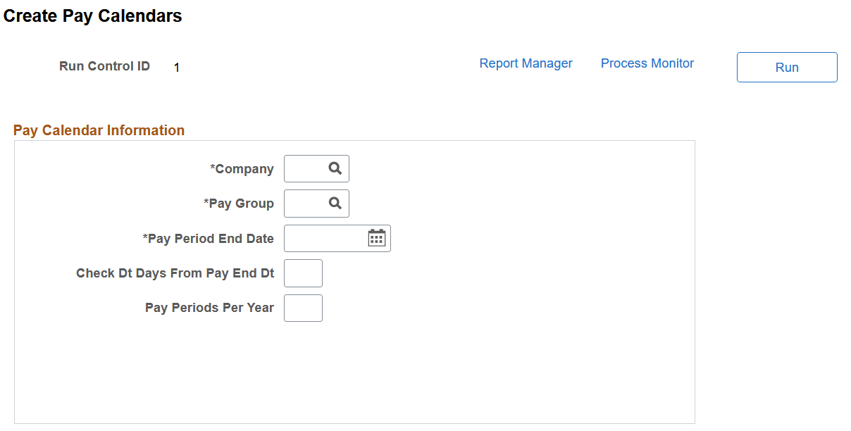

Create Pay Calendars Page
Use the Create Pay Calendars page (RUNCTL_PAY_CAL_BLD) to create pay calendars automatically.
(After the pay calendars are built, use the Pay Calendar Table page to manually complete the pay calendar entries.)

This example illustrates the fields and controls on the Create Pay Calendars page. You can find definitions for the fields and controls later on this page.
Use the Create Pay Calendars page to set up and run the Calendar Build process. Once the calendars are built, use the Pay Calendar Table page to assign pay run IDs and other information.
You must set up the calendar year balance ID before creating calendars.
Pay Period End Date
Enter the first pay period end date for the pay calendar. For example, for a semi-monthly payroll for 2009, enter 01/15/2009. To build a pay calendar for a partial calendar year, enter the end date of the pay period where you want the calendar to start. In other words, to start the calendar for the pay period ending on March 15, enter 03/15/2009.
Check Dt Days From Pay End Dt
Enter a value representing the number of days (plus or minus) from the pay period end date to the check issue date. For example, if the pay period end date is January 31 and the check date is February 3, set the number of days to 3. If the pay period end date is January 31 and the check date is January 30, enter -1. Should the check date fall on a holiday or weekend day, the system automatically searches backwards on the calendar to find the first workday before the holiday or weekend day to issue checks.
Pay Periods Per Year
The number of pay periods per year appears. This number depends on the Pay Frequency assigned to the pay group.
Pay Year
(USF) This field appears only for U.S. federal customers.
The IRR process requires a pay year. When processing IRRs, the IRR Fiscal Data accumulator identifies all monies that come from the pay year. Enter the pay year to which the pay calendar applies.
(USF) Define Years
This group box appears only for U.S. federal customers.
Calendar Yr Run (calendar year run)
This value is used by federal leave processing on particular leave types for which accrual begins with the calendar year. Of the calendar entries to be created automatically, enter the pay calendar number that identifies which pay period is designated to begin the leave plan calendar year. For example, for a monthly payroll there are twelve pay calendars in a year. January would be the starting point, so enter 1 in this field.
Pay Yr Run (pay year run)
This value is used by federal annual leave accrual processing on leave types for which accrual begins with the pay year. Of the calendar entries to be created automatically, enter the pay calendar number that identifies which pay period is designated to begin the pay year for leave accrual processing.
Fiscal Yr Run (fiscal year run)
This value is used by federal annual leave accrual processing on leave types for which accrual begins with the fiscal year. Of the calendar entries to be created automatically, enter the pay calendar number that identifies which pay period is designated to begin the fiscal year for leave accrual processing.
Leave Yr Run (leave year run)
This value is used by federal annual leave accrual processing only. Of the calendar entries to be created automatically, enter the pay calendar number that identifies which pay period is designated to begin the annual leave year.
Note: The leave year begins on the first day of the first full pay period for which the begin and end dates are both within the new year. The leave year ends on the last day of the last pay period ending just before the pay period of the new leave year.

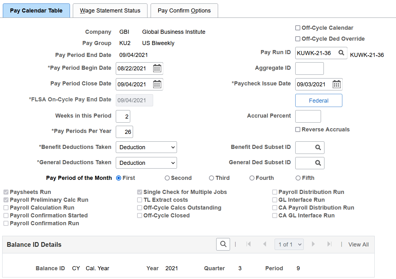

Pay Calendar Table Page
Use the Pay Calendar Table page (PAY_CALENDAR_TABLE) to manually build a single pay calendar.
Manually complete pay calendar entries for calendars that were created automatically. Review pay calendars.

This example illustrates the fields and controls on the Pay Calendar Table page. You can find definitions for the fields and controls later on this page.
Pay Period End Date
The pay period end date appears here. The system uses this date to determine if an employee's pay should be prorated. It also checks this date to see whether a holiday falls within the pay period and determines if the employee is active within that pay period. Therefore, the system knows whether to pay the employee for that day.
The pay calculation program uses these dates to determine which deductions and additional pays to use.
Pay Period Begin Date
Enter the pay period begin date. The system uses this date to determine if an employee's pay should be prorated. It also checks this date to see whether a holiday falls within the pay period and determine if the employee is active within that pay period. Therefore, the system knows whether to pay the employee for that day.
FLSA On-Cycle Pay End Date
Select a pay end date for FLSA off-cycle processing. This field applies only to off-cycle calendars. For on-cycle calendars, this field is unavailable for entry. If the earnings being paid in the off-cycle are subject to FLSA (Affect on FLSA check box on the Earnings Table – General page is not set to None), enter the on-cycle pay end date to which the earnings should be applied. The system uses this date to determine the correct FLSA period.
Weeks in this Period
Enter a value to indicate the number of weeks within the payroll cycle. Depending on the state in which your employees are based, you may need to use this field for tax reporting. The number of weeks is based on the number of Wednesdays in the pay period.
Enter a value to indicate the number of pay periods per year. When the system calculates deductions, it checks the deduction table, annualizes the amount of each deduction, and then divides the result by the number of pay periods per year.
Example: If you set up a deduction for $100 per month, the system multiplies $100 by 12 to arrive at $1200, and then, for employees paid monthly, divides by 12 to arrive at a deduction of $100 per pay period. For semi-monthly employees, the system divides the deduction by 24.
For weekly and biweekly pay periods, it is not quite so simple. Depending on the day of the week on which the payday falls, there may be 53 (instead of 52) weekly pay periods during a given year; likewise, there may be 27 (instead of 26) biweekly pay periods. To accommodate this situation, in the Pay Periods Per Year field, specify whether the pay calendar you're defining has 26, 27, 52, or 53 Pay Periods Per Year.
The system always annualizes amounts by multiplying by 52, 26, 24, or 12, depending on whether the deduction is weekly, biweekly, semimonthly, or monthly; it de-annualizes by dividing by the number you enter for the number of pay periods per year.
Note: For monthly and semi-monthly pay calendars, the Pay Periods Per Year field is unavailable for entry; the only valid values are 12 and 24.
Off-Cycle Calendar
Select to identify the pay calendar as off-cycle processing. Two types of processing are associated with a pay calendar: on-cycle and off-cycle. On-cycle processing is the normal, scheduled payroll processing for a pay group and pay period. Off-cycle processing is any other payroll activity that deviates from the norm. Typically, off-cycle activity consists of recording manual checks issued during this period, on-demand checks calculated and issued during this period, and reversals processed during this period. This option enables you to run a group of off-cycle checks that are associated with a specific check date which may differ from your on-cycle check date.
Off-Cycle Ded Override (off-cycle deduction override)
For an off-cycle run, select this check box to specify that the Pay Calculation process should use the deduction override process to determine deductions.
If Off-Cycle Calendar is selected and Off-Cycle Ded Override is deselected, then the deduction override evaluation process is bypassed during pay calculation. That means that employee-level benefit or general deduction override will not take effect. This might be useful for an off-cycle bonus run.
Pay Run ID
Select a pay run ID. Each payroll batch process must have a pay run ID to determine what pay groups to process. All pay calendar entries with the same pay run ID are processed at the same time. Before you start payroll processing for a pay period, you must assign a pay run ID on this page, and that ID must first be defined on the Pay Run Table page. The Payroll Process cannot run without a pay run ID.
Aggregate ID
(USA) Enter an aggregate ID to indicate aggregate taxation. Entering a value here tells the system to aggregate taxation for the entire pay group.
Normally, you use the aggregate tax method when you must pay employees more than once in a single pay period, such as a temporary staffing agency paying employees for multiple assignments within a weekly pay period. The system aggregates all pay calendars with the same aggregate ID value (including off-cycle payrolls) for the purposes of tax calculations. All wages paid on calendars with the same aggregate ID are combined, then annualized and taxed accordingly.
Note: If you add stand-alone off-cycle calendars to be aggregated together, the pay period end date must be the day after the first confirmed check's pay period end date. If you enter the same aggregate ID on multiple pay calendars, then for a given employee, each succeeding check (whether off-cycle or on-cycle) calculated under each of these pay calendars is aggregated with all of the already-calculated qualifying checks of the previous pay calendars which were set up using the same aggregate ID. If a pay calendar has a unique aggregate ID, then for a given employee, succeeding off-cycle and on-cycle checks are aggregated with any already-confirmed qualifying off-cycle checks for that pay calendar.
To aggregate taxation across checks, you must also set up the earnings code with Specified on Paysheet specified as the tax method and you must manually specify Aggregate as the tax method on off-cycle paysheets.
See PeopleSoft Payroll for North America: Aggregate Taxation of Multiple Checks.
Paycheck Issue Date
Select a paycheck issue date. This date appears on the employee's paycheck or advice slip. It determines the Calendar Year, Quarter, and Period for all payroll balances. In addition, the system uses the paycheck issue date to find the appropriate effective-dated entry in the tax tables to use for this pay calculation.
Note: The system updates employee balances (such as taxes, deductions, and earnings) based upon the check date on the pay calendar you are processing with, not the check date on the paysheet or check. These dates are often the same, but not always.
Federal
(USF) Click this button to access the Payroll Status page. This button appears only for U.S. federal customers.
Accrual Percent
Enter an accrual percent to calculate accrual totals for the general ledger interface. This percentage is typically used to process pay periods that overlap accounting periods or don't correspond to calendar months. For example, if payroll is processed weekly, but general ledger is processed monthly, you may need to make adjustments. If you specify a percent here, that percent of pay for the last pay period of the month is added to accrual amounts for the general ledger Interface. Then, in the first pay period of the following month, you can reverse those accruals by selecting the Reverse Accruals check box and leaving the Accrual Percent field deselected. The system responds by subtracting the accruals from the appropriate amounts in the General Ledger Interface.
Reverse Accruals
Select to reverse accruals added to the General Ledger Interface. The system responds by subtracting the accruals from the appropriate amounts in the General Ledger Interface. However, if you select this check box, you must leave the Accrual Percent field deselected. If the Accrual Percent field is not deselected, you must deselect the Reverse Accruals check box.
Note: The Accrual Percent field and Reverse Accruals check box are not applicable to PeopleSoft Payroll for North America for E&G.
Benefit Deductions Taken
Select a value to indicate how to take benefit deductions for this pay run. The default value is Deduction.
  • None: Select this value if you do not want to take benefit deductions.
  • Deduction: Select this value if you want to use the regular benefit deductions defined on the Deduction Table pages for these employees. This is the default value.
  • Subset: Select this value if you want to use a specified benefit deduction subset. If you select this value, you must specify the subset ID in the Benefit Ded Subset ID (benefit deduction subset ID) field.
Specify the subset ID if you selected Subset in Benefit Deductions Taken.
General Deductions Taken
Select a value to indicate how to take general deductions for this pay run. The default value is Deduction.
  • None: Select this value if you do not want to take general deductions.
  • Deduction: Select this value if you want to use the regular deductions defined on the Deduction Table pages for these employees. This is the default value.
  • Subset: Select this value if you want to use a specified general deduction subset. If you select this value, you must specify the subset ID in the General Ded Subset ID (general deduction subset ID) field.
Specify the subset ID if you selected Subset in General Deductions Taken.
Pay Period of the Month
Use this option to assign a pay period to the earnings and deductions designated for this calendar entry. When you create paysheets, the system checks if the pay period for additional pay matches the pay period being processed, then adds the additional pay to the paysheet. During Pay Calculation, if the pay period for a deduction matches the pay period being processed, the system takes the deduction from gross pay. Select the corresponding option to specify the pay period of the month you want: First, Second, Third, Fourth, and Fifth.
Reviewing Payroll Milestones
The check boxes across the bottom of the Pay Calendar Table page are unavailable for entry. The system maintains this section, which consists of process indicators, or milestones, that indicate how far along you are in the payroll process for this calendar entry. For example, if you have already created paysheets, completed your final Pay Calculation, and run Pay Confirmation, the system selects several check boxes on the Pay Calendar Table page, representing the steps you have already completed.
The background programs and SQRs maintain these indicators. During payroll processing, the system queries these indicators to verify that you are running the payroll batch processes in the correct order.
Off-Cycle Closed
After an on-cycle payroll is confirmed for the next pay period, the system selects the Off-Cycle Closed check box, and you can no longer run off-cycle payrolls against this calendar.
Note: You can use the Open/Close Pay Calendar process (PAY130 or PAY130CN) to open the calendar (deselect the off-cycle closed check box) to process year end adjustments. After the adjustments are processed, run the PAY130 or PAY130CN to close the calendar. This process only opens or closes the last on-cycle calendar of the year.
Payroll Distribution Run
Selected when the non-commitment accounting GL distribution has been run.
GL Interface Run
Selected when the (non-commitment accounting) accounting lines have been created.
CA Payroll Distribution Run (commitment accounting payroll distribution run)
Selected when the commitment accounting GL distribution has been run.
CA GL Interface Run (commitment GL interface run)
Selected when the commitment accounting GL Interface has been run.
You should run the GL interface only after you have completed your on- and off-cycle payrolls for a pay calendar entry. After the GL interface has been run, the system won't allow you to enter any more payroll transactions for that calendar entry. If GL Interface Run or CA GL Interface Run is selected, you cannot rerun the process until resetting the check box. The GL interface check boxes have no effect on processing adjustments for the pay period. You can still run adjustments until the Off-Cycle Closed check box is selected.
You should run your GL Interface only after you have completed your on- and off-cycle payrolls for a pay calendar entry. After the GL Interface has been run, the system won't allow you to enter any more payroll transactions for that calendar entry. If GL interface Run is selected, you cannot rerun the process until resetting the check box and it has no effect on processing adjustments for the pay period. You can still run adjustments until the Off-Cycle Closed check box is selected.
Balance ID Details
This group box displays the year, quarter, and period applicable to the pay period for each balance ID for which you're maintaining balances.
Use the Payroll Status page (GVT_PAY_STATUS_SEC) to indicate whether interfaces have been run and specify periods for Federal Leave Accrual processing.
Navigation:
Click the Federal button on the Pay Calendar Table page.
This example illustrates the fields and controls on the Additional FederalPayroll Info page. You can find definitions for the fields and controls later on this page.
Payroll Status
Leave Accrual Run
This check box is updated by the Leave Accrual process that you run after payroll is confirmed.
Interface Status
The check boxes in this group box indicate whether the RITS Interface, TSP Interface, or the Treasury Interface has been run for the pay calendar. The system updates these fields.
Pay Year
Pay Year
The IRR process requires a Pay Year. When processing IRRs, the IRR Fiscal Data Accumulator identifies all monies that come from the Pay Year. Enter the pay year to which this pay calendar applies.
Year Indicators
The system completes the first four check boxes based on the run control parameters you enter when you run the Calendar Build process. If you need to change these values, you can manually update the calendar after it is built.
Calendar Year Begins
This check box is used by U.S. federal annual leave accrual processing and for U.S. federal Pay Caps/Limits processing.
For USF annual leave accrual processing: If the pay calendar is for a pay period designated to begin the Leave Plan Calendar Year for a particular Leave Type, select this check box.
For USF Pay Caps/Limits processing: If earnings are deferred to the next year because the employee exceeds the limits in the current year, the COBOL will try and pay out the deferred earnings on the first payroll of the following year. If this check box is selected, the process uses this date to signify the first payroll of the year.
Leave Year Begins
This check box is used by Federal Annual Leave Accrual processing only. If the pay calendar is for a pay period designated to begin the Annual Leave year, select this check box.
Pay Year Begins
This check box is used by Federal Annual Leave Accrual processing on Leave Types for which accrual begins with the Pay Year. If the pay calendar is for a pay period designated to begin the Pay Year for Leave Accrual processing, select this check box.
Fiscal Year Begins
This check box is used by Federal Annual Leave Accrual processing on Leave Types for which accrual begins with the Fiscal Year. If the pay calendar is for a pay period designated to begin the Fiscal Year for Leave Accrual processing, select this check box.
Leave Year Ends
This check box is for your information only. It enables you to identify the pay calendar that is intended to represent the leave year end.
Use the Wage Statement Status page (PAY_CALENDAR_TBL3) to track the completion of pay statement processes.
Navigation:
  • Payroll for North America, and then Payroll Processing USA, and then Create and Load Paysheets, and then Review Pay Calendars, and then Wage Statement Status
  • Payroll for North America, and then Payroll Processing CAN, and then Create and Load Paysheets, and then Review Pay Calendars, and then Wage Statement Status
  • Payroll for North America, and then Payroll Processing USF, and then Create and Load Paysheets, and then Review Pay Calendars, and then Wage Statement Status
  • Set Up HCM, and then Product Related, and then Payroll for North America, and then Payroll Processing Controls, and then Pay Calendar Table, and then Wage Statement Status
  • Set Up HCM, and then Product Related, and then Payroll Interface, and then Payroll, and then Pay Calendar Table, and then Wage Statement Status
This example illustrates the fields and controls on the Wage Statement Status page. You can find definitions for the fields and controls later on this page.
Wage Statements Run
The system selects the check box for each pay statement process that was run successfully for this pay calendar for your reference. Prior to the creation of the direct deposit or pay advice, the check boxes are cleared.
Administrators can view the number of calendars that have completed these processes on the Payment Status visualization of the Payroll Operations Analytics dashboards for U.S. and Canada.
See PeopleSoft Payroll for North America: U.S. Payroll Operations Analytics Dashboard and PeopleSoft Payroll for North America: Canada Payroll Operations Analytics Dashboard.
PDF Paychecks
Selected when the Create PDF Paychecks (PYCHKUSA) or Create PDF Paycheques (PYCHQCAN) processes are completed for an on-cycle payroll.
PDF Advice Forms
Selected when the Create PDF Advice (PYDDAUSA) or Create PDF Advice Forms (PYDDACAN) processes are completed for an on-cycle payroll.
Paychecks
Selected when the Print Pay Checks (PAYUSCHK) or PRINT Pay Cheques (PAYCNCHK) processes are completed for an on-cycle payroll.
Advice Forms
Selected when the Print Advice Forms DDP003 (U.S) or DDP003CN (CAN) processes are completed for an on-cycle payroll.
Use the Pay Confirm Options page (PAY_CALENDAR_TBL2) to select whether to bypass payroll messages during the Pay Confirmation process.
Navigation:
  • Payroll for North America, and then Payroll Processing USA, and then Create and Load Paysheets, and then Review Pay Calendars, and then Pay Confirm Options
  • Payroll for North America, and then Payroll Processing CAN, and then Create and Load Paysheets, and then Review Pay Calendars, and then Pay Confirm Options
  • Payroll for North America, and then Payroll Processing USF, and then Create and Load Paysheets, and then Review Pay Calendars, and then Pay Confirm Options
  • Set Up HCM, and then Product Related, and then Payroll for North America, and then Payroll Processing Controls, and then Pay Calendar Table, and then Pay Confirm Options
  • Set Up HCM, and then Product Related, and then Payroll Interface, and then Payroll, and then Pay Calendar Table, and then Pay Confirm Options
This example illustrates the fields and controls on the Pay Confirm Options page. You can find definitions for the fields and controls later on this page.
Off-Cycle Calendar
If you selected this check box on the Pay Calendar Table page, this check box is selected—if you did not, the check box is deselected.
If you select this option, you must process the pay calculation for the transferred paysheets using the run parameters on the left side of the run control page. If you do not select this option, the system assumes that you are linking the transferred paysheets to an existing off-cycle paysheet that is linked to an on-cycle calendar.
Continue With Errors
Select this check box if you want the payroll process to continue when the system encounters error messages that are defined for the Continue With Errors functionality.
Error Pay End Date
Select an error pay end date that represents the end date of the off-cycle payroll in which you want to correct and pay the employees who are bypassed during the regular pay run. Be sure that you have an off-cycle pay calendar set up for the pay end date that you select.
