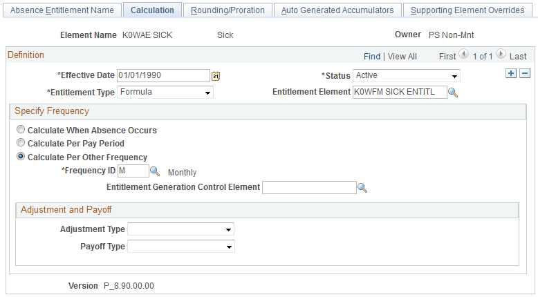

Absence Entitlements - Calculation Page
GP_ABS_ENTL
Define the method of accruing entitlement, the entitlement amount, generation control, and enter instructions for adjusting the entitlement balance under certain conditions.

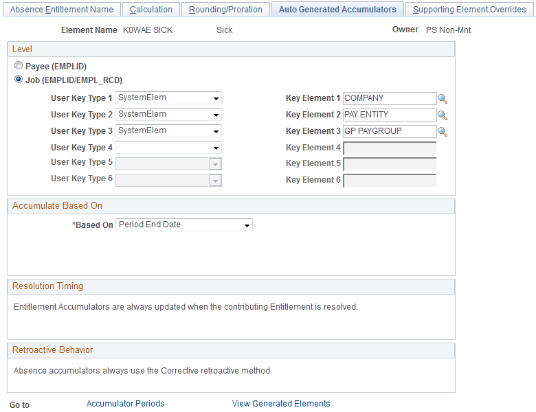

Absence Entitlements - Auto Generated Accumulators Page
GP_AUTOGEN_ACUM
Define user keys for tracking entitlement balances and specify when the accumulation of entitlement occurs.

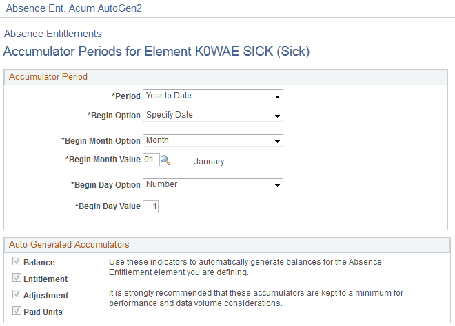

Absence Entitlements - Accumulator Periods for Element <Name> Page
GP_AUTOGEN_SEC
Define the start date and length of the entitlement accumulation period (for example, month-to-date or year-to-date) and select auto-generated accumulators to track entitlement, adjustments, and paid units.

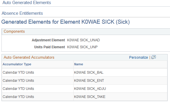

Absence Entitlements - Generated Elements for Element <Name> Page
GP_ABS_ACM_SEC
View the list of auto-generated accumulators for the entitlement element after saving the element's definition.

Example
If you create an entitlement element called VACATION, the system automatically creates a balance accumulator for the entitlement. This table lists the elements defined on the Members page for the accumulator (suffix names may differ by country) and explains when the elements are resolved:
Element Name Element Type Accumulator Sign When Resolved
VACATION (entitlement)
Absence Entitlement
Add
When entitlement is resolved.
VACATION_TAKE (units paid)
Auto-assign
Subtract
During the Take process the paid units are assigned to this element each day.
VACATION_ADJU (units adjusted)
Auto-assign
Add (positive or negative number)
When entitlement adjustment is resolved.
Use the Absence Entitlements - Calculation page (GP_ABS_ENTL) to define the method of accruing entitlement, the entitlement amount, generation control, and enter instructions for adjusting the entitlement balance under certain conditions.
Navigation:
Set Up HCM, and then Product Related, and then Global Payroll & Absence Mgmt, and then Elements, and then Absence Elements, and then Absence Entitlements, and then Calculation
This example illustrates the fields and controls on the Absence Entitlements - Calculation page.
Field or Control Description
Entitlement Type
Select the type of element to use to resolve the entitlement amount. Values are Accumulator, Bracket, Formula, Numeric, Payee Level, System Element, Variable.
If you select Payee Level, the entitlement element is resolved only if the element is assigned to the payee on the Entitlement/Take Assignment page.
Entitlement Element
If you selected a value other than Numeric in the Entitlement Type field, select the name of the element that calculates entitlement.
Entitlement Unit
If you selected Numeric in the Entitlement Type field, type the number of units in this field.
Specify Frequency
The fields that appear in this group box vary according to the frequency option that you select.
Calculate When Absence Occurs
Select to grant entitlement only when an absence occurs; for example, you want payees to accrue 42 days of entitlement for each illness. Clear to grant entitlement at a regular frequency such as monthly or annually.
Calculate Per Pay Period
Select if the entitlement is frequency-based, and you want entitlement to accrue each pay period.
Calculate Per Other Frequency and Frequency ID
Select if the entitlement is frequency-based and is to accrue at the frequency that you specify in the Frequency ID field. Frequencies include, but are not limited to Annual, Daily, Weekly, Monthly, Quarterly, and Semimonthly.
Note: Frequency values are defined in PeopleSoft HR.
The system uses the frequency to determine the entitlement amount to accrue each pay period. For example, if payees accrue one day of entitlement at a Monthly frequency, the system annualizes (calculates the annual entitlement) by multiplying 1 (day) by 12 (months). It uses the calendar period for the absence run to deannualize the amount. So, if payees' absences are run weekly, the system calculates the amount to accrue during each absence run by dividing 12 by 52. Therefore, payees accrue 12/52, or .23 days of sick time each pay period.
To deannualize entitlement using a frequency other than the pay period, select a generation control frequency in the Entitlement Generation Control Element field.
Per Absence Formula Element
This field appears only if you selected Calculate When Absence Occurs. Select a formula element. When you run the Take process, the system resolves the day formula (defined for the take element on the Absence Take - Day Formula page) and evaluates the day to determine whether the entitlement balance is needed. If it is, the system resolves the per absence formula element.
If the condition is met (the formula returns a non zero value), the Take process resolves the entitlement. If the condition is not met, the existing entitlement balance is used.
When a take element linked to this entitlement has a minimum pay period, eligibility period, or wait period, the per absence formula is executed only after these periods have been met.
Select a generation control element to limit the conditions under which the entitlement element is resolved. This field appears when you select Calculate Per Pay Period or Calculate Per Other Frequency.
For example, use generation control to restrict resolution of the element to active payees. If you are defining a frequency-based entitlement and you selected Calculate Per Other Frequency, you can select a generation control frequency element. The system uses the frequency that is defined by the generation control element, rather than the frequency of the pay calendar, to deannualize the entitlement amount and to determine when to resolve the entitlement.
Adjustment and Payoff
For frequency-based entitlements, you can instruct the system to reduce or pay off all or a portion of a payee's entitlement balance when a certain event occurs. Use generation control to define when you want the adjustment to occur.
Use the Absence Entitlements - Auto Generated Accumulators page (GP_AUTOGEN_ACUM) to define user keys for tracking entitlement balances and specify when the accumulation of entitlement occurs.
Navigation:
Set Up HCM, and then Product Related, and then Global Payroll & Absence Mgmt, and then Elements, and then Absence Elements, and then Absence Entitlements, and then Auto Generated Accumulators
This example illustrates the fields and controls on the Absence Entitlements - Auto Generated Accumulators page.
The fields on this page are the same as the fields on the Accumulators - Level page and Accumulators - Definition page in the Accumulators component. Only the settings that are specific to absence entitlement elements are described below.
Level
User Key Type 1...6 and Key Element 1...6
To have linked take elements share a per-absence entitlement balance when a user enters absence events with the same original begin date, you can select user keys to set up these instructions.
Select SystemElem for one of the user keys, and select ORIG BEGIN DATE (original begin date) in the corresponding Key Element field. On the Accumulator Periods for Element <name> page, select Custom Period in the Period field. In the Date field, select System Element - Date and select ORIG BEGIN DATE in the Begin Date Element field.
Now, when you enter two absence events for the same take element and both events have the same original begin date, the second event uses the entitlement balance of the first event.
Resolution Timing
Accumulator timing identifies when the entitlement balance accumulator is resolved. As the online message indicates, as each element contributing to the accumulator is resolved, the accumulator itself is also updated. The accumulator does not need to appear on the absence process list to be updated.
Retroactive Behavior
Retroactive behavior identifies how the accumulator is updated during retroactive processing. Absence accumulators always use the corrective retroactive method. The accumulator is updated with the newly calculated values of the member elements at the end of a retro recalculation.

Use the Absence Entitlements - Accumulator Periods for Element <name> page (GP_AUTOGEN_SEC) to define the start date and length of the entitlement accumulation period (for example, month-to-date or year-to-date) and select auto-generated accumulators to track entitlement, adjustments, and paid units.
Navigation:
Click the Accumulator Periods link on the Absence Entitlements - Auto Generated Accumulators page.
This example illustrates the fields and controls on the Absence Entitlements - Accumulator Periods for Element <name> page.
Accumulator Periods
Period
Select the period of time you want the accumulators to track. Depending on the option that you select, other fields may appear. Options are:
Calendar Period
Custom Period: If you select this option, complete the Date fields.
Month to Date: If you select this option, complete the Begin Option and Begin Day fields.
Quarter to Date: If you select this option, complete the Begin Option, Begin Month, and Begin Day fields.
Segment
Year to Date: If you select this option, complete the Begin Option, Begin Month, and Begin Day fields.
Date and Begin Date Value
If you selected Custom in the Period field, select the type of supporting element that defines the start date of the accumulation period. Options are: Bracket - Date, Calendar Date, Date, Formula - Date, System Element - Date, and Variable - Date.
(Calendar Date enables you to choose a specific date; Date enables you to use a Date element.)
In the Begin Date Value field, select the name of the element that defines the date. Or, if you selected Cal Date in the first field, select a date in this field.
Begin Option
If you selected Quarter to Date or Year to Date in the Period field, select the type of supporting element that defines the start date of the accumulation period. Options are:
Specify Date: The accumulation period will begin on the date you specify by completing the Begin Month and Begin Day fields.
Use Pay Entity Calendar: The accumulation period begins on the same day as the calendar that is defined for the pay entity.
Use Pay Entity Fiscal: The accumulation period begins on the same day as the fiscal calendar that is defined for the pay entity.
You define the pay entity calendar and fiscal calendar on the Pay Entity - Processing Details page.
Begin Month Option
This field appears only if you select Quarter To Date or Year To Date. Select the month in which you want the accumulation period to begin.
Begin Day Option
This field appears only if you select Month To Date, Quarter To Date, or Year To Date. Select the day of the month on which you want the accumulation period to begin.
WARNING:
If you change the Begin Month or Begin Day field after you run the Entitlement or Take process, accumulator results may be inaccurate.
When the system generates the accumulators, it automatically adds a suffix to each accumulator's name to identify what the accumulator represents: the balance, entitlement, adjustment, or paid units. For example, an entitlement element named Vacation might have accumulators named VACATION_BAL, VACATION_TAKE, and so forth.
Balance
Selected by default to remind you that the system always creates a balance accumulator to track the unused entitlement units that a payee has accrued. When it creates the balance accumulator, the system also generates two system-assigned elements that contribute to the entitlement balance accumulator: Units Adjusted and Units Paid.
Entitlement
Select to create a separate accumulator that tracks the total number of entitlement units that the payee has accrued during the accumulation period, including those that have been used.
Adjustment
Select to create a separate accumulator for the automatically assigned Units Adjusted element. The accumulator tracks the adjustments that have been made, including manual and automatic adjustments.
Paid Units
Select to create a separate accumulator for the automatically assigned Units Paid element. The accumulator tracks the total number of entitlement units the payee has used during the accumulation period.
Use the Absence Entitlements - Generated Elements for Element <name> page (GP_ABS_ACM_SEC) to view the list of auto-generated accumulators for the entitlement element after saving the element's definition.
Navigation:
Click the View Generated Elements link on the Absence Entitlements - Auto Generated Accumulators page.
This example illustrates the fields and controls on the Absence Entitlements - Generated Elements for Element <name> page.
You can see the list of automatically generated accumulators after you save the entitlement element's definition.
