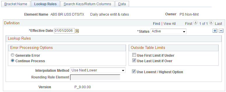

Lookup Rules Page
Use the Lookup Rules page (GP_BRACKET1) to define the lookup rules for a bracket.
Navigation:
Set Up HCM, and then Product Related, and then Global Payroll & Absence Mgmt, and then Elements, and then Supporting Elements, and then Brackets, and then Lookup Rules
This example illustrates the fields and controls on the Lookup Rules page.
Lookup Rules page
Field or Control Description
Error Processing Options
Select from the following values:
Generate Error: Stops processing and generates an error.
Continue Process: Continues processing without returning any value.
Outside Table Limits
Defines what happens if the key values are over or under those that are defined in the table:
Use First Limit if Under: Select if key values are under those that are defined in the table.
Use Last Limit if Over: Select if key values are over those that are defined in the table.
Interpolation Method
Select an interpolation method that defines the values to return if the system doesn't find an exact match; for example, if the key values are between two rows on the table. All interpolation methods use only one search key, the first mismatched one. Select from the following values:
Linear: Uses a mathematical formula to create a prorated value based on the next-higher and next-lower keys (works only with brackets that have one or two numeric keys and with numeric result columns).
Use Nearest: Uses the value from the row that has the nearest key (works only with brackets that have numeric or date keys).
Use Next Higher: Uses the value from the row that has the next-higher key (works with any bracket).
Use Next Lower: Uses the value from the row that has the next-lower key (works with any bracket).
See Understanding Interpolation Methods.
Use Lowest/Highest Option
When using linear interpolation, the system matches on all search columns that have already been matched. Then it looks for the next-lower and next-higher rows where the search columns match. When there isn't a lower or higher row where search columns match, you can use the Use Lowest/Highest Option check box to indicate whether the system should take the lowest or highest matching option.
Rounding Rule Element
With linear interpolation, you can use a rounding rule to specify the type of rounding for the returned value. The system applies this rounding rule to all return columns whose field format is numeric (decimal or monetary), because linear interpolation takes the ratio of the next-lower return column value and the next-higher value and returns the prorated value based on the ratio that is above the next-lower value. The result might be an excess of decimal places.

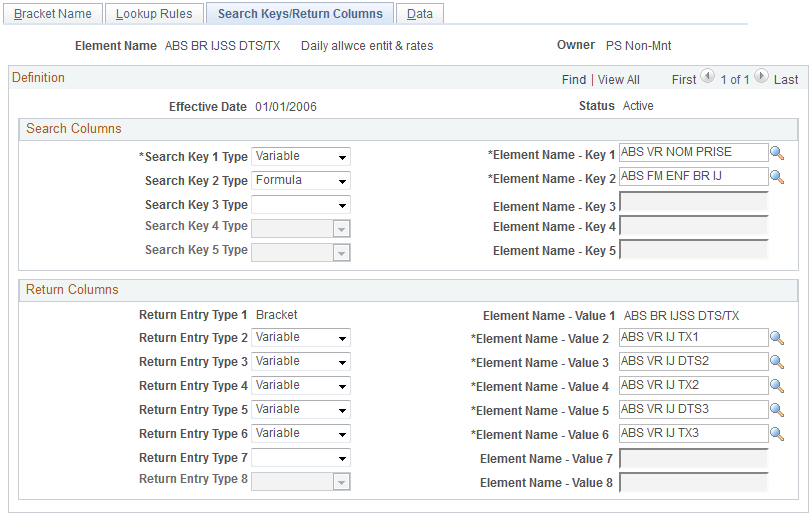

Search Keys/Return Columns Page
Use the Search Keys/Return Columns page (GP_BRACKET2) to identify the search keys and the return columns for the bracket.
Navigation:
Set Up HCM, and then Product Related, and then Global Payroll & Absence Mgmt, and then Elements, and then Supporting Elements, and then Brackets, and then Search Keys/Return Columns
This example illustrates the fields and controls on the Search Keys/Return Columns page.
Search Columns
In the Search Columns group box, select the keys that the system uses to search the bracket data. For each key, select the Search Key Type (element type) that you're entering. Then select the corresponding Element Name. You can enter up to five search keys.
Return Columns
In the Return Columns group box, select the columns that tell the system where to store the values returned by the lookup. For each column, select the Return Entry Type(element type) that you're entering. Then select the corresponding Element Name. The bracket itself is the first returned column. You can enter up to eight return columns.

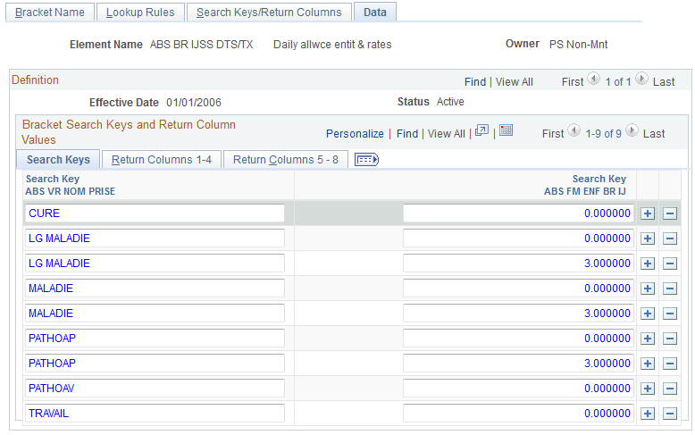

Brackets - Data Page
Use the Data page (GP_BRACKET3) to enter lookup values.
The search key values and the return column values that you selected in the Brackets - Search Keys/ Return Columns page appear here.
Navigation:
Set Up HCM, and then Product Related, and then Global Payroll & Absence Mgmt, and then Elements, and then Supporting Elements, and then Brackets, and then Data
This example illustrates the fields and controls on the Data page.
Data page
Bracket Search Keys and Return Column Values - Search Keys Tab
Enter the values of the search keys.
Bracket Search Keys and Return Column Values - Return Columns Tab
Enter the values to be returned for each search key value, based on your entries on the Search Keys/Return Columns page. You can enter multiple return values.

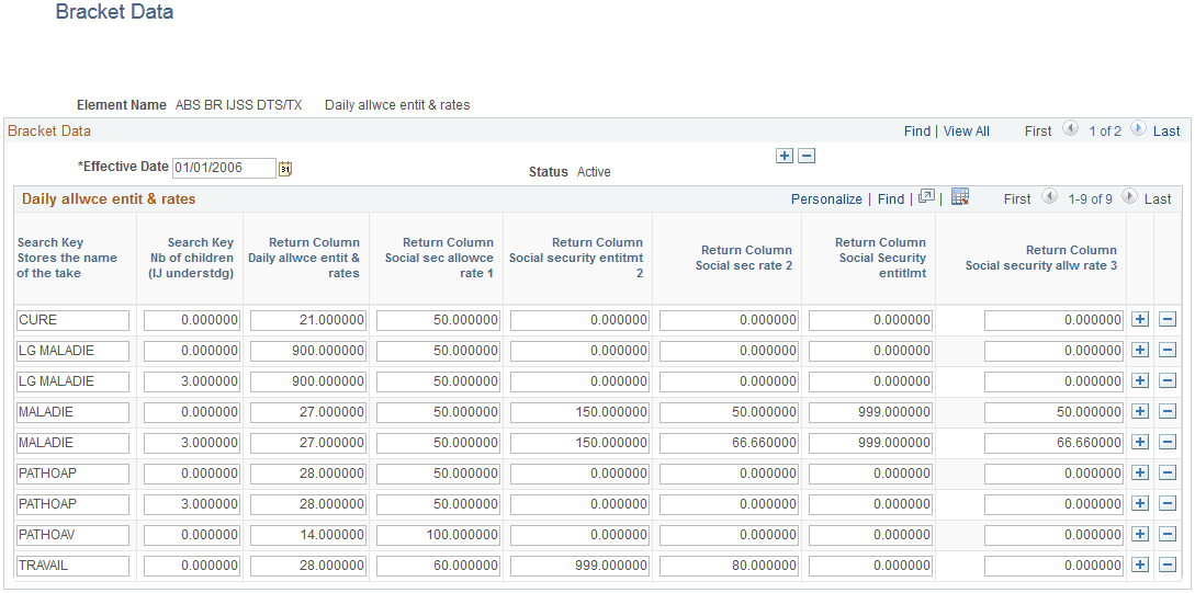

Bracket Data Page
Use the Bracket Data page (GP_BRACKET_DATA) to update search key values and return column values for existing bracket elements.
Navigation:
Set Up HCM, and then Product Related, and then Global Payroll & Absence Mgmt, and then Elements, and then Supporting Elements, and then Bracket Data
This example illustrates the fields and controls on the Bracket Data page.
Bracket Data page
This page provides administrators with an easy way to update the search key values and return values for an existing bracket. You define the original search keys, return columns, and lookup values for brackets using the Search Keys/Return Columns Page and Brackets - Data Page.
