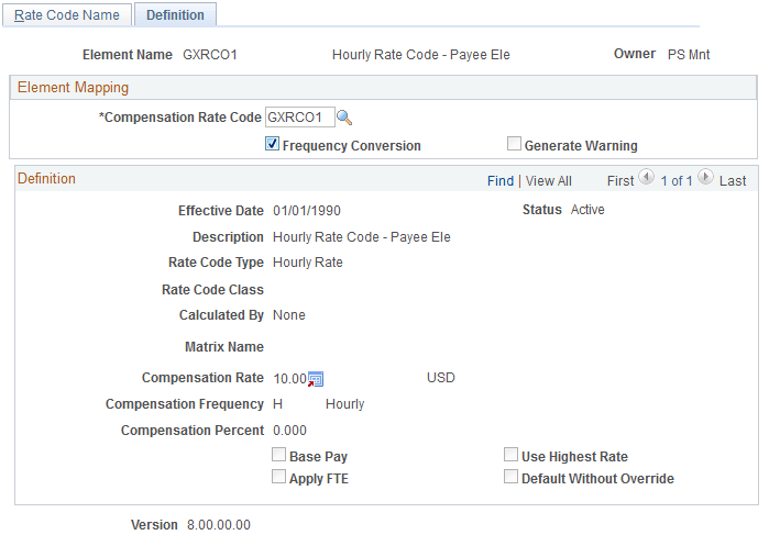

Use the Definition page (GP_RATE_CODE) to create a rate code element and map it to a rate code defined in HR.
You can also use the page to view rate code elements and change the mapping.
Navigation:
Set Up HCM, and then Product Related, and then Global Payroll & Absence Mgmt, and then Elements, and then Supporting Elements, and then Rate Codes, and then Definition
This example illustrates the fields and controls on the Rate Codes - Definition page.
Field or Control Description
Compensation Rate Code
Enter the HR rate code to which you want to map this element. When you select the rate code, the lower half of the page displays information that is defined for the rate code in HR. You cannot change this information in Absence Management.
Frequency Conversion
This check box is selected by default to indicate that the system is to perform frequency conversion (annualization and deannualization) on the value returned by the rate code.
Clear this check box if you want the system to return the value from the rate code definition without performing frequency conversion.
Generate Warning
This check box applies only to rate codes that represent a base pay component. It is selected automatically to indicate that the system generates a warning message during batch processing if it does not find the rate code on the payee's compensation record.
Clear the check box if you do not want the system to generate a warning message in these situations.
