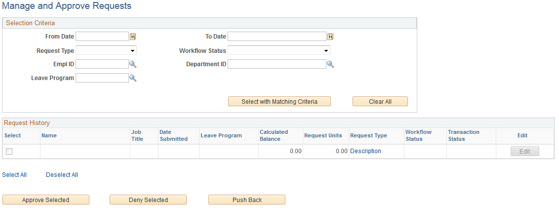

Manage and Approve Requests Page
Use the Manage and Approve Requests page (GP_ABS_LVDN_APPROV) to manage and approve leave donation requests.
Navigation:
Global Payroll & Absence Mgmt, and then Payee Data, and then Leave Donations, and then Manage/Approve Leave Donations, and then Manage and Approve Requests
This example illustrates the fields and controls on the Manage and Approve Requests page.
Use this page to edit existing requests to receive or donate leave time or to approve, deny, or push back one or more requests at one time.
The fields in the Selection Criteria region enable you to limit the number of entries displayed in the Request History region of the page.
Field or Control Description
Request Type
Select a value to filter the displayed entries in the Request History region based on the type of request.
Select one of the following values:
  • Adjust.
  • Donate to select requests to donate leave time.
  • Receive to select requests to receive donated leave time.
  • Return to select requests to return unused leave time.
  • Terminate to select requests to terminate participation in a leave transfer program.
Workflow Status
Select a value to filter the displayed entries based on the status of the request.
Select with Matching Criteria
Click this button to populate the Request History region of the page based on the specified selection criteria.

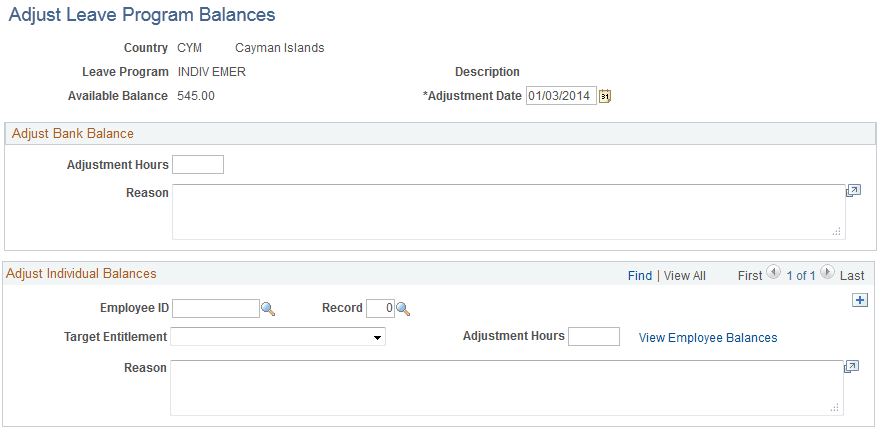

Adjust Leave Program Balances Page
Use the Adjust Leave Program Balances page (GP_ABS_LVDN_ADJ) to allocate leave time to one or more employees from a leave transfer program and transfer hours in or out of a leave transfer program and adjust the leave program bank balance.
Navigation:
Global Payroll & Absence Mgmt, and then Payee Data, and then Leave Donations, and then Adjust Leave Program Balances
This example illustrates the fields and controls on the Adjust Leave Program Balances page.
The Adjust Leave Program Balances page enables a leave transfer program administrator to handle exceptions, such as adjustments and write-offs. This page enables a program administrator to make adjustments to participating employees' balances. For example, an administrator can allocate time from a program bank to one or more individual employees.
Available Program Balance
Displays the available hours in the selected leave transfer program at the time of the last Leave Transfer Transaction process.
Adjust Bank Balance
Use the fields in this region to make manual adjustments to a leave transfer program balance for programs that have a leave program category of Bank. Indicate the number of hours to add or subtract from the bank balance, and any supporting comments related to the adjustment.
Adjustment Hours
Enter the number of hours to add or subtract from the balance of the specified leave transfer program. Use negative numbers to indicate hours that should be subtracted from a leave transfer program.
Adjust Individual Balances
Use the fields in this region to manually adjust a leave transfer program that uses the Individual leave program category.
Target Entitlement
Enter the entitlement plan that you want to adjust. You can only select entitlements that have been defined at the program definition level.
Adjustment Date
Enter the date of the adjustment in this field. The administrator can enter a date in the future for the adjustment to occur, as long as the date is prior to the end-date of the leave donation program.
View Employee Balances
Click to access the current Balance Inquiry page for the specified employee, including the leave transfer entitlement balances for donated, received, and returned entitlements.

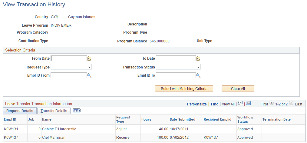

View Transaction History Page
Use the View Transaction History page (GP_ABS_LVDN_TRANS) to review leave donation transaction history.
Navigation:
Global Payroll & Absence Mgmt, and then Payee Data, and then Leave Donations History, and then View Transaction History
This example illustrates the fields and controls on the View Transaction History page.
From Date and To Date
Enter a range of dates for which you want to view the transaction history.
Request Type
Select the request types you want to view. Values are: All, Donate, Receive, Return, Terminate and Adjustment
Transaction Status
Select the status for the requests you want to view. Values are: All, Unprocessed, and Processed.
EmplID From (Employee ID From) and EmplID To (Employee ID To)
Enter a range of employee IDs for which you want to view the transaction history.
Click to populate the Leave Transfer Transaction Information region based on the criteria you specify..
Clear All
Click to clear the entries in the Selection Criteria region
Transfer Details
PI Entries (Positive Input Entries)
Click the links in this column to review the positive input for the entitlement on the Positive Input Details page.
