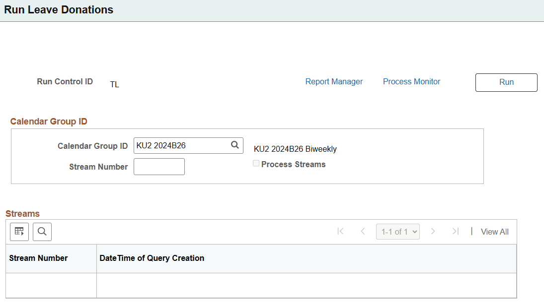

Run Leave Donations Page
Use the Run Leave Donations page (GP_ABS_LVDN_RUNCTL) to process all approved leave transfer requests.
Navigation:
Global Payroll & Absence Mgmt, and then Leave Donation Processing, and then Run Leave Donation Process
This example illustrates the Leave Donations tile.
Select the required Calendar group to process the approved leave transfer requests for that calendar.
