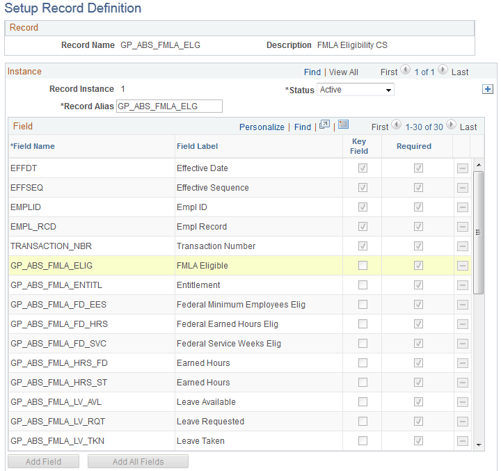

Setup Record Definition Page
Use the Setup Record Definition page (GP_ABS_RECDEFN) to identify the records and fields used in the extended absence template.
Navigation:
Set Up HCM, and then Product Related, and then Global Payroll & Absence Management, and then Absence Management, and then Setup Sections - Record Defn, and then Setup Record Definition
This example illustrates the fields and controls on the Setup Record Definition page.
Field or Control Description
Record Alias
Enter an alternate name for the table, the default value is the record name. Using an alternate name enables you to differentiate between different instances of the same record.
Key Field
This field displays the status of the selected field as a key field at the system level.
Required
Select to indicate that the selected field is required for your business process. You cannot change the setting here for fields that are defined as required fields at the system level.
Add Field
Click to add a new row to the group box. You can only select fields that are valid for the specified record.
Add All Fields
Click to add all of the available fields from the specified record.

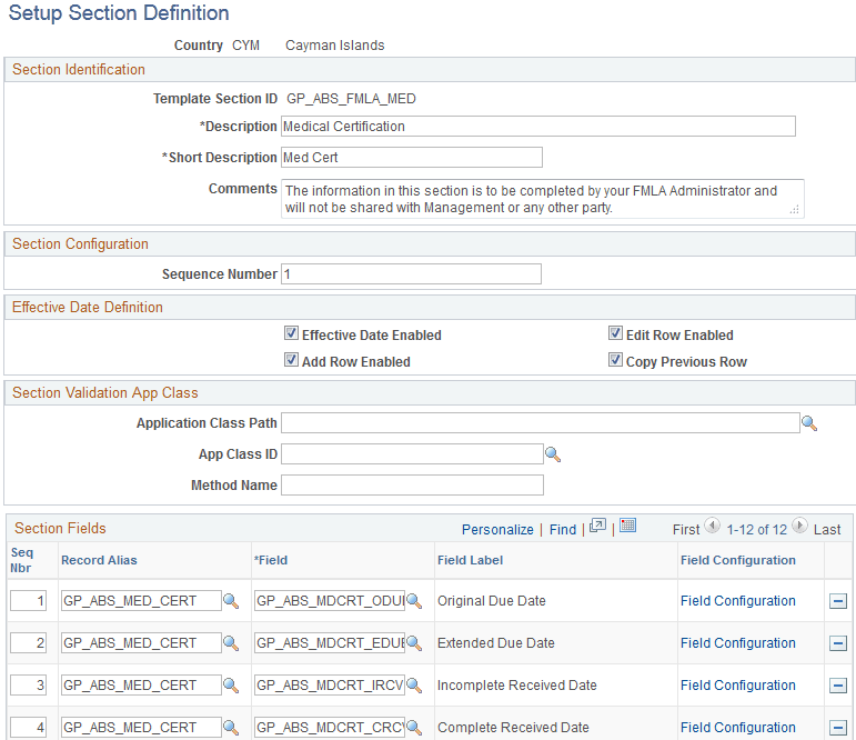

Setting Up Section Definition Page
Use the Setup Section Definition page (GP_ABS_SECDEFN) to combine records and fields into sections for use in the extended absence template.
Select the fields and the order in which fields appear in a section.
Navigation:
Set Up HCM, and then Product Related, and then Global Payroll & Absence Management, and then Absence Management, and then Setup Configurable Sections, and then Setup Section Definition
This example illustrates the fields and controls on the Setup Section Definition page.
Setup Section Definition page (1 of 2)
Setup Section Definition page (2 of 2)
Sequence Number
Enter a number to determine the order of sections on the data entry page
Effective Date Enabled
Select to add effective dated functionality to this section. You cannot select any of the other fields in the Effective Data Definition region until this field is selected.
Edit Row Enabled
Select to enable users to edit the section, unless the transaction is in display-only mode.
Add Row Enabled
Select to enable users to add new rows to the section, by clicking the Add button in the section.
Copy Previous Row
Select to copy the information from the previous row when a user adds a new row to the section. The sequence number and effective date are not copied from the previous row. Deselecting this field causes new rows to appear without any data from the previous row. The fields in the new row are empty and ready for input.
Application Class Path
Select an Application Class Path based on the Application Packages defined within the Application Designer.
App Class ID(Application Class ID)
Select an Application Class from the selected Application Class Path.
Method Name
Enter the executable method defined in the Application Class to trigger the validation of the configurable section.

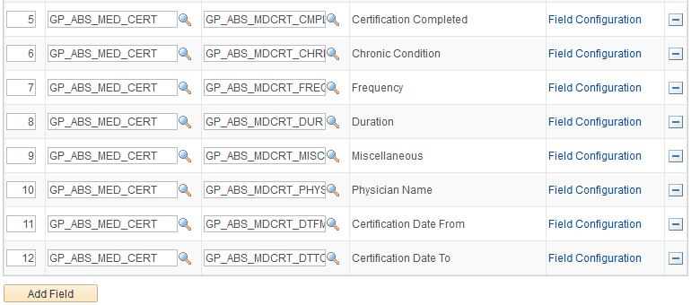

Section Fields
Record Alias
This refers to the field defined in the Record Definition. An alternate name for the table, the default value is the record name.
Field
The Record Field included on the page as part of the section.
Field Configuration
Click to access the Template Section Field Configuration page

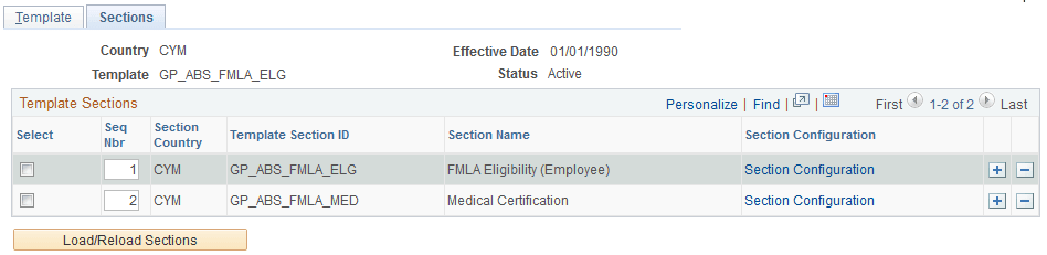

Configurable Section Setup - Sections Page
Use the Configurable Section Setup - Sections page (GP_ABS_TEMPL_DEF) to combine sections into a page in the extended absence feature.
Navigation:
Set Up HCM, and then Product Related, and then Global Payroll & Absence Management, and then Absence Management, and then Configurable Section Setup, and then Sections
This example illustrates the fields and controls on the Configurable Section Setup - Sections page.
Section Configuration
Click to access the Template Section Configuration page for the specified section.
Load/Reload Sections
Click to load the template sections from the template section setup table.

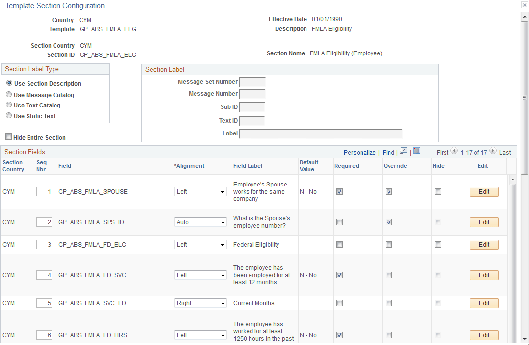

Template Section Configuration Page
Use the Template Section Configuration page (GP_ABS_TMPL_FLDS) to define the section field properties.
Specify whether certain fields are required, display-only or hidden. You can also enter default values.
Navigation:
Click the Section Configuration link on the Configurable Section Setup - Sections page.
This example illustrates the fields and controls on the Template Section Configuration page (1 of 2).
This example illustrates the fields and controls on the Template Section Configuration page (2 of 2).

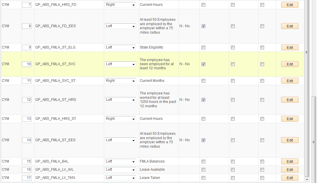

Section Label Type
Select the method used to choose the content of the section label in the specified template. Different fields in the Section Label region are available for entry depending upon the chosen Label Type. The following list describes the effect of choosing each Label Type on the Section Label region:
  • Selecting Use Section Description causes the system to use the description defined in the Section as the section heading on the extended absence configurable page. The user is not required to enter a label.
  • Selecting Use Message Catalog enables you to enter a Message Set Number and a Message Number.
  • Selecting Use Text Catalog enables you to enter a Sub ID and a Text ID.
  • Selecting Use Static Text enables you to enter text in the Label field.
Message Set Number and Message Number
Message sets and number settings come from the PeopleTools message set catalog. Select the message set and message number that you want to appear as the section label. You can select from the messages defined in the database. These fields are only available if you select the Use Message Catalog option in the Section Label Type region.
Sub ID and Text ID
Select the Text ID and Sub ID for the text catalog message you want to display as the section label. These fields are only available if you select the Use Text Catalog option in the Section Label Type region.
Label
Enter the text you want to appear as the section label. This field is only available if you select the Use Static Text option in the Section Label Type region.
Hide Entire Section
Select to specify that this section is hidden from the user.
For example, if certain information needs to be loaded into the buffer to support the validation, but does not need to be displayed.
Field
The Record Field selected in the section.
Alignment
Select the desired location of the field on the extended absence pages. You can specify that the field appears on the left or right side of the page, or indicate that the system should select the location, based on the available space. Values are: Left, Right, and Auto.
Field Label
Displays the field label used on the configurable page.
Default Value
The value that initially populates the record field.
Required
Defaulted from the Template Section Field Setup Table; can be overridden by the Template Administrator, but only if the default is No. A field required by definition of PeopleTools must remain required. However, a field that is not required by definition, can be made required on the template.
Override
Select to specify that the end user can enter or override the value of the specified field.
Hide
Select this field to hide the specified field from the end user.
Edit
Click to access the Section Field Default Value page.
