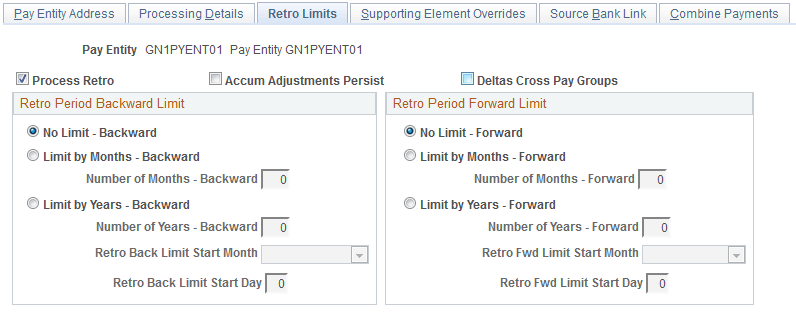

Retro Limits Page
Use the Retro Limits page (GP_PYENT_RETRO) to define the backward and forward limits for retro processing at the pay entity level.
Navigation:
Set Up HCM, and then Product Related, and then Global Payroll & Absence Mgmt, and then Framework, and then Organizational, and then Pay Entities, and then Retro Limits
This example illustrates the fields and controls on the Retro Limits page.
Retro Limits page
After you have defined a retro method and the events that trigger retro processing, you must specify the backward and forward limits for retro processing at the pay entity level. This tells the system how far back in time to go to recalculate closed calendars, and how long a payee is eligible for retroactive processing after being inactivated or terminated.
You can override backward and forward limits you define at the pay entity level using the Retro Limits Assignment page at the payee level.
Retro Period Backward Limit
Use the fields in this group box to limit the number of calendar periods that Absence Management can reprocess going into the past.
To determine how far back to go, the system compares the backward limit defined on the Retro Limits page to the retro trigger effective date. If the trigger effective date comes before the backward limit date, the system uses the backward limit date to determine the first retro period. If the backward limit date comes before the trigger effective date, the system uses the trigger date to determine the first retro period to process.
Field or Control Description
Process Retro
Select to enable retroactive processing at the pay entity level. You can override your selection at the payee level.
Acm Adjustments Persist(accumulator adjustments persist)
Select to retain adjustments to accumulator balances when retroactive processing causes an accumulator to be recalculated in a prior period. This option may be needed because Absence Management does not automatically include adjustment amounts when recalculating accumulator balances. For example, if you select this check box and reprocess a prior period in which an accumulator with a value of 100 received an adjustment of 10, the system computes the incoming balance as the sum of the original accumulator and the user-entered adjustment, and returns a value of 110. Otherwise, the system ignores the adjustment and returns a balance of 100.
Note: The preferred approach to managing accumulator balances is to correct the elements (entitlements or takes) that contribute to the accumulator, rather than to adjust the accumulator directly. This is because other accumulators that store period-to-date amounts or other values based on the calculation of the same elements will not be automatically updated, possibly resulting in calculation or reporting errors.
Note: To adjust accumulator balances, use the Adjust Accumulator Balance page.
See Adjusting Accumulator Balances.
Deltas Cross Pay Groups
Leave this check box empty. It applies only to Global Payroll.
No Limit - Backward
If you select this option, then retro processing begins with the first period that includes the trigger effective date and goes forward.
Selecting this option does not mean that there are no limits to how far back you can go. The No Retro Processing Before date limits how far back in time you can go to process retroactivity.
Limit by Months - Backward and Number of Months - Backward
To define a limit in terms of months, select this option and enter the number of months that the system can calculate into the past. The system determines the maximum number of months to go back starting from the begin date of the first calendar in the current calendar group for the payee.
Limit by Years - Backward and Number of Years - Backward
To define a limit in years, select this option and enter the number of years that the system is to calculate into the past. This limit year, in conjunction with the Retro Back Limit Start Month and Retro Back Limit Start Day fields, determines how far back the system can go when processing retroactivity.
For example, if Number of Years - Backward is 2, Retro Back Limit Start Month is 06 (June), Retro Back Limit Start Day is 01, and the current period begin date is April 1, 2005, then the backward limit is June 1, 2003. The system allows retroactivity 2 years from the current period begin date, but not prior to June 1 of that year.
Select the calendar month to use as the backward limit.
Select the day to use as the backward limit.

Retro Period Forward Limit
Use the fields in this group box to specify the amount of time that retroactive data can continue to be processed after a payee is terminated or becomes inactive.
No Limit - Forward
If you select this option, retroactive data can be processed indefinitely for inactive payees belonging to this pay entity. Although eligible for retro processing, the inactive payee is still restricted by the backward limits.
Limit by Months - Forward and Number of Months - Forward
To define the forward limit in months, select this option and enter the number of months to continue calculating retroactivity after a payee becomes inactive. The system determines the maximum number of months using the Inactive date of the last active job.
Limit by Years - Forward and Number of Years - Forward
To define the forward limit in years, select this option and enter the number of years beyond the inactive date to process retro. The year, in conjunction with the Retro Fwd Limit Start Month and Retro Fwd Limit Start Day, determines how long after the inactive date the system allows retroactivity processing.
Retro Fwd Limit Start Month (retro forward limit start month)
Enter the calendar month to use as the forward limit in conjunction with the year in the Number of Years - Forward field.
Retro Fwd Limit Start Day (retro forward limit start day)
The day to use as the forward limit in conjunction with the year and month entered in the Number of Years - Forward and Retro Fwd Limit Start Month fields. For example, if the Number of Years is 2, the Retro Fwd Limit Start Month is 06 (June), the Retro Fwd Limit Start Day is 01, and the termination date is January 1, 2005, the limit for processing retroactivity would be June 1, 2007. In this example, the system knows to allow retroactivity for 2 years from the Inactive date, but not after June 1 of that year.
