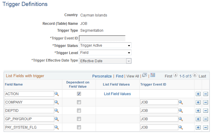

Trigger Definitions Page
Use the Trigger Definitions page (GP_TRGR_SETUP) to define iterative, segmentation, and retroactive triggers.
To create a retroactive or segmentation trigger, first define the appropriate event ID on the Retro Event Definition page or Segmentation Event Definition page.
Navigation:
Set Up HCM, and then Product Related, and then Global Payroll & Absence Mgmt, and then Triggers, and then Trigger Definitions, and then Trigger Definitions
This example illustrates the fields and controls on the Trigger Definitions page.
The fields on this page vary depending on the type of trigger you are creating and the values you select.

Trigger Type
Displays the trigger type that you selected to access this page. Options are: Iterative, Retro, and Segmentation.
Trigger Event ID
For retro and segmentation triggers, specify the trigger event ID at the record level, the field level, or the field value level:
  • If the Trigger Level is Record, specify the trigger event ID in the Trigger Event ID field at the top of the page.
    Note: This field isn't available at the record level when the trigger type is Segmentation and trigger level is Field.
    Note: The Trigger Event ID, record level field is replaced by the Primary Event ID field when the trigger type is Retro and the Trigger Level is Field (see below).
  • If the Trigger Level is Field-Non Value Based, specify the trigger event ID in the Trigger Event ID field in the List Fields With Trigger group box.
  • If the Trigger Level is Field-Value Based, specify the trigger event ID in the Field Values group box on the Trigger Definitions-Field Values page.
Note: Iterative triggers don't have trigger event definitions, because their only function is to process a payee in the current open calendar; therefore, the defined event is always the same.
Trigger Status
To activate the trigger definition, select Active.
Trigger Level
Select Record if you want the system to generate a trigger in response to a change to any field in the record; select Field if you want the system to generate a trigger in response to changes to a specific field or group of fields in the record.
If you select Field, you must list the fields that you want to make sensitive to data changes in the Field column in the List Fields With Trigger group box. You can further restrict the data changes that result in trigger generation by selecting the Dependent on Field Value Action check box for a specific field, click the List Field Values link, and specifying the values that should result in trigger generation.

Trigger Effdt Type
This field displays one of the following values, based on the record specified in the Record (Table) Name field:
Effective Date
Begin-End Date
Fixed Date
Only retro triggers can have a trigger effdt type of Fixed Date. To generate retro triggers with a fixed trigger effective date, you must pass the date as a parameter to the generic PeopleCode function Generate_Triggers. The system generates only one trigger regardless of the number of data changes.
See Reviewing PeopleSoft Delivered Triggers.
List Fields with Trigger
If you select Field in the Trigger Level field, the List Fields With Trigger group box becomes available.
Field or Control Description
Field Name
Enter the name of the field that you want to make sensitive to data changes.
Select this check box to indicate that the fields that you've defined as sensitive to data changes are dependent on specific field values. In this case, only changes to the values you specify on the Trigger Definition - Field Values page will trigger a system action. This enables you to limit the kinds of changes that cause iterative, retroactive, or segmentation processing.
List Field Values
This link becomes available when you select the Dependent on Field Value check box.
Click to access the Trigger Definitions - Field Values page, where you can list the field values that trigger an action.
Trigger Event ID
This field is required when the trigger level is Field and Dependent on Field Value is cleared. Based on the type of trigger you are defining, enter an event ID that you defined on either the Retro Event Definition page or the Segmentation Event Definition page.
Note: This field is not used with iterative triggers.

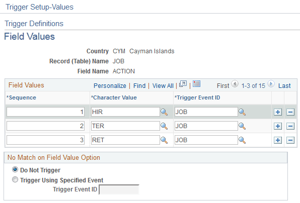

Trigger Definitions - Field Values Page
Use the Trigger Definitions - Field Values page (GP_TRGR_SETUP_SEC) to indicate which field values initiate actions.
Navigation:
Click the List Field Values link on the Trigger Definitions page.
This example illustrates the fields and controls on the Trigger Definitions – Field Values page.
Field Values
Sequence
Enter a sequence number, which the system needs to uniquely identify the field values and distinguish them from other rows of data that you might set up.
Numeric Value
If the record and field combination stores numeric values, this field is available for entry. Enter the value that triggers a system action.
Character Value
If the record and field combination stores character values, this field is available for entry. Enter the value that triggers a system action.
Date Value
If the record and field combination stores date values, this field is available for entry. Enter the value that triggers a system action.
Trigger Event ID
This field is required when the trigger level is Field and Dependent on Field Value is selected. Based on the type of trigger you are defining, enter an event ID that you defined on either the Retro Event Definition page or the Segmentation Event Definition page.
Offset Days
This field is available only when the trigger type is Retro.
Enter a positive or negative number to increase or decrease the retro trigger effective date relative to the date of a database change. For example, if you enter -1 in the Offset Days field for one of the values listed in the Field Values group box, and you retroactively enter that value into the database with an effective date of January 1, 2000, the system automatically adjusts the trigger effective date to December 31, 1999 (one day earlier). The system then processes pay periods going back to December 1999 rather than January 2000.
No Match on Field Value Option
Use the fields in this group box to specify a default trigger event ID to use when a change to a field involves values other than those listed on the Trigger Definitions – Field Values page. Use these fields only if you want these other values to trigger iterative, retro, or segmentation processing.
Do Not Trigger
This option is selected by default because the system assumes that triggers should be generated only when there is a match between values actually entered in the database and the field values that you identify on the Trigger Definitions – Field Values page.
Trigger
When you select this option, the Trigger Event ID field becomes available for entry.
Trigger Event ID
Enter a default trigger event ID to use to process field values that are not linked to a trigger event ID on the Trigger Definitions – Field Values page.
