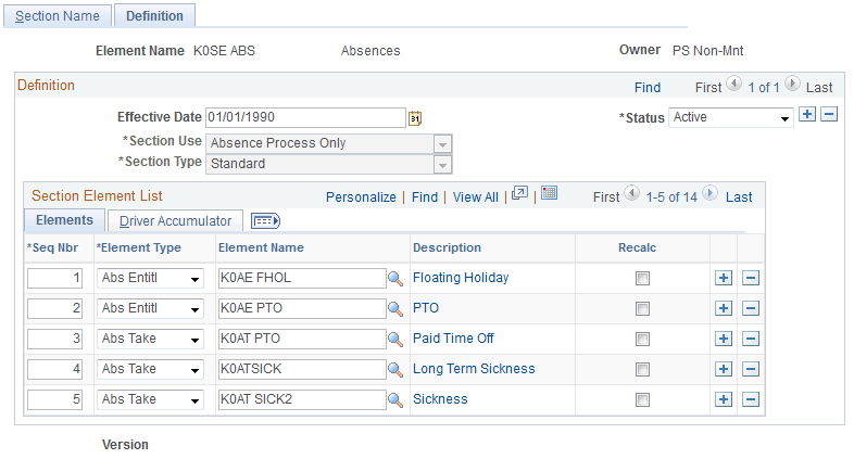

Sections - Definition Page
Use the Sections - Definition page (GP_SECTION) to select elements that constitute a section.
Navigation:
Set Up HCM, and then Product Related, and then Global Payroll & Absence Mgmt, and then Framework, and then Processing, and then Sections, and then Definition
This example illustrates the fields and controls on the Sections - Definition page.
Field or Control Description
Section Use
This field displays Absence Process Only. You cannot change this value.
Section Type
Select the section type. This specifies how the Process List Manager processes the elements in this section. Options are Standard, Absence Take, and Payee Section.
If you select Payee Section, all fields become unavailable for entry. After saving this page, you can access the Section Overrides page and select the elements to be resolved for a particular payee.
Element Type
Select the type of element that you're adding to the section. Values depend on your Section Type selection:
Standard sections: Select Abs Entitl (frequency-based absence entitlement), Abs Take (absence take), Accumulator, Array, Bracket, Count, Date, Duration, Formula, Hist Rule (historical rule), Rate Code, Section, System Element, Variable, or Writable Array.
Absence take section: Select Abs Take.
Element Name
Enter the name of the element to include in the section. Selectable names depend on the element type.
The Driver Accumulator tab is used with PeopleSoft Global Payroll only.

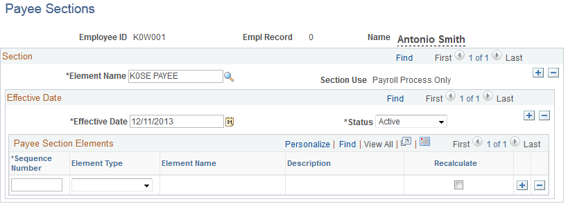

Payee Sections Page
Use the Payee Sections page (GP_PYE_SECTION) to create a payee section for a process list.
Navigation:
Global Payroll & Absence Mgmt, and then Payee Data, and then Create Overrides, and then Payee Sections, and then Section Overrides
This example illustrates the fields and controls on the Payee Sections page.
Payee Sections page
Before using this page, create a payee section using the Sections - Section Name and Sections - Definition pages.
Element Name
Enter the name of the payee section, as defined on the Sections - Section Name page.
Section Use
When you select the element name, the system displays Absence, to identify the purpose of the section.
Payee Section Elements
Element Type
Select the type of element that you're adding to the section: Absence Entitlement (frequency-based entitlement elements), Absence Take, Accumulator, Array, Bracket, Count, Date, Duration, Formula, Historic Rule, Rate Code, Section - Absence Take, System Element, Variable, or Writable Array.
Element Name
Select the name of the element that you're adding to the section.
