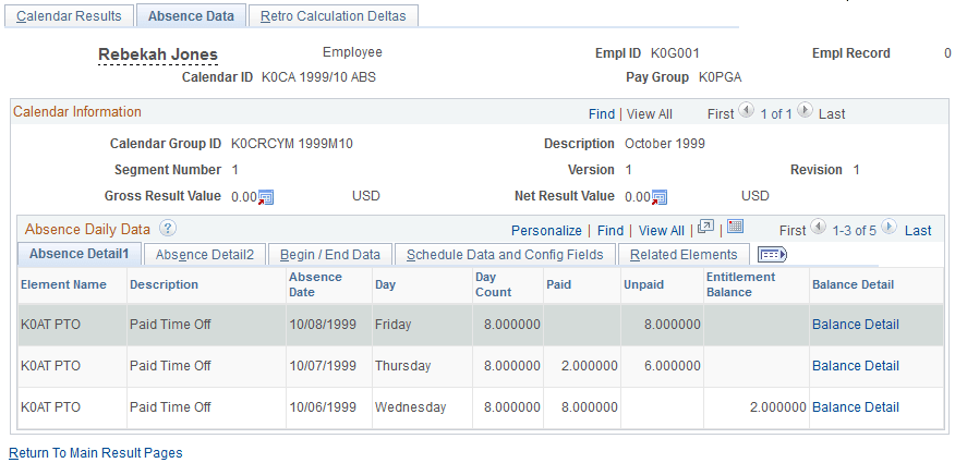

Use the Absence Data page (GP_RSLT_CAL_ABS) to view the daily results of the Absence Take process, including the day count, paid and unpaid day count, ending entitlement balance, forecast value, absence type, and reason.
Navigation:
  • Global Payroll & Absence Mgmt, and then Absence and Payroll Processing, and then Review Absence/Payroll Info, and then Results by Calendar, and then Calendar Results
    Click the Absence Data link on the Calendar Results page.
  • Global Payroll & Absence Mgmt, and then Absence and Payroll Processing, and then Review Absence/Payroll Info, and then Results by Calendar Group, and then Calendar Group Results
    Click the Absence Data link on the Calendar Group Results page.
This example illustrates the fields and controls on the Absence Data page.
Absence Data page
Field or Control Description
Day Count
Displays the result of the Day Formula for the absence take element.
Entitlement Balance
Displays the number of paid absence days to which the payee is entitled after taking this absence into account.
Balance Detail
Click to open the Absence Balance Data page to view additional information about the absence.

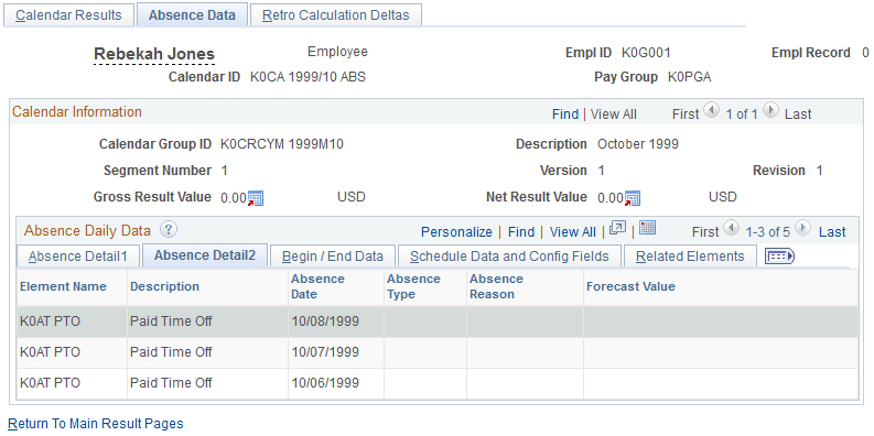

Absence Detail2
Access the Absence Detail2 tab.
This example illustrates the fields and controls on the Absence Data page: Absence Detail2 tab.
The Forecast Value field displays the forecast value for the last day of the absence event.

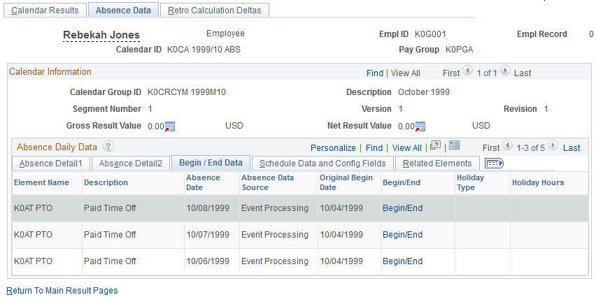

Begin/End Data
Access the Begin/End Data tab.
This example illustrates the fields and controls on the Absence Data page: Begin/End Data tab.
Absence Data Source
Displays the absence process that generated the absence event:
Take Processing: The row was created when a negative entitlement balance was redirected to another take element (according to instructions on the Absence Take - Negative Balance page) or when the “mapped to” feature (defined on the Absence Take - Day Formula page) resulted in the creation of a second absence event.
Event Processing: The row was created when the absence event was expanded into daily rows during the Absence Take process.
Original Begin Date
If this is a linked absence, the original begin date from the Absence Event Entry page appears.
Begin/End
Click to view the Begin/End Data tab to view information about partial-day absences.
Holiday Type
If the absence occurred on a holiday, the type of holiday is identified: BRG (bridge), CAN (Canadian), HIGH, LOW, STD (standard), USA (USA public), and VERY (very high).
Holiday Hours
Displays the number of hours from the Holiday schedule.

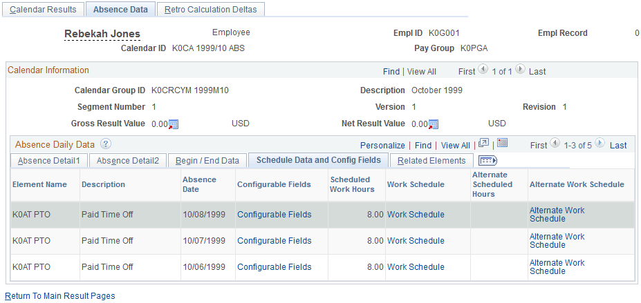

Schedule Data and Config Fields (schedule data and configuration fields) Tab
Access the Schedule Data and Config Fields tab.
This example illustrates the fields and controls on the Absence Data page: Schedule Data and Config Fields tab.
Configurable Fields
Click to access the Configurable Fields page to view information from the User Defined fields that are associated with the absence event and absence take element.
Scheduled Work Hours
Displays the number of hours that the payee was scheduled to work on the absence date.
Work Schedule
Click to access the Absence Configurable Data page to view the payee’s Work Day ID, data that is contained in the User Defined fields, and information about schedule overrides.
Alternate Scheduled Hours
Number of hours that the payee was scheduled to work, according to the payee’s alternate work schedule, on the absence date.
Alternate Work Schedule
Click to access the Alternate Work Schedule Data page to view the payee’s Work Day ID, data that is contained in the User Defined fields, and information about schedule overrides for the alternate work schedule.

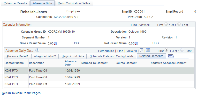

Related Elements
Access the Related Elements tab.
This example illustrates the fields and controls on the Absence Data page: Related Elements tab.
Mapped to Element
If the absence take element that is associated with the payee’s absence is mapped to another take element (through the Take - Day Formula page), the name of the absence take element for which the system will generate a matching absence event appears.
Source Element
Displays the absence take element that triggered generation of a second absence event.
Negative Absence Element
If the event resulted in a negative entitlement balance, and you selected Take with Other Absence for this take element (on the Absence Take - Negative Balance page), the name of the specified take element appears.
