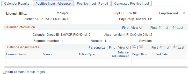

Positive Input - Absence Page
Use the Positive Input - Absence page (GP_RSLT_CAL_AE) to view balance adjustments made to frequency-based entitlement elements that are processed for the absence calendar.
Navigation:
  • Global Payroll & Absence Mgmt, and then Absence and Payroll Processing, and then Review Absence/Payroll Info, and then Results by Calendar, and then Calendar Results
    Click the Positive Input - Absence link on the Calendar Results page.
  • Global Payroll & Absence Mgmt, and then Absence and Payroll Processing, and then Review Absence/Payroll Info, and then Results by Calendar Group, and then Calendar Group Results
    Click the Positive Input - Absence link on the Calendar Group Results page.
This example illustrates the fields and controls on the Positive Input - Absence page.
Field or Control Description
Source
Absence means that the instance of positive input was created by the Absence Take process.
Balance Adjustment
The number of units by which the entitlement balance for this absence take element is being adjusted, if applicable.
Begin Date and End Date
The first day and last day of the absence event.

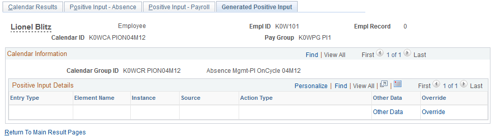

Generated Positive Input Page
Use the Generated Positive Input page (GP_RSLT_CAL_GPI) to view resolved and unresolved positive input that was created for another calendar from a generated positive input section of the process list or the absence take process.
Navigation:
  • Click the Generated Positive Input link on the Calendar Results page.
  • Click the Generated Positive Input link on the Calendar Group Results page.
This example illustrates the fields and controls on the Generated Positive Input page.
Other Data
Click to display the Other Data page to view detailed information about the instance of positive input.
Override
Click to display the Supporting Element Overrides page to view information for supporting elements that are associated with the generated instance.
