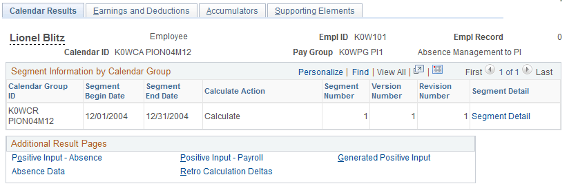

Calendar Results Page
Use the Results by Calendar - Calendar Results page (GP_RSLT_CAL_SEG) to view segmentation information for a payee.
Page includes links to other pages that display positive input, absence, and retroactive results.
Navigation:
Global Payroll & Absence Mgmt, and then Absence and Payroll Processing, and then Review Absence/Payroll Info, and then Results by Calendar, and then Calendar Results
This example illustrates the fields and controls on the Calendar Results page.
Field or Control Description
Segment Detail
Click to display the Result Segment Detail page.

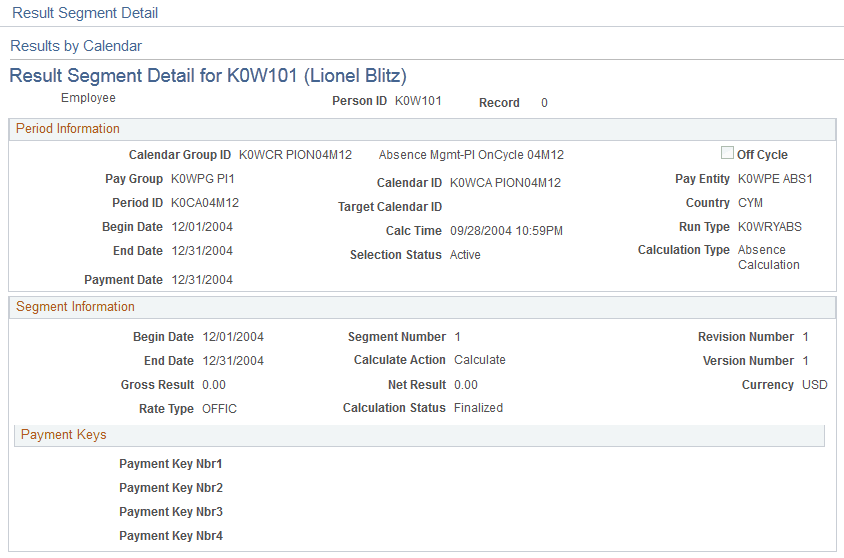

Results by Calendar - Result Segment Detail Page
Use the Results by Calendar - Result Segment Detail page (GP_RSLT_SEG_SP) to view more information about a segment’s process and segment statuses.
Navigation:
Click the Segment Detail link on the Results by Calendar page.
This example illustrates the fields and controls on the Results by Calendar - Result Segment Detail page.
Period Information
Period ID
The ID for the time period that is covered by the calendar.
Begin Date and End Date
The begin and end dates that are associated with the Process Stat record. The dates match the calendar begin and end dates.
Target Calendar ID
The target calendar that you selected when defining the calendar for this calendar run.
Calc Time (calculation time)
The last time that calculations were run for this payee.
Segment Information
Rate Type
The exchange rate type associated with the payment. (You define the exchange rate type on the Pay Group Name page and can override it by payee.)
Calculation Status
Values are:
Active in Segment: Payee was active for at least one day during the calendar segment.
Inactive in Segment: Payee was not active during that time period.
Transaction Type
Appears for off-cycle results. Values are Correction and Advance.
Payment Keys
This group box displays any payment keys that have been defined for the payee’s pay entity.

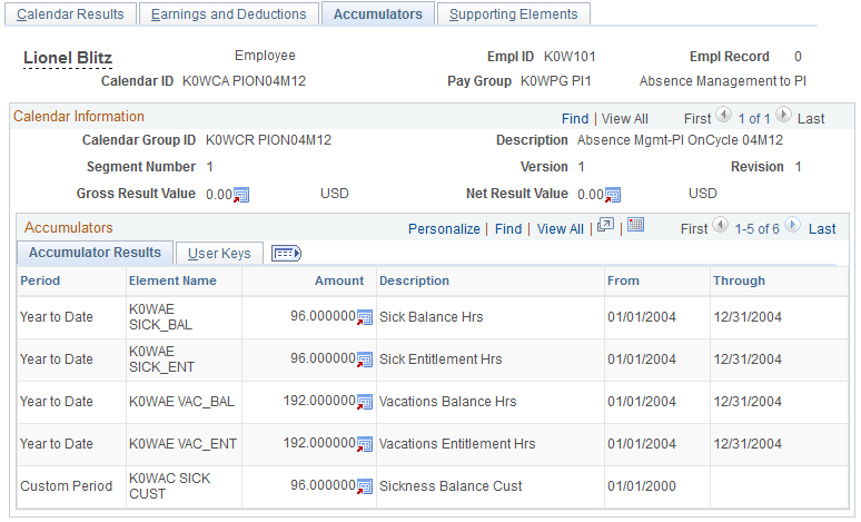

Results by Calendar - Accumulators Page
Use the Results by Calendar - Accumulators page (GP_RSLT_CAL_ACUM) to view accumulator amounts.
Navigation:
Global Payroll & Absence Mgmt, and then Absence and Payroll Processing, and then Review Absence/Payroll Info, and then Results by Calendar, and then Accumulators
This example illustrates the fields and controls on the Results by Calendar - Accumulators page.
Accumulator Results
Period
The period of time tracked by the accumulator.
User Keys
This tab displays the system element or variable element that is associated with the user keys for each accumulator.

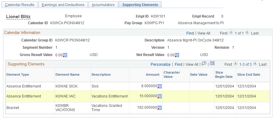

Results by Calendar - Supporting Elements Page
Use the Results by Calendar - Supporting Elements page (GP_RSLT_CAL_PIN) to view information for each supporting element that was used to calculate absence results.
Navigation:
Global Payroll & Absence Mgmt, and then Absence and Payroll Processing, and then Review Absence/Payroll Info, and then Results by Calendar, and then Supporting Elements
This example illustrates the fields and controls on the Results by Calendar - Supporting Elements page.
The type of value that the supporting element resolved to determines the column that it is listed under Amount, Character Value, or Date Value.
Slice Begin Date and Slice End Date
The begin and end dates of the slice in which the supporting element was resolved.
