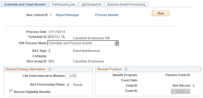

Schedule and Chkpt Restart Page
Use the Schedule and Chkpt Restart (schedule and checkpoint restart) page (BAS_RUNCTL1) to specify a process to run by identifying the Open Enrollment, Event Maintenance, or Snapshot schedule for which you're planning to run the Benefits Administration process.
Navigation:
Benefits, and then Manage Automated Enrollment, and then Events, and then Run Automated Event Processing, and then Schedule and Chkpt Restart
This example illustrates the fields and controls on the Schedule and Chkpt Restart page. You can find definitions for the fields and controls later on this page.
Field or Control Description
Schedule ID
Select the schedule to run. When the schedule is selected, the page displays the BAS type (Open Enrollment, Event Maintenance, or Snapshot). The BAS type of the schedule determines which features you can access on other run control pages.
The page also displays the company and BAS group ID defined on the Schedule table.
EM Process Mode (event maintenance process mode)
If you selected an Event Maintenance schedule, select the EM Process Mode:
  • Schedule and Process Events: All BAS Activity entries are retrieved and events are created and assigned to all appropriate schedules. Then, any events belonging to the current schedule are processed further during this run.
  • Schedule New Events Only: All BAS Activity entries are retrieved and events are created and assigned to all appropriate schedules, but they are not processed further during this run.
  • Process Existing Events Only: Only existing events belonging to the current schedule are processed.
Chk Point Interval in Minutes (check point interval in minutes)
Indicate a number of minutes between commits; 60 is a reasonable number.
If a job terminates abnormally, values for the last record processed appear in Restart Position.
Record Eligibility Results
Use to troubleshoot benefits processing errors related to eligibility.
When this option is selected, the system checks eligibility for all benefit programs and for all options within the benefit programs for which the participant is eligible. It records the results of these checks on the Review Eligibility Results page. In normal processing, the system stops checking eligibility the first time a participant fails an eligibility check.
Note: You should run processes with Record Eligibility Results selected only for small processing populations because the act of checking and recording all types of eligibility can result in long process run times.
Clear
If a job terminates abnormally, values for the last record processed appear in Restart Position and the run control is locked (all fields are disabled, because the parameters should not be changed when the process is restarted). During implementation, you may encounter many instances of runs that end abnormally as you test your table setup. You may decide not to complete an interrupted schedule—the Clear button will unlock the schedule and its run control. This feature would not normally be used in a production environment.
The EM Process Mode allows for more efficient processing of very large participant populations. The Scheduling process is very fast, but it does not allow for multiple concurrent batch runs because of its updating of the BAS Activity table. The assignment, option preparation, validation, and finalization activities are slower and more intensive, but do allow for concurrent processing. Thus you can achieve maximum throughput by performing an initial Schedule Only run followed by several simultaneous Process Existing runs using multiple schedule IDs.
