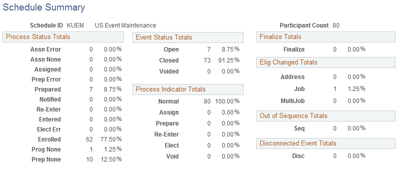

Enrollment Schedule Summary Page
Use the Enrollment Schedule Summary page (BAS_PARTIC_SUM) to review employee counts for all available status values.
Review process results for schedules.
Navigation:
Benefits, and then Manage Automated Enrollment, and then Review Processing Results, and then Enrollment Schedule Summary, and then Enrollment Schedule Summary
This example illustrates the fields and controls on the Enrollment Schedule Summary page. You can find definitions for the fields and controls later on this page.
The Schedule table shows the state of the schedule population at the current moment, so if you have participant events marked for finalization but have not run the process, they will show up in Finalize Totals. Once you run the process for that schedule, all events marked for finalization will be finalized and will not appear in Finalize Totals.
This page shows a cumulative total over the entire history of the schedule. You may occasionally retire an Event Maintenance schedule (mark it to allow No New Events,) and create a new schedule for new statistics.
Process Status Totals
Only one event can be open for any one participant and benefit record number combination at a time. However, these totals represent the sum of all events, open or closed.
Event Status Totals
Voided events are not considered for any further processing.
Process Indicator Totals
View the participant event totals that currently have been requested to go through reprocessing.
When the system actually reprocesses events, the system removes them from these lists of totals as appropriate.
Finalize Totals
Displays the number of participant events that are currently marked to be finalized or to have defaults applied to them, but which have not yet been run through the Benefits Administration process.
You can flag individual events to be finalized and to have option defaults applied to them by selecting the Final check box for those events in the Controls page of the Processing Controls Update component.
Elig Changed Totals (eligibility changed totals)
View the number of participant events that may need to be reprocessed.
The system flags these events when the HR data used for processing event eligibility is changed, a new row affecting eligibility is inserted, or the row used for eligibility is deleted.
Three categories of eligibility changes exist: address (state or postal code), job information, and multiple jobs (changes to primary job flags).
Out-of-Sequence Event Totals
View the number of events that have been processed out of sequence by the system for the selected schedule.
An out-of-sequence event might need to be reprocessed because an earlier, opened event might have changed the defaults, eligibility, or event rule processing results for the later, closed event.
Disconnect Event Totals
View the number of disconnected events detected by the system during processing for the selected schedule.
Events can become disconnected when one or more of the HR records (PERSON, PERS_DATA_EFFDT, EMPLOYMENT, JOB) that is needed for eligibility processing for the event have been deleted.

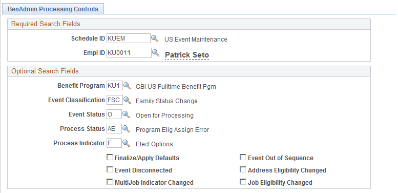

BenAdmin Processing Controls Page — Entering Search Criteria to Review Process Results
Use the BenAdmin Processing Controls (benefits administration processing controls) page (BAS_PARTIC_PRC1) to enter search criteria to review the processing status of specific participant event records.
Navigation:
Benefits, and then Manage Automated Enrollment, and then Events, and then Update Event Process Controls, and then BenAdmin Processing Controls
This example illustrates the fields and controls on the BenAdmin Processing Controls page to enter search criteria to review process results for participant events. You can find definitions for the fields and controls later on this page.
Enter your search criteria for the set of participant event records that you want to review or update. When you initiate a search, the system displays the results page to review the process status information of the participant event records that match your search criteria.
You might use the Schedule Summary page to get an idea of the overall processing status of your schedule before using the Processing Controls Update pages.
Field or Control Description
Schedule ID and Empl ID (employee ID)
You must use one or the other of these options as selection criteria to focus your search on either a participant or a schedule.
Note: Selecting a particular employee ID locates all event records for that employee with a process status value assigned to him or her: only one event will be open, but multiple ones might be closed or void events.
Finalize/Apply Defaults
Locates events that have been flagged to be finalized or have option defaults applied.
You flag events this way with the Final check box on the Processing Controls Update - Controls page.

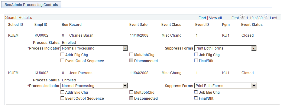

BenAdmin Processing Controls Page — Reviewing Processing Results for Participant Events
Use the BenAdmin Processing Controls (benefits administration processing controls) page (BAS_PARTIC_PRC1) to review the processing status of specific participant event records.
Navigation:
This example illustrates the fields and controls on the BenAdmin Processing Controls page. You can find definitions for the fields and controls later on this page.
This page displays the results from the criteria in the search fields.
Process Indicator
Tells the system the event status to which you want to reprocess the specific participant event on the next Benefits Administration run.
Addr Elig Chg (address eligibility change), Mult JobChg (multiple job change), and Job Elig Chg (job eligibility change)
Indicates that event eligibility changes, insertions, or deletions have occurred and the participant event may need to be reprocessed. If you determine that the event does not need reprocessing, you can deselect these check boxes to indicate this fact, although these flags are only informational.
Disconnected
Indicates that an event has been disconnected and can no longer be processed. Disconnected events are events that have lost rows in one of the core HR tables: PERSON, PERS_DATA_EFFDT, EMPLOYMENT, or JOB.
Final/Dflt (final/default)
Indicates that you want to finalize default benefit option elections or apply them to a specific participant event on the next run of the Benefits Administration process for the schedule to which the participant event is assigned, or both.

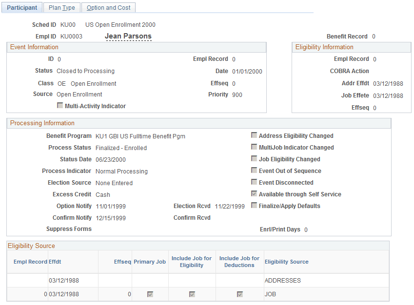

Participant Page
Use the Participant page (BAS_PARTIC_INQ1) to review status, processing, and eligibility information for a selected participant and event.
Navigation:
Benefits, and then Manage Automated Enrollment, and then Review Processing Results, and then Employee Enroll Event Detail, and then Participant
This example illustrates the fields and controls on the Participant page. You can find definitions for the fields and controls later on this page.
Participant page
Source
Displays the event trigger: a changed employee address, or job information; a passive event; or the insertion of a manual event.
Priority
Indicates the order of processing for events with different classes that occur for the same benefit record number on the same event date.
Multi-Activity Indicator
Indicates multiple activity records from the BAS Activity table had the same benefit record number, event date, and event class, and were merged into a single participant event.
COBRA Action
If the event is associated with an action that may make the employee eligible for COBRA coverage, the system displays that action code.
Empl Record (employment record number), Job Effdt (job effective date), and Effseq (effective sequence)
The keys of the primary job at the time of the event. See the Eligibility Source grid.
Addr Effdt (address effective date)
The effective date of the address (state or postal code) used for eligibility. See Eligibility Source grid.
Election Source
How the system received the employee's elections.
Option Notify, Confirmation Notify, Election Rcvd (election received), and Confirm Rcvd (confirm received)
The dates that you sent the employee his or her notification and confirmation letters, and the dates those letters were received.
Available through Self Service
If this option is selected, the participant can enter elections for the option processing results of this event through the PeopleSoft eBenefits application.
Eligibility Source
Shows the source of eligibility data that was used when the event was last processed. The first line is always the effective date of the ADDRESSES table that contributed address data to the eligibility processing.
The remaining rows show each job that may have contributed eligibility information and the Primary Job, Include Job for Eligibility, Include Job for Deductions check boxes, used primarily in multiple job processing.

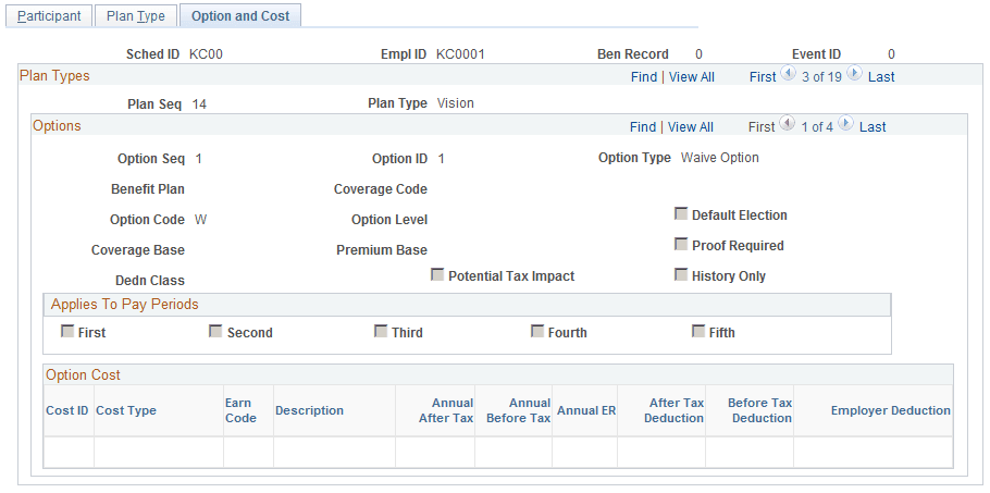

Option and Cost Page
Use the Option and Cost page (BAS_PARTIC_INQ4) to review costs and credits for a participant and plan type.
Navigation:
Benefits, and then Manage Automated Enrollment, and then Review Processing Results, and then Employee Enroll Event Detail, and then Option and Cost
This example illustrates the fields and controls on the Option and Cost page. You can find definitions for the fields and controls later on this page.
Default Election
When selected, this option indicates that the option will be assigned as a default to participants who fail to make their elections. It does not mean that this option has already been assigned to this participant as a default option.
Proof Required
When selected, this option means the participant must pass proof rules to legitimately enroll in the plan. These proof rules are stored in the event rules that you have defined for your Benefits Administration system.
Potential Tax Impact
Select to indicate whether a calculated deduction includes a possible tax effect, such as imputed income from group term life or dependent life.
History Only
Identifies options that the employee is eligible for but are not the result of the current event, and so cannot be chosen.
For example, when a participant undergoes an FSC (family status change) event, such as a marriage, the event rules enable the participant only to choose between options that are available as a direct result of the change in coverage status.
Annual After Tax, Annual Before Tax, and Annual ER
These fields display the tax-class detail for an option's annual cost as calculated by Benefits Administration. The employer cost represents the sum of any N-Tax and T-Tax cost components.
After Tax Deduction, Before Tax Deduction, and Employer Deduction
These fields display the tax-class detail for an option's per-pay-period cost as calculated by Benefits Administration. The employer cost represents the sum of any N-Tax and T-Tax cost components. It does not, however, include imputed income from life insurance plans.
