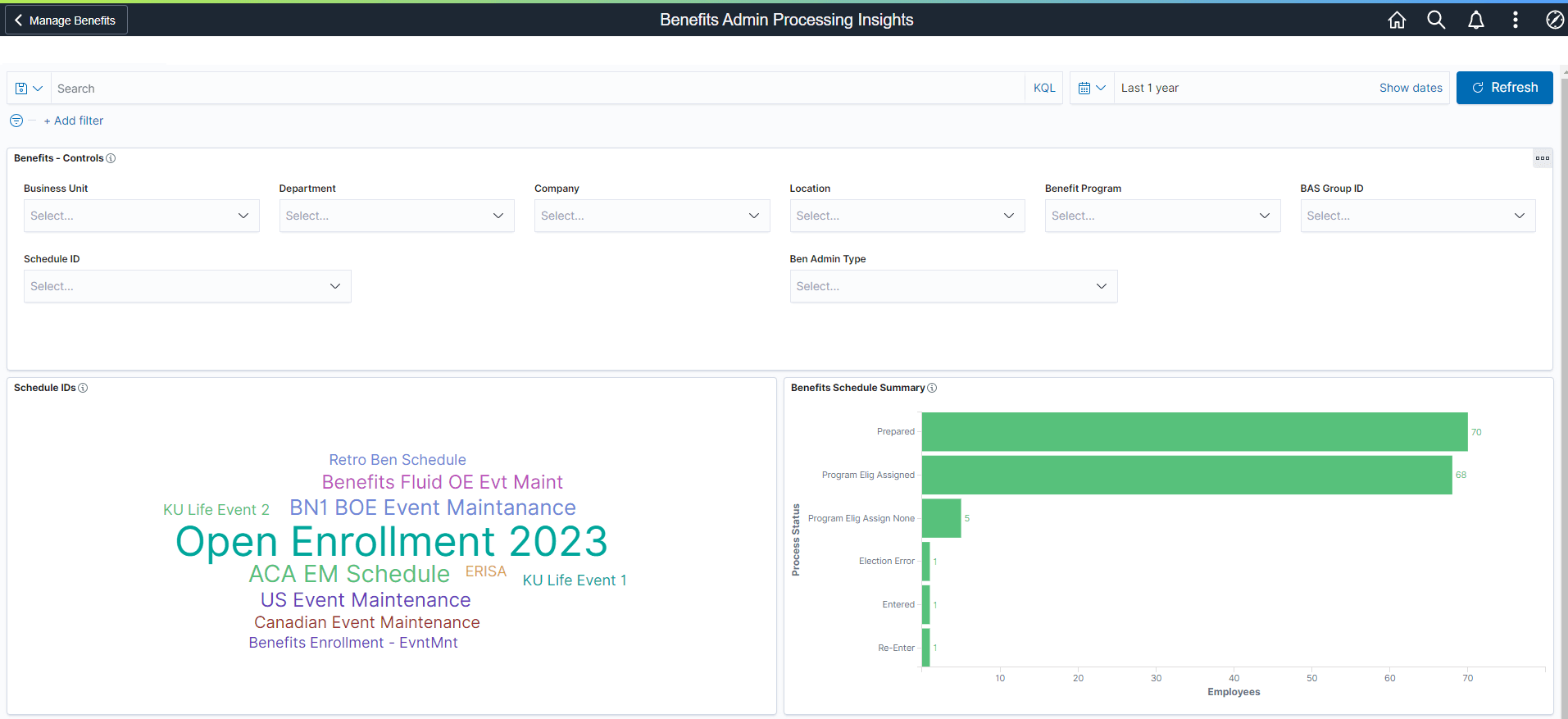

This example illustrates the Benefits Admin Processing Insights Dashboard (Page 1 of 2).
Ben Admin Processing Insights Dashboard (Page 1 of 2)

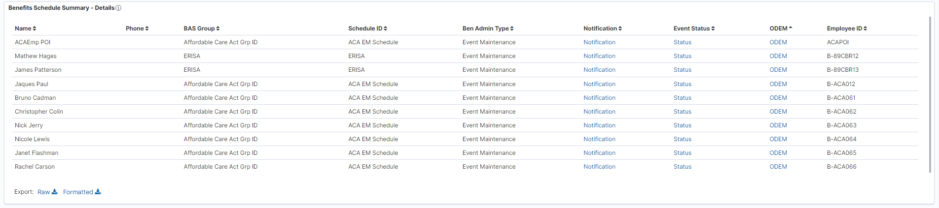

This example illustrates the Benefits Admin Processing Insights Dashboard (Page 2 of 2).
Ben Admin Processing Insights Dashboard (Page 2 of 2)

The Benefits Admin Processing Insights dashboard provides you with different visualizations to analyze the benefits schedule summary for your employees. When you select filters or chart items, Insights dynamically updates all visualizations using the sources from the index.
Each visualization enables you to inspect the chart, table or map to view the details of that visualization. Pause over a visualization to have the have additional page elements appear, view numbers, or click items to add filters to your visualizations.
The Benefits Admin Processing Insights dashboard delivers these visualizations:
  • Schedule IDs
  • Benefits Schedule Summary
  • Benefits Schedule Summary – Details
Additional Filters
Additional Filters allows you select filters based on below attributes:
  • Business Unit
  • Department
  • Company
  • Location
  • Benefit Program
  • BAS Group ID
  • Schedule ID
  • Ben Admin Type
For more information on working with PeopleSoft Insights and filters, see PeopleTools: Search Technology, “Working with Insights Dashboards for PeopleSoft Application Data” documentation.
Delivered Benefits Admin Processing Insights Visualizations
The Benefits Admin Processing Insights dashboard provides the following visualizations:
Visualization Description
Schedule IDs
This tag cloud visualization displays the schedule IDs. The bigger the font size, the larger the number of employees associated with the schedule ID. These tag clouds help administrators to easily filter the entire dashboard by a specific schedule ID.
This horizontal bar chart visualization displays the breakdown of employees by process status. The process statuses include: Entered, Notified, Prepared, Re-Enter, Election Error, Program Elig Assign Error, Program Elig Assign None, and Finalized – Enrolled. Administrators can filter by process status and view employee details for the filtered process status.
This grid visualization lists the benefits schedule summary data in a tabular format. Administrators can view the employee details for the available schedule IDs.
Click on the hyperlinks to view the specific pages for the selected employee:
  • Notification: Notify the employee.
  • Status: View the event status.
  • ODEM: View On-Demand Event Process page.
