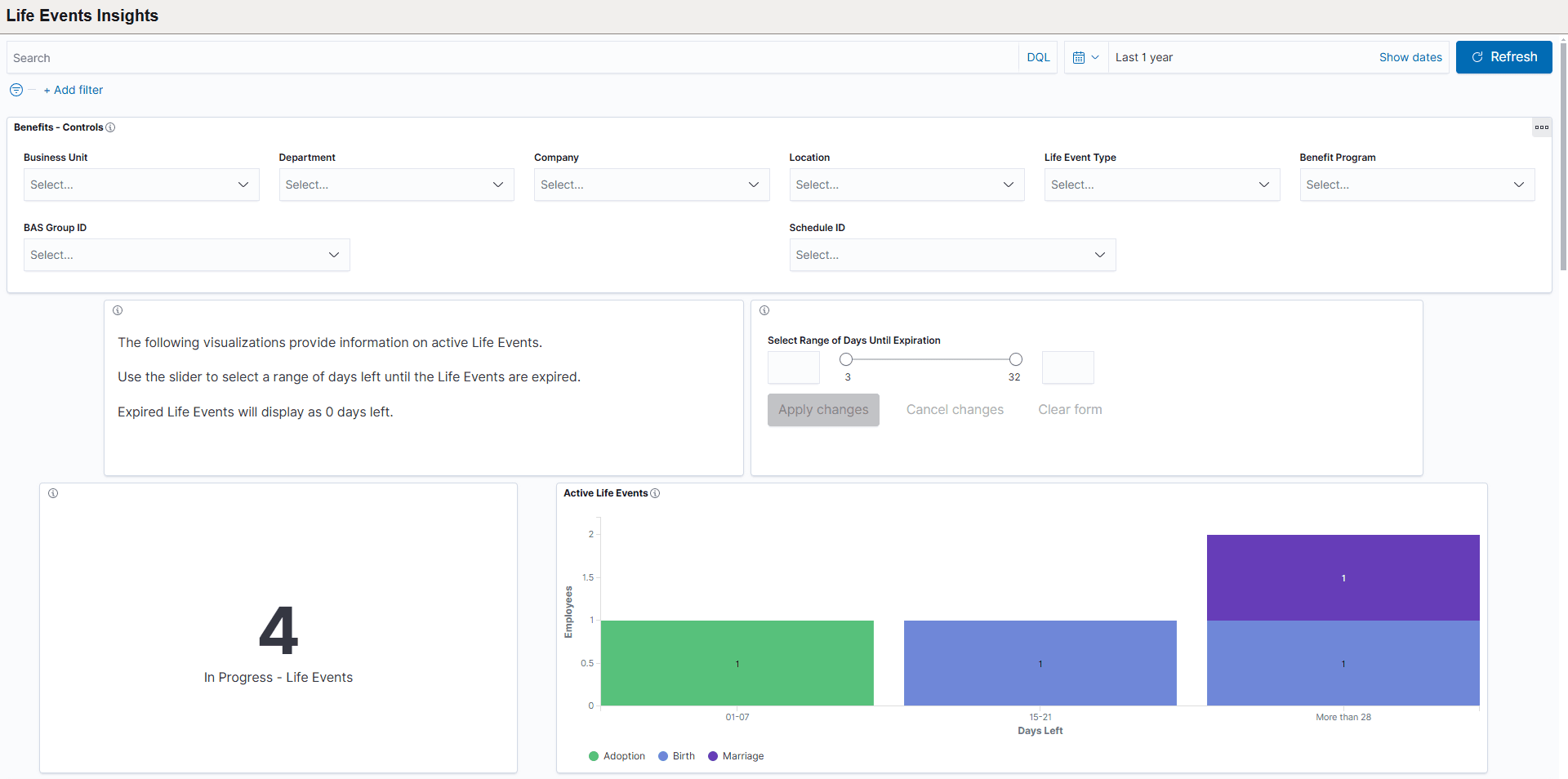

Life Events Insights Dashboard
Use the Life Events Insights dashboard (HC_HBN_LE_INSIGHTS_FL) to review and analyze life events data of employees using Insights visualizations.
Navigation:
Select the Life Events Insights Tile.
This example illustrates the fields and controls on the Life Events Insights dashboard (1 of 5).
Life Events Insights Dashboard (Page 1 of 5)
This example illustrates the fields and controls on the Life Events Insights dashboard (Page 2 of 5).
Life Events Insights dashboard ( Page 2 of 5)
This example illustrates the fields and controls on the Life Events Insights dashboard (3 of 5).
Life Events Insights Dashboard (Page 3 of 5)
This example illustrates the fields and controls on the Life Events Insights dashboard (4 of 5).
Life Events Insights Dashboard (Page 4 of 5)
This example illustrates the fields and controls on the Life Events Insights dashboard (5 of 5).
Life Events Insights Dashboard (Page 5 of 5)

Active Life Events
This stacked vertical bar visualization displays the breakdown of active life events distributed by employees and days to expiration. The first bar with zero days indicates the employees with expired life events. Select the sub-bars to filter by life event type.
This example illustrates the fields and controls on the Active Life Events visualization.

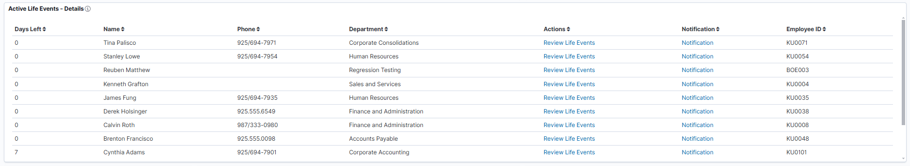

Active Life Events – Details
This data-grid lists the active life events in tabular format along with employee details.
Select Review Life Events link to open the employee's activity guide for the life event. The benefits administrator can close a life event for the employee by selecting the Complete button on the Summary page of the activity guide.
Select Notification link to send notification message to the selected employee.
This example illustrates the fields and controls on the Active Life Events – Details visualization.

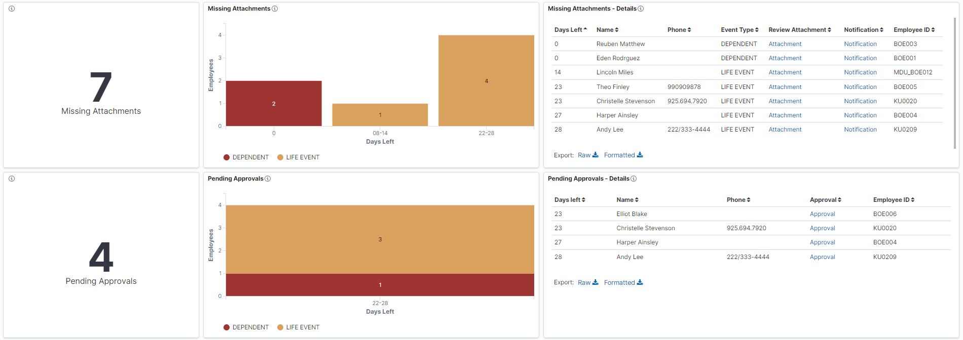

Missing Attachments
This compound bar chart visualization displays the breakdown of missing documents distributed by employees and days to expiration. Click on the bars to filter by life events or dependent updates for which document upload is required but pending.
This example illustrates the fields and controls on the Missing Attachments visualization.

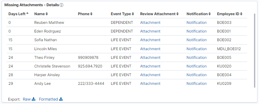

Missing Attachments – Details
This data-grid lists the documents missing data in tabular format along with employee details. Click the Notification link to send notification message to the selected employee. Select the Attachment hyperlink to view the Review Benefits Attachment page for the employee.
This example illustrates the fields and controls on the Missing Attachments – Details visualization.
Count for Life Event documents needing approval
This count visualization displays the count of employees with active life events for which document upload and approval is required, and the documents are uploaded but approval is pending.
This example illustrates the fields and controls on the Count for Life Event documents needing approval visualization.
Pending Approvals
This compound bar chart visualization displays the breakdown of pending document approvals distributed by employees and days to expiration. Click on compound bars to filter pending approvals by life events and dependent updates. The first bar with zero days indicates the employees with expired life events.
This example illustrates the fields and controls on the Pending Approvals visualization.

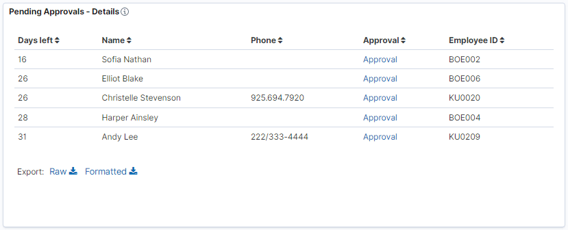

Pending Approvals – Details
This grid lists the employees with pending approvals in a tabular format. Click the Approval link to approve the documents for the selected employee.
This example illustrates the fields and controls on the Pending Approvals – Details visualization.

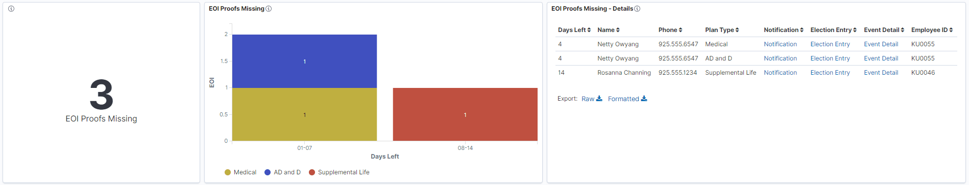

EOI Proofs Missing
This stacked vertical bar visualization displays the breakdown of missing EOI proof distributed by employees and days to expiration. The first bar with zero days indicates the employees with expired life events. Click on the sub-bars to filter by benefit plan type.
This example illustrates the fields and controls on the EOI Proofs Missing visualization.

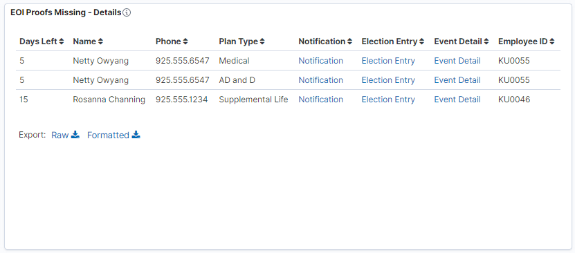

EOI Proofs Missing – Details
This grid lists the employees with missing EOI proofs in a tabular format.
This example illustrates the fields and controls on the EOI Proofs Missing – Details visualization.
Click on the hyperlinks to view the specific pages for the selected employee:
  • Notification: Notify the employee.
  • Election Entry: View On-Demand Event Process page and specify election requirements.
  • Event Detail: View Employee Event Detail page.

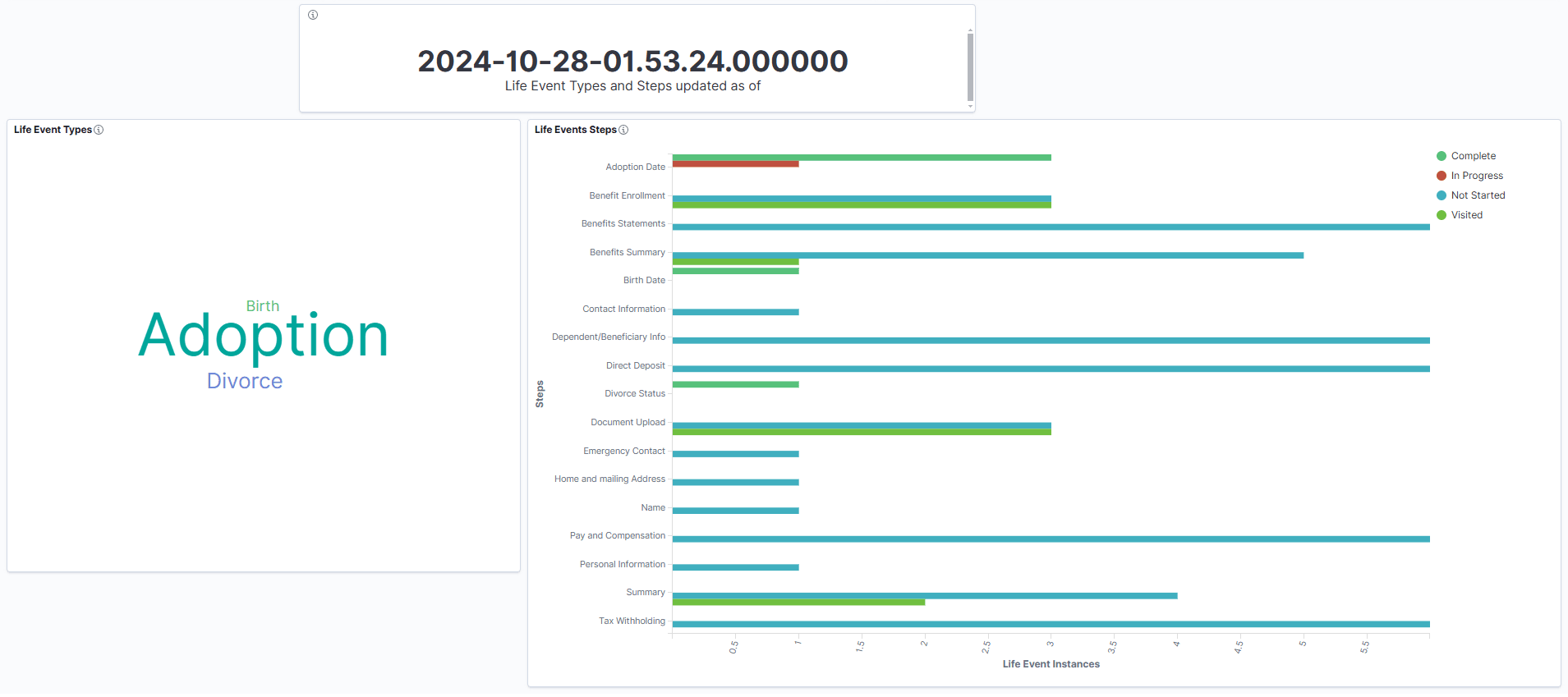

Life Event Types
This tag cloud visualization displays the life event types. Larger the font size, higher the number of that life event type. These tag clouds help administrators to easily filter the dashboard by a life event type.
This example illustrates the fields and controls on the Life Event Types visualization.

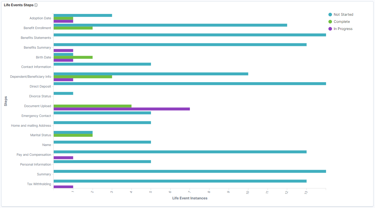

Life Events Steps
This horizontal compound bar chart displays the breakdown of the steps in the life event activity guide process and count of life event instances. Click on the compound bars to filter by life event status for a step. Life event status includes Not Started, In Progress, and Complete.
This example illustrates the fields and controls on the Life Events Steps visualization.
