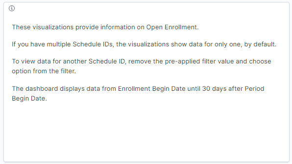

Description Box
The Description box provides instructional text that enables you to understand how the data is populated in the dashboard.

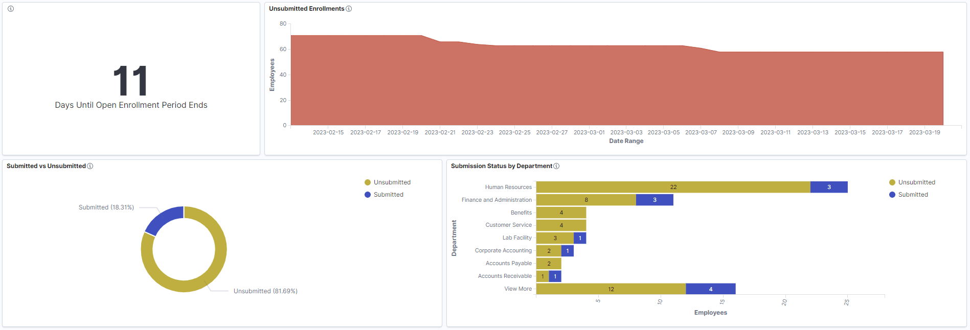

This example illustrates the fields and controls on the Description box.
Description box

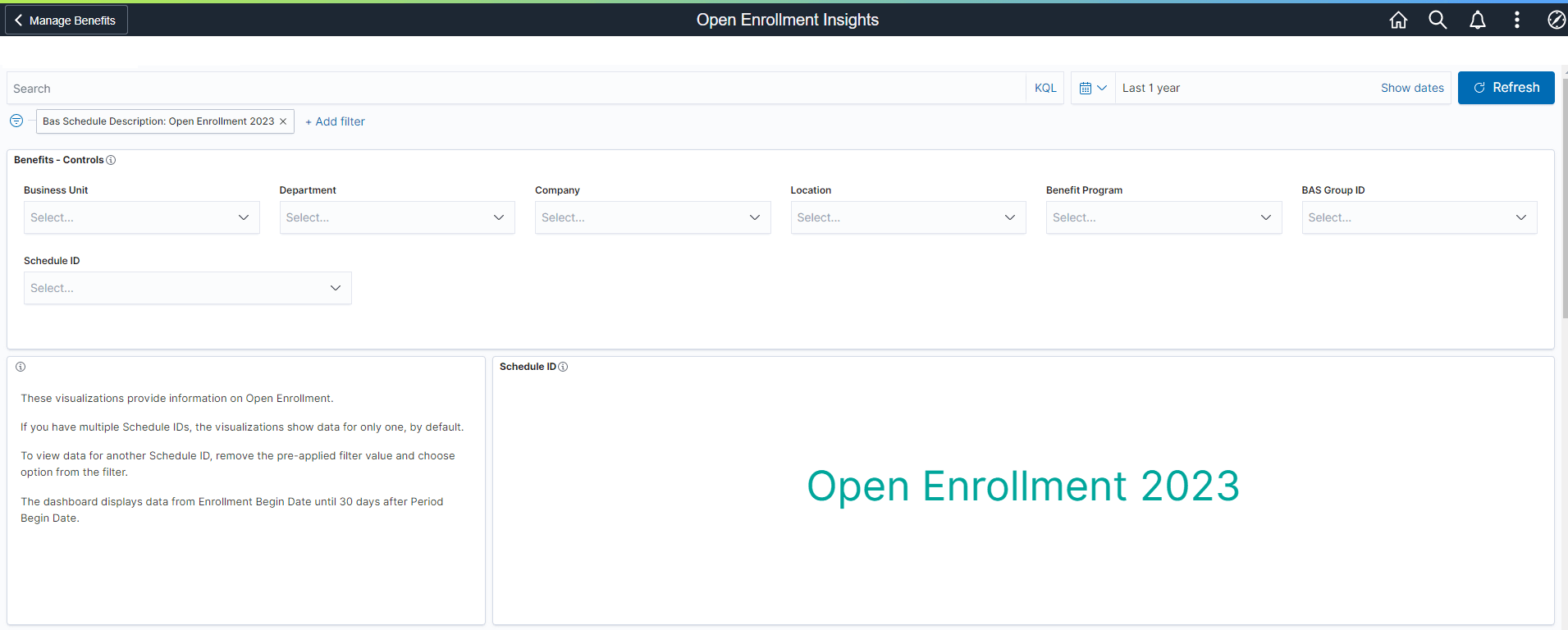

Schedule ID
This tag cloud visualization displays the Schedules ID for which data is displayed in the dashboard. The dashboard displays the Schedule ID with the closest end date by default. If two Schedule IDs have the same closest end date, then alphabetic order is followed.
To view the data for another schedule ID, close the pre-applied filter (default Schedule ID) displayed above the Benefits – Controls section and select the required Schedule ID from the Schedule ID filter. The Schedule ID is available only if the current date is within the Enrollment Begin Date and up to 30 days after the Period Begin Date.
This example illustrates the fields and controls on the Schedule ID visualization.
Days Until Open Enrollment Period Ends
This visualization displays the number of days remaining in the Open Enrollment period. If the current date is past the Enrollment End Date, then this visualization displays zero.
This example illustrates the fields and controls on the Open Enrollment Period Ends visualization.
Days Until Open Enrollment Period Ends visualization
Unsubmitted Enrollments
This area chart visualization displays the employee count by unsubmitted enrollments for date ranging from the Enrollment Begin Date to the current date. Data is available only if the current date is within the Enrollment Begin Date and up to 30 days after the Period Begin Date.
This visualization displays data for the open enrollments with Open status and Prepared or Notified as the process status.
To know more on how to define the date parameters for the open enrollment, see Open Enrollment Definition Page.
This example illustrates the fields and controls on the Unsubmitted Enrollments visualization.
Submitted vs Unsubmitted
This donut visualization displays the breakdown of enrollments by submission status.
For submitted events, the visualization displays data for the following process status: Entered, Finalized-Enrolled, Election Error, Re-enter. For unsubmitted events, the visualization displays data for process status that is Prepared or Notified.
This example illustrates the fields and controls on the Submitted vs Unsubmitted visualization.

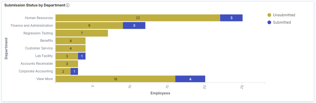

Submission Status by Department
This horizontal compound bar chart visualization shows the number of employees with submitted and unsubmitted enrollment status in each department. Select the compound bars to filter by the enrollment status.
This example illustrates the fields and controls on the Submission Status by Department visualization.

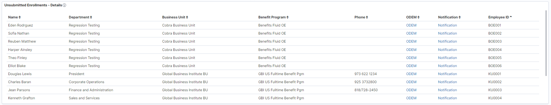

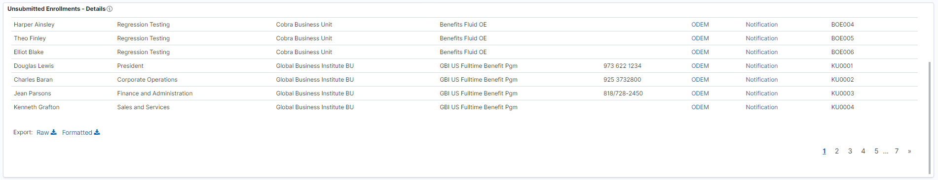

Unsubmitted Enrollments Details
This data-grid lists the unsubmitted enrollments in a tabular format along with employee details.
Select the hyperlinks to open the specific pages for the selected employee:
  • ODEM: View the On-Demand Event Process page.
  • Notification: Notify the employee.
This example illustrates the fields and controls on the Unsubmitted Enrollments by employee.
Unsubmitted Enrollments – Details visualization

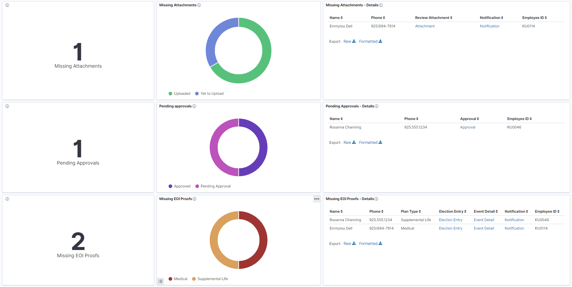

Missing Attachments Count
This count visualization displays the count of employees with open enrollment who have dependent updates for which document upload is pending.
This example illustrates the fields and controls on the Missing Attachments Count visualization.
Missing Attachments
This donut visualization displays the breakdown of enrollments by missing attachments and already uploaded.
This example illustrates the fields and controls on the Missing Attachments visualization.
Missing Attachments Details
This data-grid lists the employees with missing attachments in a tabular format. Select the Attachment hyperlink to view the Review Benefits Attachment page for the employee. Select the Notification link to send notification message to the selected employee.
This example illustrates the fields and controls on the Missing Attachments – Details visualization.
Missing Attachments Details visualization
Pending Approvals Count
This count visualization displays the count of employees with dependent updates for the open enrollment for which document upload and approval is required, and the documents are uploaded but approval is pending.
This example illustrates the fields and controls on the Count for Open Enrollment documents needing approval visualization.
Pending Approvals Count visualization
Pending Approvals
This donut visualization displays the breakdown of enrollments by pending approvals and documents approved.
This example illustrates the fields and controls on the Pending Approvals visualization.
Pending Approvals Details
This data-grid lists the employees with pending approvals in a tabular format. Select the Approval link to go to the PeopleSoft Human Resources Manage Base Benefits: Pending Approvals - Dependent Updates PagePending Approvals page to approve or deny the documents for the selected employee.
This example illustrates the fields and controls on the Pending Approvals – Details visualization.
Pending Approvals Details visualization
Missing EOI Proofs Count
This count visualization displays the count of employees whose open enrollment changes are pending due to missing Evidence of Insurability (EOI) proof. If an employee has more than one pending EOI, then the data shows up for each plan type.
This example illustrates the fields and controls on the Missing EOI Proofs Count visualization.
Missing EOI Proofs
This donut visualization displays the breakdown of missing EOI proofs by employees and plan types. Select the sub-section to filter by plan type.
This example illustrates the fields and controls on the Missing EOI Proofs visualization by plan types.
Missing EOI Proofs Details
This grid lists the employees with missing EOI proofs in a tabular format.
This example illustrates the fields and controls on the EOI Proofs missing – Count visualization.
Missing EOI Proofs Details visualization
  • Election Entry: View the On-Demand Event Process page and specify the election requirements.
  • Event Detail: View the Employee Event Detail page.

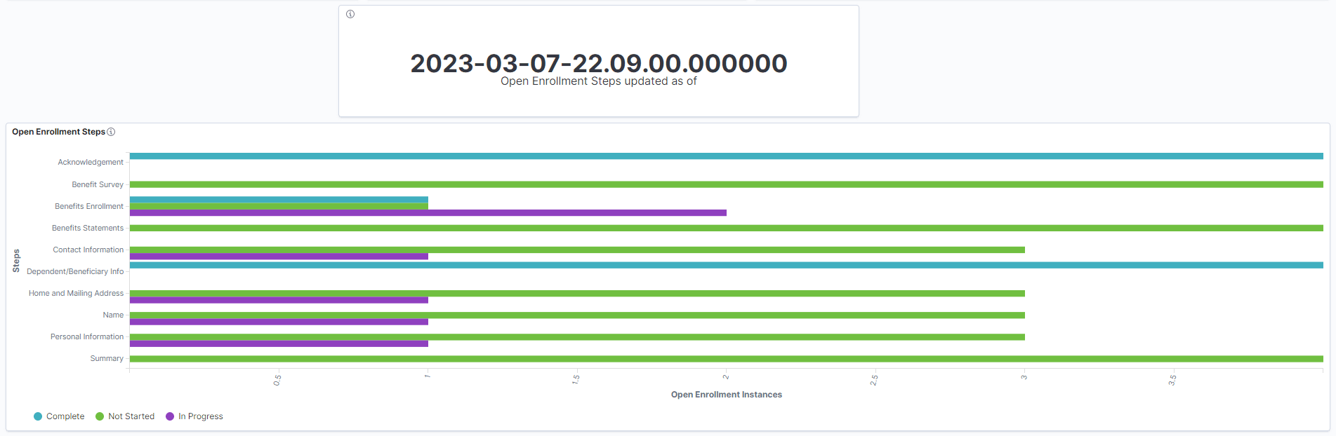

Open Enrollment Steps updated as of
This date time visualization displays the timestamp when the data for the Open Enrollment Steps visualization was last updated. The data for this visualization is populated based on the HC_BEN_OE_AG index run.
This example illustrates the fields and controls on the Open Enrollment Steps updated as of visualization.
Open Enrollment Steps updated visualization
This horizontal compound bar chart displays the breakdown of the steps in the open enrollment activity guide process and count of open enrollment instances. Select the compound bars to filter by open enrollment status for each step. The open enrollment step status includes Not Started, In Progress, and Complete. This visualization includes all the active open enrollment instances.
This visualization is not RTI enabled. To view the latest data, the benefits administrator must run the HC_BEN_OE_AG index. The Open Enrollment Steps updated as of visualization displays the timestamp when the data for Open Enrollment Steps visualization was last updated.
This example illustrates the fields and controls on the Open Enrollment Steps visualization.
