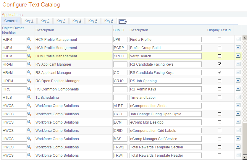

Use the General tab on the Configure Text Catalog page (HR_SSTEXT_CFG) to control whether Candidate Gateway pages display context-sensitive text or Text Catalog IDs.
Navigation:
Set Up HCM, and then Common Definitions, and then Text Catalog and Notepad, and then Configure Text Catalog, and then Configure Text Catalog
This example illustrates the Configure Text Catalog page: General tab.
Field or Control Description
Display Text ID
To make Candidate Gateway pages display the text IDs for all Text Catalog objects, locate the row for the Object Owner Identifier HRAM and select the Display Text ID check box.

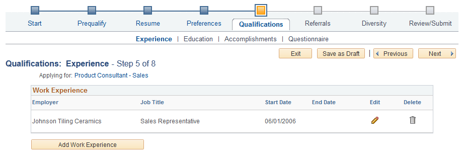

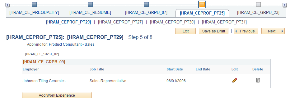

The following images illustrate the effect of the Display Text ID check box.
This illustration shows a step in the Classic Candidate Gateway guided application process as it normally appears to applicants:
Candidate Gateway application step in regular display mode
This illustration shows the same step as it appears when the Display Text ID check box is selected for the HRAM object owner. In this mode, the page displays text IDs rather than text for the page elements that are controlled by the Text Catalog. Notice that there is an extra text catalog entry, HRAM_CE_SINST_02, above the Work Experience grid. You can use this to provide additional instructional text related to the grid. If the text catalog entry does not have any text, nothing appears on the page. Similar text catalog entries exist for other grids on the job application pages.
Candidate Gateway application step in Text ID display mode

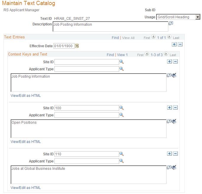

Use the Maintain Text Catalog page (HR_SSTEXT_TEXT) to define text catalog entries and to define the values for context-sensitive keys.
Navigation:
Set Up HCM, and then Common Definitions, and then Text Catalog and Notepad, and then Maintain Text Catalog
This example illustrates a text catalog entry where different text is associated with different context keys.

Context Keys and Text
Site ID and Applicant Type
Site ID and Applicant Type are the pre-defined context keys for Candidate Gateway.
Each text ID and effective date combination needs a default value where both the Site ID and Applicant Type fields are blank. The system uses this entry when context-specific text does not exist.
For example, if you have five sites, and four of them use the same set of terms & agreements while one uses a different set of terms & agreements, then you would create one site-specific entry for the unique site, but you would not need to create entries for the other four sites, which all use the default text.
<Text Box>
Although the text catalog framework allows long text entries, the page element where the text appears at runtime can have a lower character limit, resulting in truncated text. Any time you change a delivered text catalog entry, be sure to test your change. If the entry is truncated, you must shorten your text.
